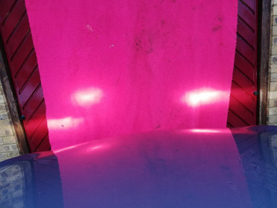

This is tricky to explain. The offside headlight seems ok.
A few weeks back I parked my car about 1 metre up to the garage door and adusted the nearside headlight until the ajustment couldn't turn any more. The beam was still pointing lower but the high beam now points right up into the trees!
I know the dipped beam needs to be a bit like (1) in the attached picture.
On the motorway I can just see my car's shadow in front, that's how poor the lights are. When a car is passing me by, their headlights shine much futher up the road than mine.
And cars with LED lights... Well I really do see the silhouette of the C5 in front of me.

So the first thing to do is check the bulbs are fitted the correct way as has been well covered now - then get the alignment one properly. If you are not happy with the quality of the light throw or range - it is also a possibility that the bulbs may have been replaced with cheap or fake bulbs by the previous owner. Even Amazon and places like that are flooded with fakes.
So you might want to consider replacing the bulbs with a proper set from an authorised reseller (not ebay or Amazon) and compare the difference - or consider a legit premium upgraded bulb that can provide a brighter light and a longer throw - at the expense of longevity.

I would (very carefully) look at the 'good' headlight to see which way up it is (and to see where the flat side is). Then check that the 'bad' headlight is correctly fitted. If it is not it will be off centre in the reflector area, so that the filament will not be in the focal point of the reflector.
I did not know the X7 doesn't have H4 bulbs, so obviously they are not relevant. The reason I mentioned them is because one of the twin filaments has a reflector deflecting the beam out of the side of the bulb.
You might want to have a look at Lidl. They are doing headlight bulbs at £5 a pair. I have used them for years now, and I have found them to be reliable. The choice is either Xenon Effect, 100% Extra Brightness, or Long Life;

Sounds like the sensible thing to do Adam - ensuring proper bulbs, correct fitting and get the lamps adjusted.
(10) is an H1 (Main Beam)
(11) are H7s and there is one for the dipped beam, and the second one is for the bend lighting.
