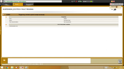

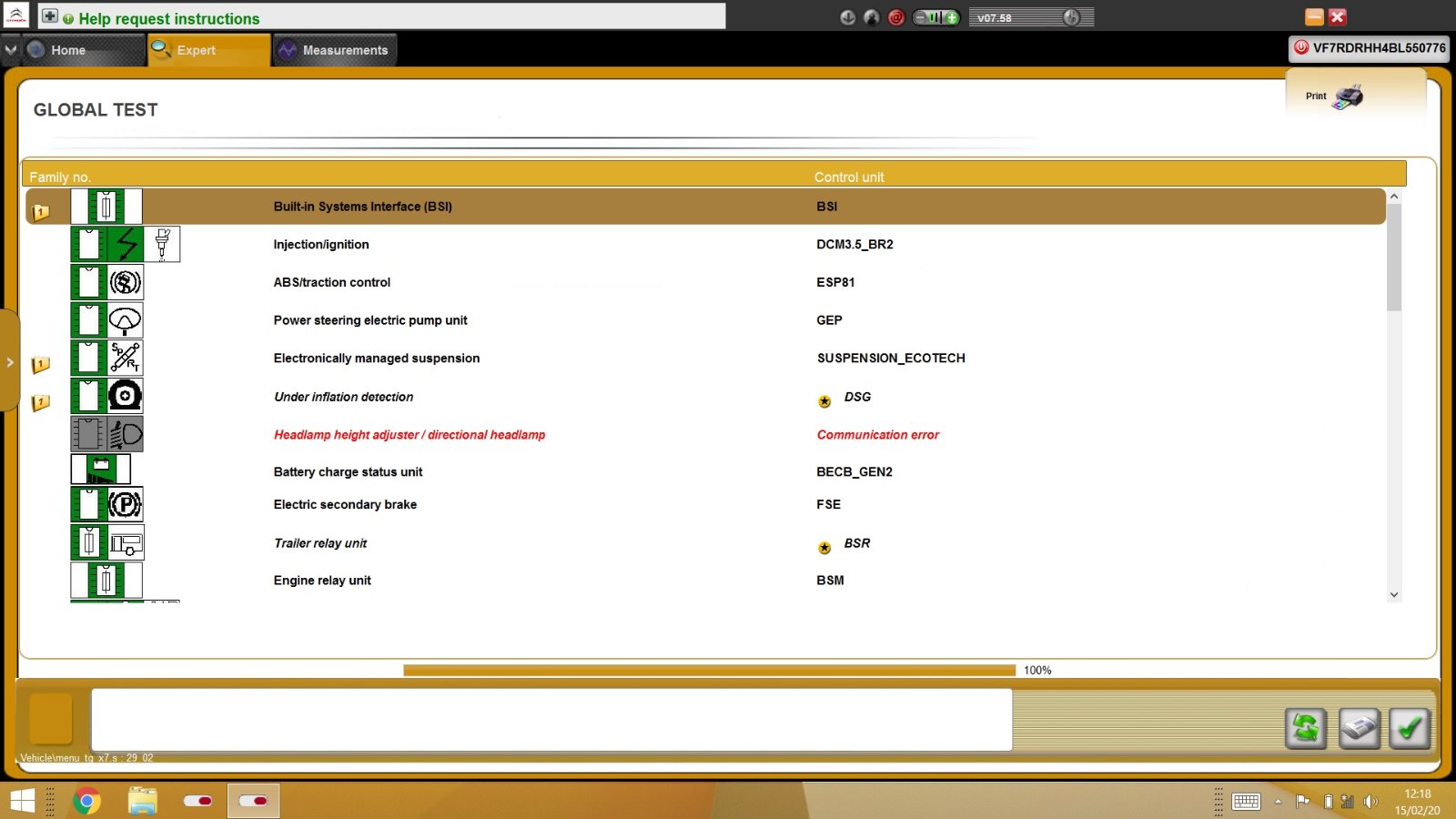

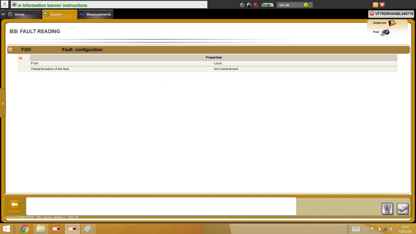

I cannot manually adjust the vertical adjustment any further. The near-side dipped headlight is still pointing so low that the end of the beam-end is only two metres away from the car.
Diagbox cannot interact at all the the headlights.
My car is a Citroen C5 X7 2.0 HDI 165 PS Executive
I have attached all the codes from Diagbox.
Adam.

Ok, so this is an easy one for a change. Basically you can ignore almost all of the above.
The speed faults are perfectly normal - it is as a result of the diagnostic equipment interrogating the ESP ECU - this causes the speed fault codes and can be ignored and ditto with the suspension - as this is related to the ESP fault just described.

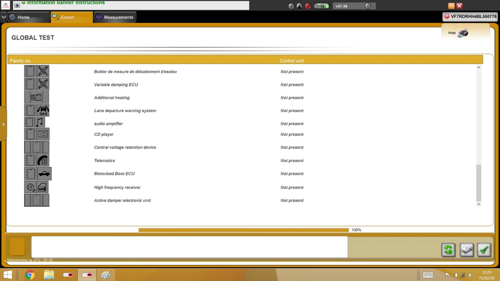

All those grey areas on the global test are perfectly fine - they are for options you do not have fitted.
The one fault you do have is on the rear parking sensors - specifically the rear left hand side, second one in from the left. That is faulty according to the diagnostics. This will prevent the whole system from operating when there is a sensor fault.
As for the Headlamp. There is nothing for Diagbox to interact with - you do not have Bi-Directional Xenon Discharge Headlamps - just the standard Halogen ones, so there is no ECU to interact with.
If you have manually adjusted the headlamp beam, I think you have overdone it. If you have manually changed a headlamp bulb recently, then this is the likely suspect if it has not been seated correctly.
In any case, what you need to do is get it down to ATS (that do MOTs) or somewhere decent that has a beam setting adjustment tool and get them to readjust it back to how it should be. You'll never get it right manually, and shouldn't adjust these yourself without the correct kit as it has the potential to blind oncoming drivers and cause an accident at night. Just make sure the headlamp bulb is seated correctly first and they should be able to adjust them for you for a few quid.

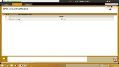

Lastly, your F303 fault is related to an incorrect configuration of the Independent Telematic Unit.
Have you attempted to (accidentally or deliberately) change anything? If so the configuration has been left in an incomplete state and the system is not now operational until resolved. This means you the emergency assistance system in an accident won't be able to make a call until this is resolved.

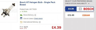

I'm off to eurocarparts in 10 for some Bosch Bulbs. Any idea as to why the Osram's are £12.49 as to the Bosch ones being £4.39???
Adam.

If the Osrams are "Nightbreakers" they are a higher output bulb.

OSRAM are a better quality of bulb and are fitted by the OEM in many cases.Adam82 wrote: 15 Feb 2020, 14:49 Hi Marc,
I thought this was going to be difficult at the start of the post.
Adam.
Get the best you can afford - but it is recommended these are replaced together - on opposite sides.
So if replacing the H7 dipped beam, get 2 and do the left and right lamp.
These are the latest OSRAM bulbs and will give you:
https://www.eurocarparts.com/p/osram-ni ... -48177022X
- Up to 150% more brightness compared to the minimum legal standard
- Up to 150m long beam
- Up to 20% whiter light compared to the minimum legal standard
- More light performance due to innovative laser ablation technology
