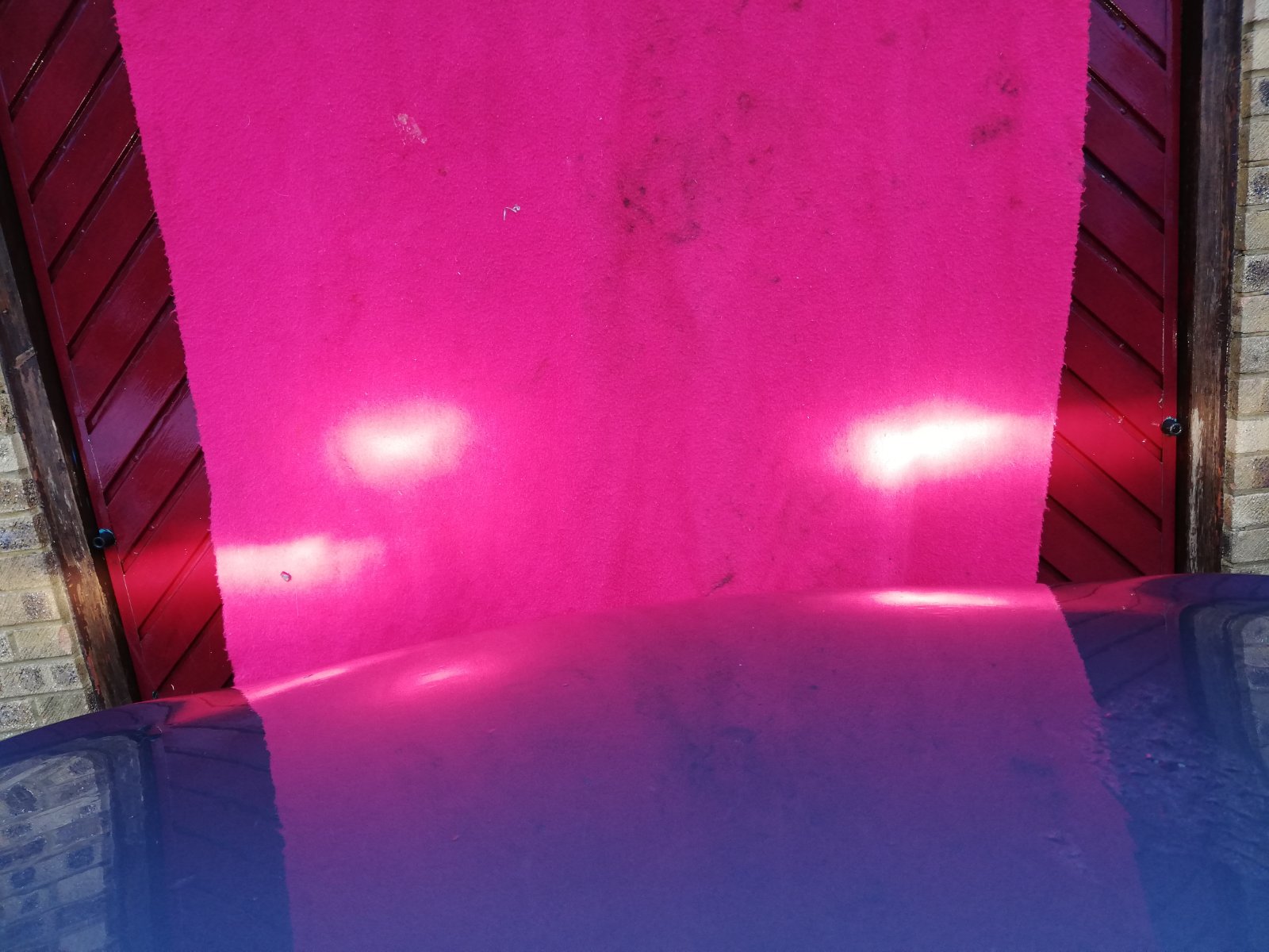

This is tricky to explain. The offside headlight seems ok.
A few weeks back I parked my car about 1 metre up to the garage door and adusted the nearside headlight until the ajustment couldn't turn any more. The beam was still pointing lower but the high beam now points right up into the trees!
I know the dipped beam needs to be a bit like (1) in the attached picture.
On the motorway I can just see my car's shadow in front, that's how poor the lights are. When a car is passing me by, their headlights shine much futher up the road than mine.
And cars with LED lights... Well I really do see the silhouette of the C5 in front of me.
Adam.
Adam.

So the first thing to do is check the bulbs are fitted the correct way as has been well covered now - then get the alignment one properly. If you are not happy with the quality of the light throw or range - it is also a possibility that the bulbs may have been replaced with cheap or fake bulbs by the previous owner. Even Amazon and places like that are flooded with fakes.
So you might want to consider replacing the bulbs with a proper set from an authorised reseller (not ebay or Amazon) and compare the difference - or consider a legit premium upgraded bulb that can provide a brighter light and a longer throw - at the expense of longevity.

I would (very carefully) look at the 'good' headlight to see which way up it is (and to see where the flat side is). Then check that the 'bad' headlight is correctly fitted. If it is not it will be off centre in the reflector area, so that the filament will not be in the focal point of the reflector.

I have not fitted new bulbs. But I have just cheaked that they are seated fully and they look like H7's. I can't see any branding on both bulbs though...
I'll get some new bulbs and book the car in at an MOT station later this week.
