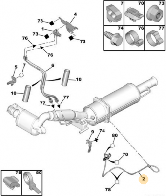

I have a 2007 407 2.0 HDI coupe, fault code p2033 displayed. Can you confirm part No for my EGT sensor is 1618PG/ SH/ 30. And are there any less expensive variants I can use.

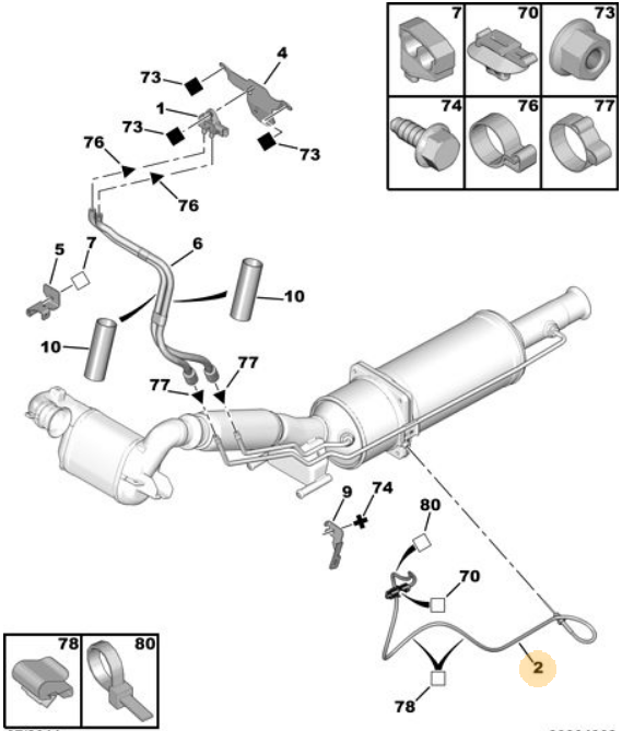

Re: Peugeot 407 EGT Sensor
Confirmed, the newer replacement part is 1618PG (item 2 below). Currently priced at £146.30 inc. VAT from Peugeot.
Torque: 3.0 ± 0.5 daNm
Be wary of non OEM replacements - I suspect the replacement part may have a slightly longer cable, due to the earlier model getting too close to the heat from the exhaust and causing damage to the wiring sheath, leading to electrical shorts / damage. The newer replacement part may have a longer cable, in order that it can be secured further away from the exhaust.
