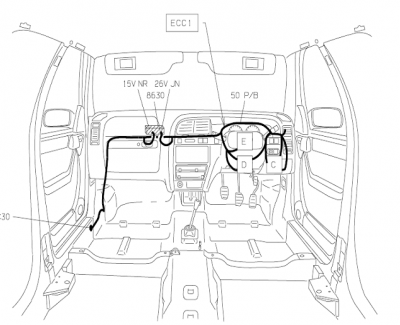

Would I be right in saying the 8630 is somewhere behind the glovebox in the passenger footwell?
Also, should I get a voltage reading from Pins, 5, 6 and 19 if the key has correctly communicated its code to the transponder?
In the Diagnostics manual for Coded Anti-Theft IIRC, you can have a fault where the transponder light goes out on the dash but the car will still not start.
On that note, I'm going to get up there and see if I can get it started this week. Wish me luck please!
Re: Need help with wiring diagrams Xantia 2.0HDi - Non Starter please!
8630 is the CPH and is located behind the glovebox.
Pin 5 is ignition switched live. The other wires may be communication wires & may not have a definite live, they may be pulses.

Here's the location of the Central Protection Unit:
8220 is the analogue Transponder Unit
I'm not sure what that is of - the CPU has multiple connections to the Alarm system (if fitted) and the Central Locking as well as the Immobiliser, so if that is the CPU in one of the pictures, how many socket connections does it have? Sometimes there may be more than one connector fitted into one large socket.
If it is the CPU ECU (picture on the left) then that is obviously longer than a 27 pin connector, so likely does have one or more separate connections form the immobiliser, the Alarm and the Central locking as I mentioned.
It’s the 89 pin main Bosch EDC15C2 ECU.
I’m not sure if you refer to that as CPU ECU?
It’s not the Body CPH one.
