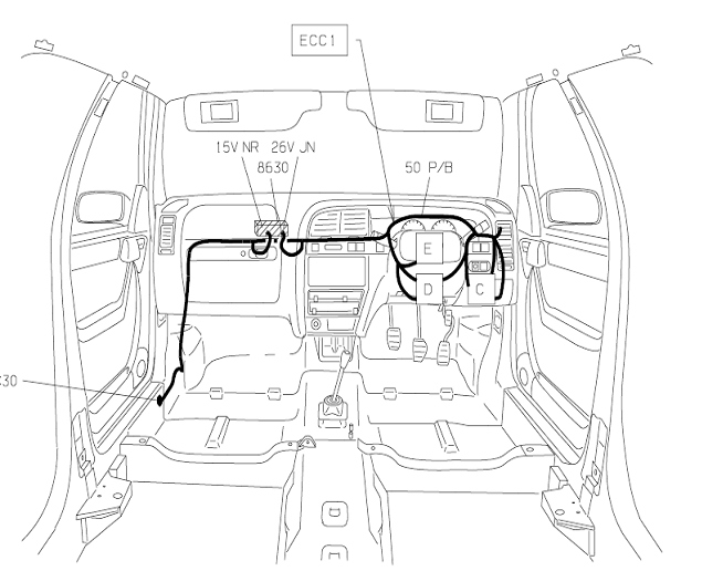

Would I be right in saying the 8630 is somewhere behind the glovebox in the passenger footwell?
Also, should I get a voltage reading from Pins, 5, 6 and 19 if the key has correctly communicated its code to the transponder?
In the Diagnostics manual for Coded Anti-Theft IIRC, you can have a fault where the transponder light goes out on the dash but the car will still not start.
On that note, I'm going to get up there and see if I can get it started this week. Wish me luck please!

8630 is the CPH and is located behind the glovebox.
Pin 5 is ignition switched live. The other wires may be communication wires & may not have a definite live, they may be pulses.

Here's the location of the Central Protection Unit:
8220 is the analogue Transponder Unit

It’s the ECU.

If it is the CPU ECU (picture on the left) then that is obviously longer than a 27 pin connector, so likely does have one or more separate connections form the immobiliser, the Alarm and the Central locking as I mentioned.

It’s the 89 pin main Bosch EDC15C2 ECU.
I’m not sure if you refer to that as CPU ECU?
It’s not the Body CPH one.
