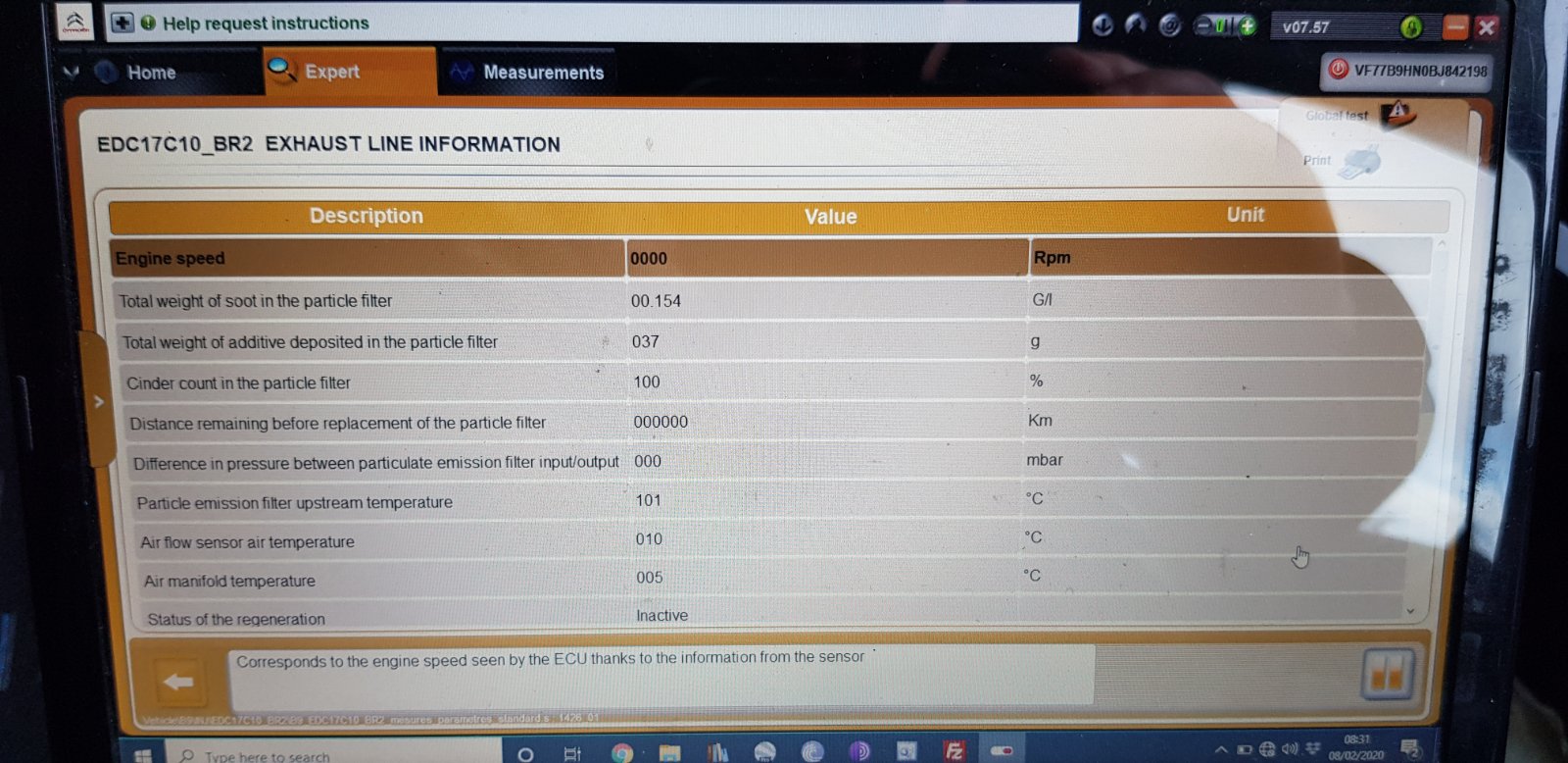

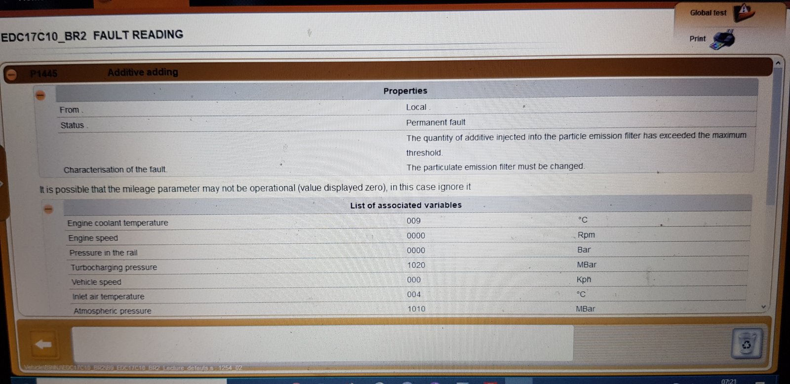

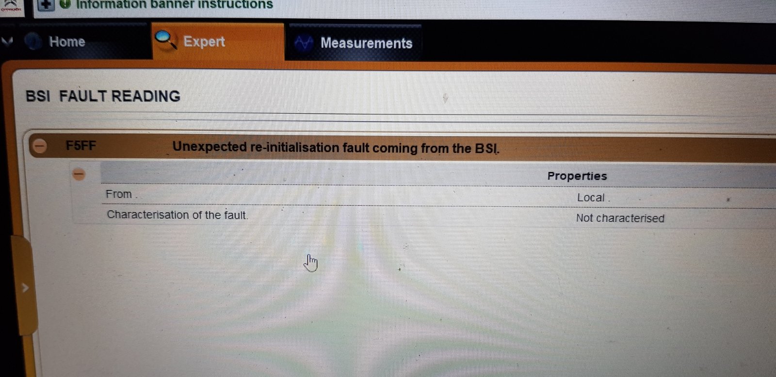

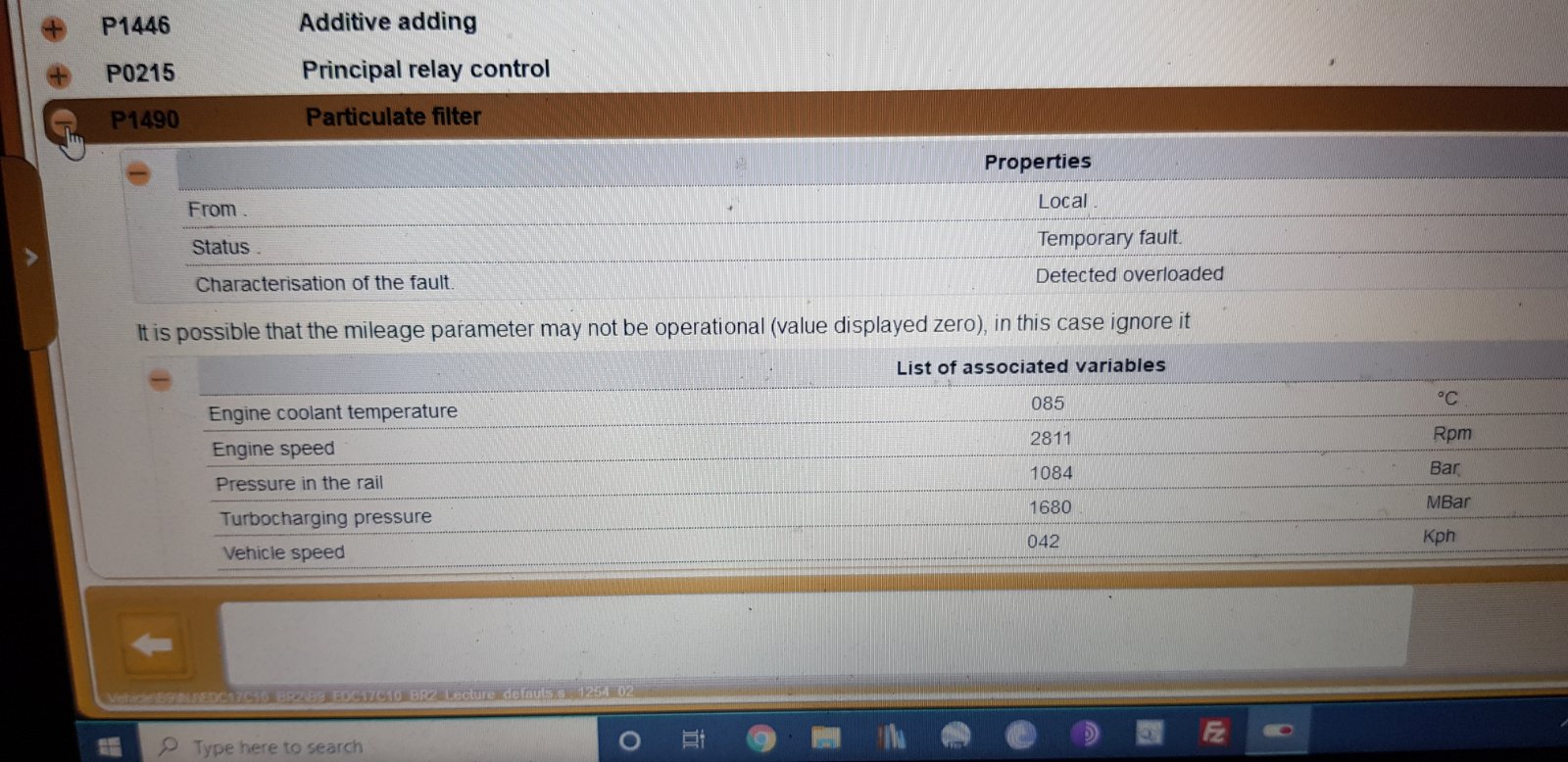

This morning I've been out and spent some time finding my way around Diagbox.
I've had it a long time but I've never had to use it in anger until now.
It seems either I wasn't doing the global test in the right place or the software wasn't picking up the faults in all the screens where it should.
I have found some faults. I've cleared them but one popped straight back up and is a permanent one.
It's pointing to the DPF being full. I have read that if the pressure differential is ok then you can tell it you've fitted a new filter and it will be ok.
I've measured the pressure differential and it's 0 with the engine off, 7 at idle and 50 at 3k revs stationary.
I've no idea if those values are acceptable or not.

Ok, now we have the fault codes - I think you were interrupting the diagnostic instead of letting it finish, which is why they were not presenting previously.
Codes:
P15B3: Additive adding: Additive level calculated lower than the minimum threshold, the engine management ECU indicates that the additive minimum level has been reached. This is when you get the message: "risk of clogging of the particle filter".
Suspect Areas: Particle filter additive reservoir and / or Particle filter additive
P1446: Additive adding: Calculated additive level below the critical threshold. The engine ECU indicates that the critical additive level has been reached.
Down grade Modes: Deactivation of the additive pump and also deactivation of the request for regeneration of the particle filter from the diagnostic tool.
P1490: Particle filter: Detected overloaded. There are 3 possibilities:
P1445: Additive adding: The quantity of additive injected into the particulate emission filter has exceeded the maximum threshold - the particulate emission filter must be changed. The volume free in the particle filter is not sufficiently large. It is necessary to replace the particle filter at the next service interval.
Suspect Areas: The Particle emission filter at the end of its service life.
Here is the dilemma:
Your particle filter (from the "cinder count in the particle filter") is now reading 100% - in other words the filter is now totally blocked!
No amount of regeneration will fix this; once it has reached anywhere 75% or above, it will have to be removed to be cleaned. Even an 'in-situ' clean will not likely be able to remove this level of clogging.
The second issue is, that because you have the system reporting there is both insufficient additive and also that the additive is below the minimum threshold, forced regeneration by using Diagbox has been disabled - in other words it will not allow a forced regeneration to take place for safety reasons and as it will damage the engine components (back pressure will be too high when filter is fully blocked).
So this is where you are at, and the quandary is that you may not be able to reset the additive level - because the particle filter is totally blocked and 'end of service life' as reported by code P1445. In addition, the additive pump has been switched off - because of the problems it has detected with the quantity of additive it thinks is in the tank, so is not injecting additive into the tank.

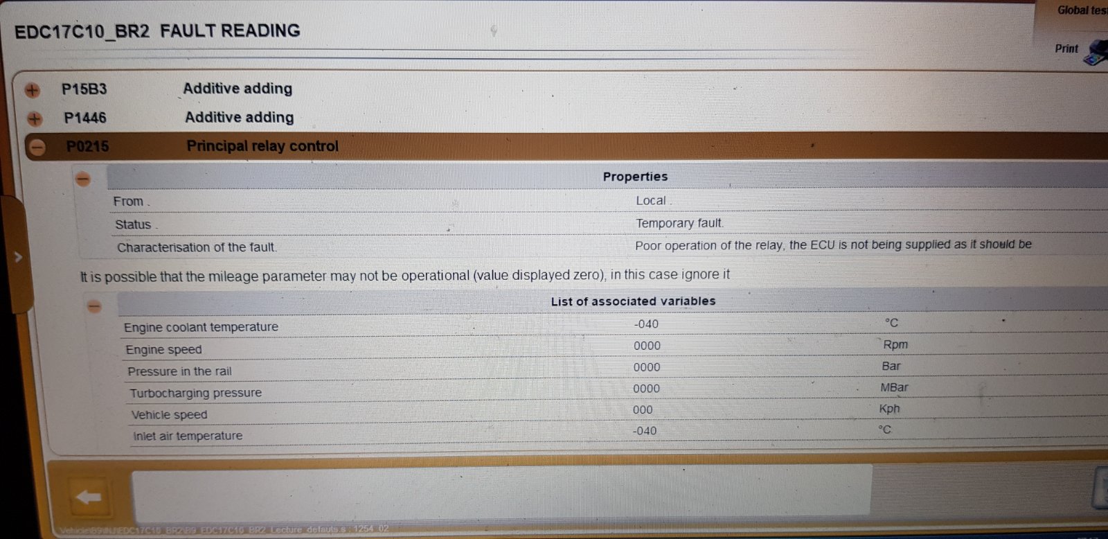

There was an Engine ECU fault P0215; Main relay control: Poor operation of the relay, the ECU is not being supplied as it should be - The engine management ECU is still supplied 1 seconds after the request to cut off its supply. Loss of supply of the engine ECU for 1 s without a prior request being detected, due to an incorrect value memorised at the following wake-up. This fault can disappear after driving for 5 minutes.
Suspect areas: Main relay, Electrical harness, Connectors
I'm not sure what impact that will have on the other issues if any though.

Update:
I took the van to citroen this morning unfortunatley the possible filter blockage light came on with the engine light flashing.
After 7 hours they said they cant they cant reset it.
They advised me to leave the van with them and get the particle filter changed at a price of around €2000.
I said tell the computer that its been changed as i changed the liquid additive bag and know its okay and i will take the risk.
After trying they said they have managed to reset the low additive warning but not the possible filter blockage and advised me not to drive it and to let them change it.
I said no and took the vehicle.
I started the engine, there is no low additive warning message but the posible filter warning came up with the engine light flashing.
After driving it a couple of minutes the light went out, i have driven it for about another 20 mins onfast roads and it hasnt come back on?
Do you think the reset worked and just needed a drive?
Thanks for reading.
