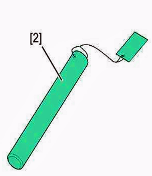

Recommended Tooling
| [1] flywheel locking tool 4507-TA. | [2] camshaft setting rod 4507-T.B |
| [3a] 4533-T.AC1 camshaft setting rod. | [3b] 4533-T.AC2 camshaft setting rod. |
| [4] pliers for removing plastic pegs 7504-T. | [5] set of levers for releasing the cylinder head 149-T. |
| [6] angle sector to tighten the cylinder head 4069-T. | [7] liner retaining clamp 81132-T.A1. [8] bolts M10x150 L 40 mm 81132-T.A2. |
| [9] TORX female socket STX 14. | [10] union for venting fuel pressure 4192-T. |
