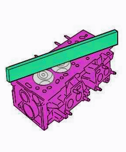

Checking the flatness

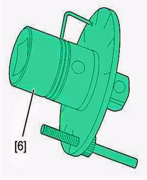

| [6] angle sector to tighten the cylinder head 4069-T. | [7] liner retaining clamp 81132-T.A1. [8] bolts M10x150 L 40 mm 81132-T.A2. |

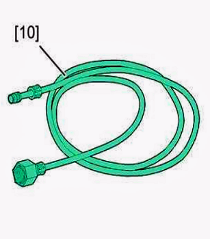

| [9] TORX female socket STX 14. | [10] union for venting fuel pressure 4192-T. |

Note: When connecting the tool [10], protect yourself
with a cloth to guard against any projections of fuel. - The wiper arm nut (10).
- Uncouple the fuel supply.

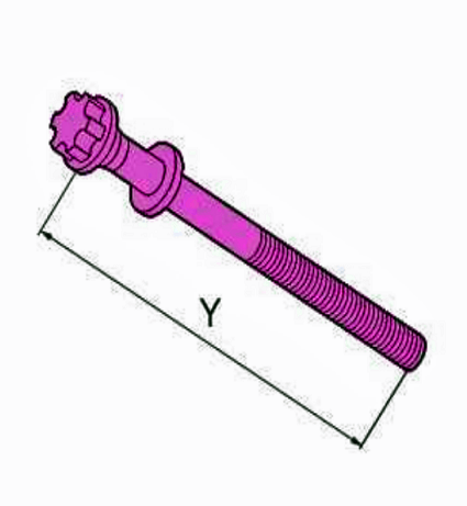

| Max. out-of-true: 0,05 mm (max.). | Checking cylinder head bolts before re-use: Length under head (torx thread): Y = 176,5 mm (TU3JP engine) N.B.: Do not re-use cylinder head bolts if they are longer than Y mm: Use new screws. |

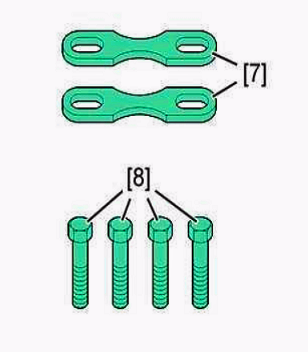

- The retaining clamps [7]
- The screws [8] of the cylinder block

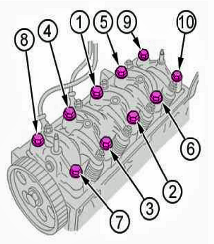

| ESSENTIAL: Tighten the bearing carrier screws in the order indicated (order from 1 to 10). |
Pre-tightening to 2 da.Nm
Tighten by an angle of 240 ° with tool [6]

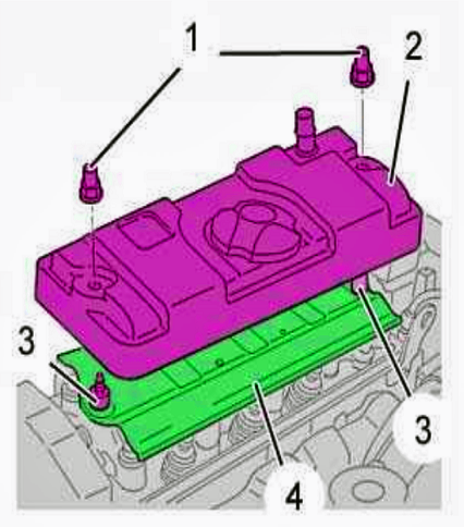

- The deflector plate (4)

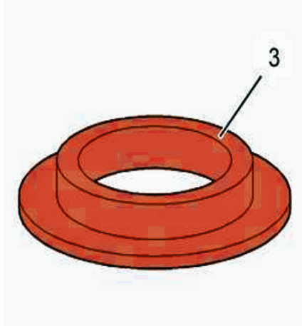

- The spacers (3)
- The cylinder head cover (2)
- The nuts (1)

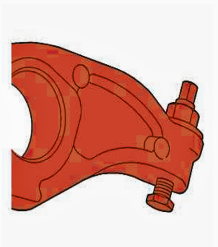

Valve rockers
From the following serial numbers:
- TU3 - 2 552 655
- To allow the valve clearance to be adjusted, the heads are flat and hexagonal
- The diameter of the screw is reduced (M6 replacing M9)
| Repair The new parts are fitted in place of the old parts. Tighten the nuts to 0,75 dan.m. The valve clearance remains the same. |

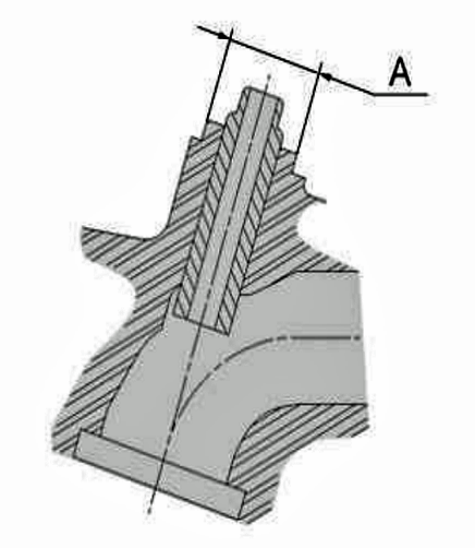

The machining diameter of the valve spring bearing surfaces is reduced.
| A = Ø 19,65 mm Always replace the ring seals 21,3. |
Cylinder heads machined to the new dimensions are identified by a line around the mounting hole for the lifting lug (at "b"):
