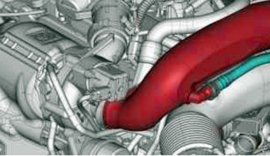

There are 2 sections - Leaks by Area (Zones A, B & C) or by known cases in the following table.
Leak Diagnostic by Known Cases
Leak Diagnostic by Area

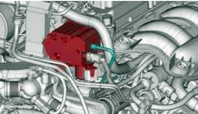

Zone C - Inlet Face
Inlet face - Injection system.
Stage C1: High pressure fuel supply pipe
Stage C2: Pressure sensor on the fuel high-pressure injection rail
Stage C3: Fuel injectors on the fuel high pressure common injection rail
Stage C4: Plug on fuel high pressure common injection rail
Inlet face: Fuel vapour recirculation circuit
Stage C5: Fuel vapour recirculation pipe on canister purge electrovalve
Stage C6: Fuel vapour resuction pipes on canister purge electrovalve
Stage C7: Fuel vapour hose on air inlet manifold

Zone B - Coupling Face
Stage B1: Canister pipe on air inlet
| Locating the Leak | Information |
Sealing:
Possible causes:
Repair: Replace the canister pipe on the induction |
Sealing:
Possible causes:
Repair: Replace the fuel vapours recirculation pipe |
| Sealing: Pipes force-fitted Probability: Low Possible causes: Incorrect fitting of the pipe Access: Average Repair: Replace the canister pipes |
Sealing:
Possible causes:
Repair: Replace the electrovalve |
