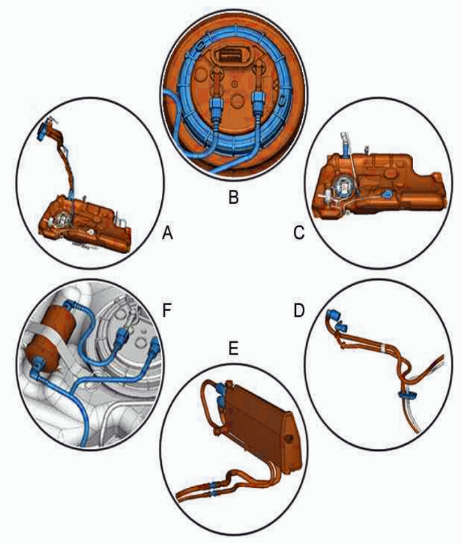

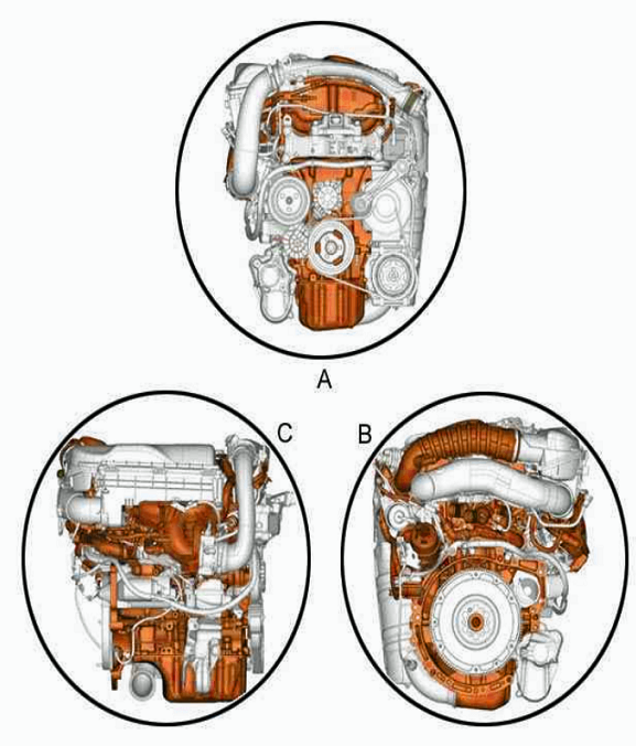

Here are the known areas of petrol leaks. If you can narrow it down to one of the zones I can get a bit more detail. If the smell is coming in more or less as soon as or shortly after the engine is started, then more likely to be a fuel leak and - obviously near the air intake.
ZoneDescription
Zone "A"Filling pipework assembly
Zone "B"Fuel gauge and pump assembly
Zone "C"Fuel tank
Zone "D"Pipework to engine
Zone "E"Canister absorber
Zone "F"Fuel filter

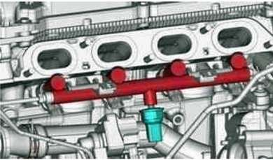

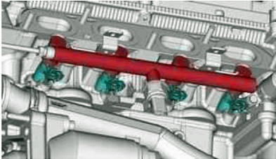

Funny that the official list does not include the high pressure fuel pump or fuel rail, which are the 2 (expensive) components that come up as culprits for the same engine in a Mini.
I will look again at the HPFP. I hope that it is not the fuel rail, this picture shows the fuel rail from above after the manifold has been removed for access.

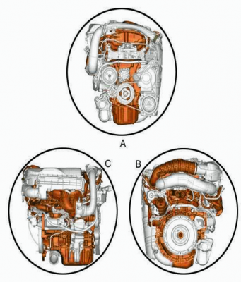

Sorry - I had to go and have just got back after a long afternoon - there is another one for the Engine Circuit - let me know the zone of interest:
[b]Zone[/b]
Description
Zone "A"Timing face
Zone "B"Coupling face
Zone "C"Inlet face

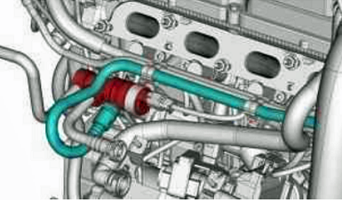

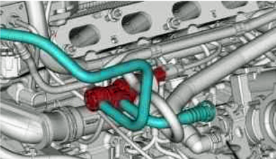

There are 2 sections - Leaks by Area (Zones A, B & C) or by known cases in the following table.
Leak Diagnostic by Known Cases
ProbabilityLocating the leakZone
LowFuel supply pipe on high pressure fuel pumpCoupling face - Stage B2
LowHigh pressure fuel supply pipeInlet face - Stage C1
LowPressure sensor on the fuel high-pressure injection railInlet face - Stage C2
LowFuel injectors on the fuel high pressure common injection railInlet face - Stage C3
LowPlug on fuel high pressure common injection railInlet face - Stage C4
Leak Diagnostic by Area

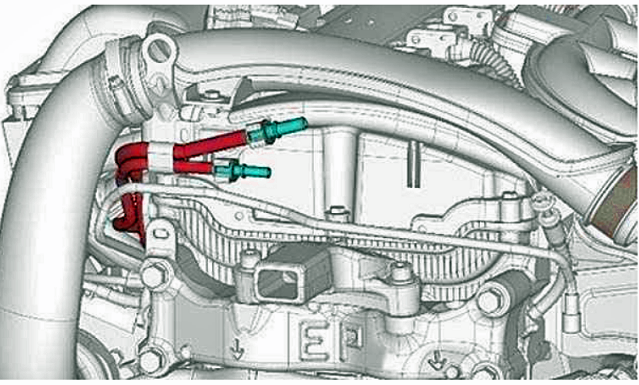

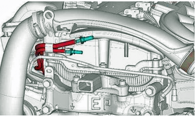

Zone A - Timing Face
A1: Fuel Connection Towards Adaptor
Locating the LeakInformation
Sealing: Hoses force-crimped on click-fit unions
Probability: Low
Possible causes:
  • Incorrect crimping of the hoses
  • Damage to the click-fit unions
Access: Easy
Repair: Replace the fuel pipes
Zone B - Coupling Face
Stage B1: Canister pipe on air inlet
Sealing:
  • 2 O-ring seals
  • Pipe force-crimped on click-fit union
Probability: Low
Possible causes:
  • Incorrect positioning of the fastener
  • Seals sealing fault
  • Absence of seal
  • Incorrect crimping of the pipe
Access: Average
Repair: Replace the canister pipe on the induction
Stage B2: Fuel supply pipe on high pressure fuel pump
Sealing:
  • 2 O-ring seals
  • Hose force-crimped on click-fit union
Probability: Low
Possible causes:
  • Absence of seal
Access: Average
Repair: Replace the damaged low pressure fuel piping
Stage B3: High pressure fuel pipe on fuel pump
Sealing: High pressure pipe distorted against the cone on the pump
Probability: Low
Possible causes: Incorrect tightening of the nut
Access: Average
Repair: Replace the high pressure pipe

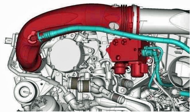

Zone C - Inlet Face
Inlet face - Injection system.
Stage C1: High pressure fuel supply pipe
Sealing: High pressure pipe distorted against the cone on the rail
Probability: Low
Access: Average
Stage C2: Pressure sensor on the fuel high-pressure injection rail
Sealing: Cone shape of the sensor tight against the rail
Probability: Low
Possible causes:
  • Sensor incorrectly tightened
  • Fault with the contact surfaces
Access: Difficult
Repair: Replace the pressure sensor on the rail
Stage C3: Fuel injectors on the fuel high pressure common injection rail
Sealing:
  • Detachable O-ring seal
Probability: Low
Possible causes:
  • Gasket sealing fault
  • Absence of seal
Access: Difficult
Repair:
  • Replace the 3 seals and the injector clip
  • Check the tightening torque of the plug on the fuel high pressure common injection rail
Stage C4: Plug on fuel high pressure common injection rail
Sealing: Force-fitted plug
Probability: Low
Possible causes: Incorrect positioning of the plug
Access: Difficult
Repair:
  • Replace the plug on the fuel high pressure common injection rail

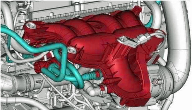

Inlet face: Fuel vapour recirculation circuit
Stage C5: Fuel vapour recirculation pipe on canister purge electrovalve
Sealing:
  • 2 O-ring seals
  • 1 Clip
Probability: Low
Possible causes:
  • Absence of seal
Access: Difficult
Repair: Replace the fuel vapours recirculation pipe

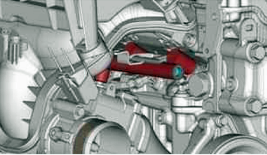

Stage C6: Fuel vapour resuction pipes on canister purge electrovalve
Sealing: Pipes force-fitted
Probability: Low
Possible causes: Incorrect fitting of the pipe
Access: Average
Repair: Replace the canister pipes

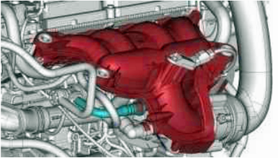

Stage C7: Fuel vapour hose on air inlet manifold
Sealing:
  • 2 O-rings in the click on union
Probability: Low
Possible causes:
  • Fault with the seals
  • Absence of seal
  • Incorrect fitting of the pipe
Access: Average
Repair: Replace the electrovalve
