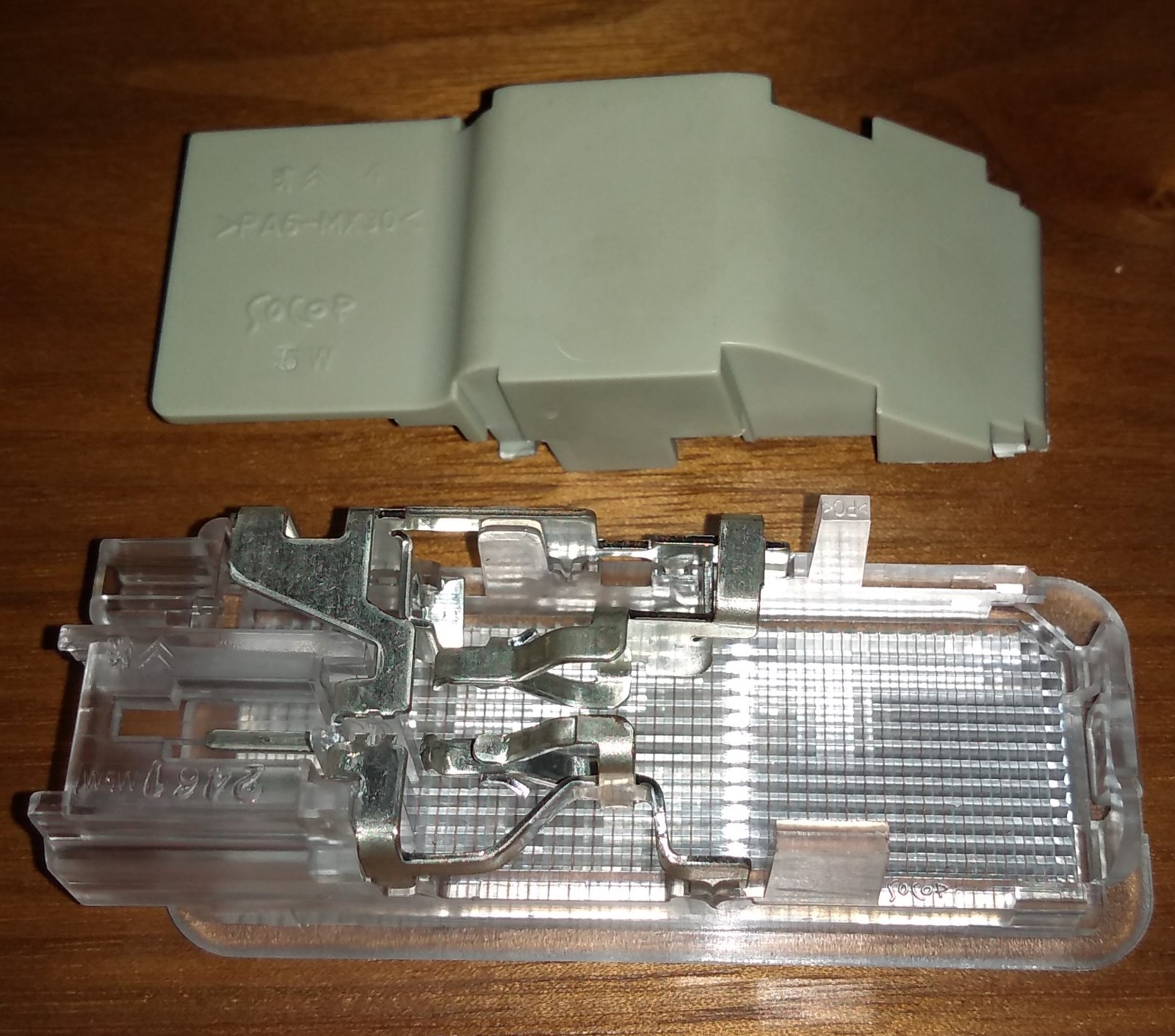

My DS5 didn't have any functional lights in the front footwells.
I looked under the dash and found only one light assembly (driver side), which didn't work. I didn't bother taking it apart to check if there was a bulb in it.
Seeing as I'd have to get at least one new assembly, I looked around and didn't find anything other than "compatible" ones that come with LED lights in them.
So I bought a pair like these, which I think have the LED module built in (ie not really interchangeable with regular bulbs)
as you can see, those look very different to the original one (EDIT) which I've since taken apart and took this photo
I might try to get a normal bulb and see if my one original assembly is working, so that I can compare it with the new ones.
