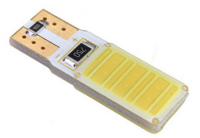

If you want a different colour, you can get these filament bulbs in a variety of different colours quite cheaply.
However, if you want LEDs for a brighter finish, make sure they have built in resistors. I fitted a load of these in my X7 interior - I was trying to get a cross between a warm interior - not too blue, not too red, but ended up with something akin to a pimpmobile! I will be changing the colours again maybe this summer, but these have resistors built in and you can see how they work without issue:
This is the LED bulb type:
