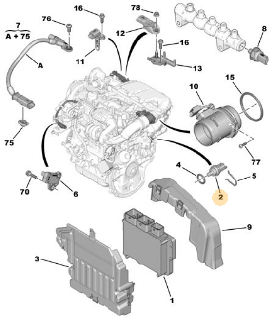

Ok, so the water temperature sensor is item (2) on the diagram.
Part number 1338C1 (DIAM 25,4-LONG 53) in case you need it.

Thanks for that diagram, the sensor no 2 i have already changed. I have not had time to investigate further but it has been suggested today that it may be the water pump, that is causing the fault as the light/fault only illuminates when engine is idle 10 seconds after acceleration it goes off and stays off while normal driving. They suggested that the coolant may not be being circulated fast enough due to impeller failure. Any thoughts on this?
