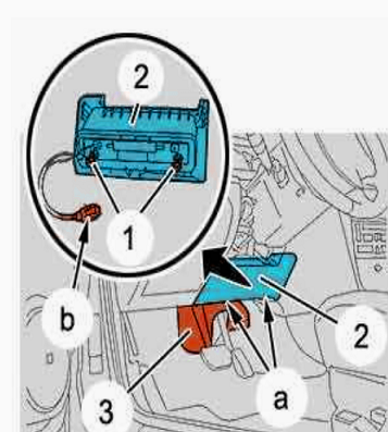

Not exactly, it will most likely be the gearing at the flap reduction motor or the spindle to the other end.
If this is a Dual Zone system it has both right and left hand Air Distribution Motors and left / right Air Mixing Reduction motors.
So from what you have said already it is stuck on a set temperature on the Driver's side. That will be the last setting mid-change before the gearing wore out completely / snapped or the reduction motor for this function gave out. I would also confirm that regardless of temperature, you also check the directional motors are working.
Turn the blower motor up and then change the air distribution for the driver side through all positions and make sure that the air distribution motor is working fine (as you don't want to be doing the job twice if this is also not working).
If it is the Driver side, then you will need to remove the driver's Knee airbag. Disconnect the battery following the (BSI Reset / Battery Disconnect / Reconnect Procedure) wait 5 minutes and do not allow the battery terminal to make contact again! Remove the trim (3), and the 2 bolts. The diagram is for a left hand drive, but similar to the RHD model. Disconnect the electrical connector an 'b' and then remove the airbag unit carefully (2).
This should allow better access to the side trim to access the motors.
You should then have an idea which bit is faulty.
| Left Hand Side (RHD) Item (3) is the Air Distribution Motor Not (2):- Remove bolts and electrical connector to remove. | Driver Side (RHD) The Air Distribution Motor is item (6) on this side. |

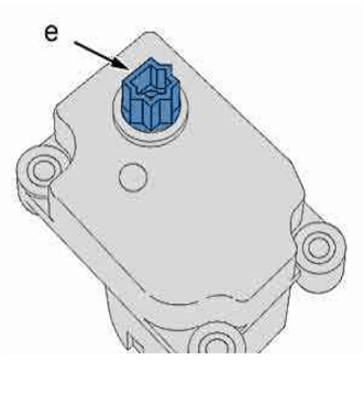

As per the previous diagrams, once you take the knee airbag unit off and follow the notes I mentioned, you should have access to the inside where they are located.
When refitting When you refit the new motor - make absolutely sure you position the locating tab correctly at " e" when refitting the reduction motor for mixing flaps.
