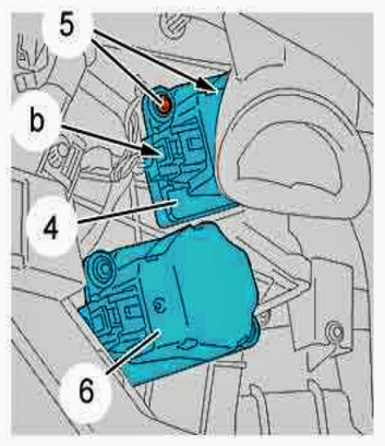

Not exactly, it will most likely be the gearing at the flap reduction motor or the spindle to the other end.
If this is a Dual Zone system it has both right and left hand Air Distribution Motors and left / right Air Mixing Reduction motors.
So from what you have said already it is stuck on a set temperature on the Driver's side. That will be the last setting mid-change before the gearing wore out completely / snapped or the reduction motor for this function gave out. I would also confirm that regardless of temperature, you also check the directional motors are working.
Turn the blower motor up and then change the air distribution for the driver side through all positions and make sure that the air distribution motor is working fine (as you don't want to be doing the job twice if this is also not working).
If it is the Driver side, then you will need to remove the driver's Knee airbag. Disconnect the battery following the (BSI Reset / Battery Disconnect / Reconnect Procedure) wait 5 minutes and do not allow the battery terminal to make contact again! Remove the trim (3), and the 2 bolts. The diagram is for a left hand drive, but similar to the RHD model. Disconnect the electrical connector an 'b' and then remove the airbag unit carefully (2).
This should allow better access to the side trim to access the motors.
You should then have an idea which bit is faulty.

| Left Hand Side (RHD) Item (3) is the Air Distribution Motor Not (2):- Remove bolts and electrical connector to remove. | Driver Side (RHD) The Air Distribution Motor is item (6) on this side. |

As per the previous diagrams, once you take the knee airbag unit off and follow the notes I mentioned, you should have access to the inside where they are located.
When refitting When you refit the new motor - make absolutely sure you position the locating tab correctly at " e" when refitting the reduction motor for mixing flaps.

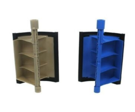

Ok, so the issue is going to be one of 2 things:
A) The motor itself (unfortunately rarely the case that these go)
B) The shaft from where it connects to the motor to the heater flap itself which is onside the box.
As detailed in the thread below, the lubricant at the factory dries out and the constant heating / cold stress on the plastic over time causes it to distort, leading to additional strain on the cog housing.
I believe the C5 II and the Peugeot 407 shared a replacement / repair heater flap kit as shown here :
The same kit from Citroen (part number: 6480E3) is £111.46 inc. VAT.
This is a reinforced kit (but you may need to ask for the lubricant too.
Now the bummer is, that it's a dash out job to get the heater flaps replaced (and do both sides at the same time of course).

Lastly, here's a bodge it video of a chap doing the repair on his 407 which uses the same system as the C5. He opted to repair the snapped shaft by cutting out part of the side and removing the flap control and bits, repairing with Araldite and twine, then reinserting and gluing the box plastic he removed back in again. The prospect of removing the dash was probably too much so he cheated! It seemed to of worked, although I do wonder if he's still with us, or has he passed out from all the glue sniffing!
