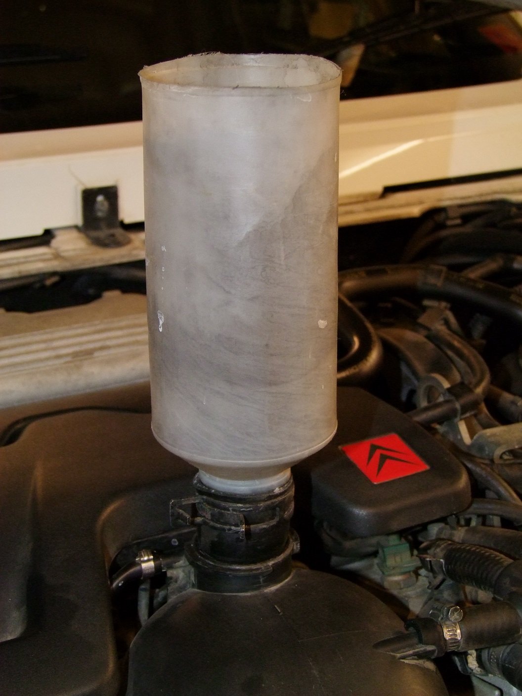

Just a couple of observations on the need to 'de-gas' (bleed out air)...
Some cooling systems are more prone than others to air in the cooling system getting trapped in 'pockets'. Some of these likely to be at 'high points' in the system, where air would accumulate. Some vehicles don't help with this sort of thing, because the header tank/filler cap, and bleed-points, can actually be lower than some other parts of the system, and trapped air will rise.
XM 2.5 is a good example of this, and there is a mandatory procedure for purging trapped air, which simply involves using an inverted open bottle (half filled with coolant) on the header tank - to create extra "head" for the system, while it is brought up to full working temperature, and the bleed screws are opened several times.
For a lot of systems, if coolant is being replaced, or the system in an way drained, the chances are that air will have got into the system. It is important that this is got rid of, which may, or may not, happen with just some normal driving after refilling.
In the worst case, an un-spotted air pocket can be in the cylinder head (often a high point) and this can create a hot-spot, and localised boiling. If this happens, coolant can be thrown out. BX XUDs were susceptible to this (inadequate or absent header tank), and the overheating could warp the cylinder heads and ruin head gaskets.
As Marc says, the recommendation to 'de-gas' is there for a reason. My own view is that whenever a vehicle has its coolant drained/replaced, attention should be given to removing inevitably trapped air, rather than just hoping it will find its way out. Even new coolant will contain some dissolved air, which will come out of solution as it approaches boiling point.

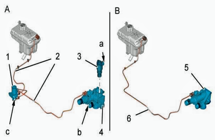

The modification was made with the new Coolant Outlet Housing from models built from 30th January 2005. Yours was built 2nd February 2006, so will have the new one fitted.BadIdea wrote: 16 Jan 2020, 09:05vindecoderz.com says 14.02.2006, is that correct? What are the implications of this manufacture date for degassing?GiveMeABreak wrote: 15 Jan 2020, 17:41 Good for you Peter, I'm pleased.
On this 407 there was an earlier version of the outlet cooling housing unit with additional degassing pipes and 2 control solenoids to aid in the degassing. These have been superseded now with a replacement part - but IIRC the OP has a build date after the modification, so should have the newer unit on.
I only go on what is supposed to be done (officially), in most cases as my philosophy is if it didn't need to be done, then it wouldn't be included in the procedure. It's my intention to avoid causing any potential additional problems by including at least what is supposed to be done and then the OP can make his choice bearing this in mind.
The E36 beemers (six cylinder, at least) are notorious for air locks if not bled properly. I used to remove the top hose from the radiator, stretch it up as high as it would go, then pour coolant into the block, as the bleed screw was never sufficient.
For those others who may be reading this and are interested:
| (A) Old Assembly <= 30/01/2005 (B) New Assembly => 31/01/2005 The following parts have been discontinued:
Note: The elimination of the solenoid valves will result in the following 2 fault codes:
- P1579: Cooling circuit degas solenoid valve
- P1597: Cooling circuit by-pass electrovalve
There are no documented reasons why the modification was made going forward, but there would be little point, I feel, in going into the workings of the older system being that it is no longer relevant.
So if, when you get a diagnostic done, make a note of these 2 codes which can be ignored on vehicles without the solenoids fitted / disconnected.
