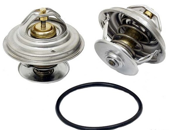

There have been a regular number of posts concerning engine (coolant) thermostats, and running temperatures. Below are a few remarks about them, how they function, and how to diagnose thermostat issues.
The role of the thermostat is to control engine block/cylinder head running temperature, and get it up to useful and efficient operating temperature as quickly as possible, after starting up and driving away from cold. By 'blocking off' the car's main cooling circuit and radiator, the precious heat produced immediately after start-up is circulated (by the water pump) only through the engine block and the interior (cabin) heater. This warms up the engine far faster than if the main radiator were left in circuit, and also provides rapid cabin warmth and demisting.
From cold, under normal driving, the water temperature in engine block and cabin heater quickly rises, and at some point it is necessary to prevent over-heating, and this is where the thermostat starts to operate. At a pre-set temperature (typically 80-85degC) of the hot water behind it, the 'stat begins to open slightly, and allows a small quantity of hot water to head towards the main radiator, usually by way of the large radiator 'top hose'. In doing this, cool water (from bottom of the radiator) heads into the engine block and has a cooling effect. This in turn slightly reduces the coolant temperature in the block, and the thermostat closes minutely to compensate.
This gradual 'stat "cycling" continues as the engine produces more and more heat, until the whole system becomes balanced: engine producing heat, radiator (and cabin heater) dispelling it, and the thermostat open just wide enough to maintain that balance.
Thermostats have two rated temperature figures: opening temperature, and fully open temperature. These vary from car to car, engine to engine, but might be something like 82C opening, 98C fully open. What do these mean?
The opening figure is as above – the temperature at which the thermostat begins to open. It also means that that is the engine temperature which can be expected to be achieved and maintained after a short time on the road, even if it is quite cold outside. (The only exception to this is if it is icy cold, and the engine is being driven extremely gently (notably a diesel setting out on a drive downhill) so little fuel is being burnt. In this case, the loss of heat from the engine block/cabin heater may be so great that 'stat opening temperature is never achieved.)
Under normal temperate conditions, though, engine coolant temp will continue to rise, the 'stat will progressively open, and equilibrium will be reached – with the car's temperature gauge reading Normal, or something like 90degC, maybe a little less. At this temperature, the 'stat will not be fully open, but will still be gently restricting water flow to the main radiator.
So what happens if the engine gets much hotter – e.g. hot conditions, heavy load, towing, or hill-climbing? As the engine works even harder, the 'stat will open further to increase the flow-rate to the radiator. The 'fully open' figure for the 'stat is the temperature at which its disc valve is fully open, and offers almost no resistance to coolant flow. This figure (which you would have to look up in a workshop manual) is usually pitched quite high (e.g. 98C), near to where the car's electric cooling fans would be cutting in to aid air flow though the radiator.
Isn't this dangerously close to water's boiling point of 100C, though? Yes, but car cooling systems are pressurised (by the spring-loaded coolant filler/pressure cap), and this raises the boiling point. Boiling can normally be avoided up to 120C or so under these conditions. Electric fan fast speed may not be triggered until something like 102-105C is reached.
Under these very hot conditions, the thermostat will be wide open (or even fully open), and will play no part in regulating engine temperature - that will be all down to the radiator and the fan(s), with maybe some heat being shifted by the cabin heater (or not, depending on time of year!). The thermostat will not have any effect on the running temperature until ambient conditions reduce, or the engine can stop working so hard. As they do, the fans will first cut out, and as things get less hot the 'stat will begin to close again, just enough to maintain normal operating temperature. If temperatures drop enough (e.g. you stop climbing uphill, towing, with a well-laden car in icy winter) it is conceivable that the 'stat might even close fully again, to secure an engine (and cabin heater) of not less than its rated opening temperature (e.g. 82C).
So, that's how they work: (a) to maintain a minimum engine temperature (unless in freak cold conditions of an icy-blast engine bay), and (b) to progressively allow the cooling effect of the main radiator/fans to come into play. At very high temperatures, beyond 'fully open', they play no part.

Back to thermostats: how do you test whether yours is working?
Thermostats can be:
- ok and working
- missing! (unusual nowadays)
- stuck closed (severe overheating; rare, and designed not to)
- stuck fully open (rare)
- stuck partially open (much more common)
- not opening fully (symptom is persistent overheating)
- leaky (slow warm up, chilly/erratic cabin heater)
A typical 'stat will have a wax-filled piston, which pushes open a metal disc to allow the coolant through. A good few of these discs incorporate a rubber washer surround (so they seal when closed), and this rubber can split, or fall away. When it does, the 'stat goes leaky, and always lets an amount of coolant through, even under cold conditions. This results in chilly running (and inadequate or erratic cabin heating). In winter, only a bit of spirited driving will get the temp (gauge) up, only to have it fall again when you have to ease off the gas. That's typical of a leaky 'stat.
There is a way to check for a leaky / missing / stuck-open 'stat:
- With a cold engine, with your hand, feel the temperature of the radiator top hose, and engine block side of the water outlet (where 'stat is housed). They should both feel cold.
- Start the engine, and allow to idle for several minutes.
- Feel those two spots again: you should feel the engine block warming up (be careful!), but the radiator top hose should remain cold. This is because the thermostat should be shut.
- Leaving the engine to idle for some time (maybe 10mins+, or a good bit longer if a diesel), the rad hose should remain cold, but will eventually begin to get warm. This shows that the thermostat has opened. See what the dash gauge reads, out of interest.
- Engine should be getting decently warm, cabin heater producing useful heat, gauge starting to climb.
Left long enough (takes forever if a diesel; they use almost no fuel at idle) the radiator top hose will get really hot, and fan(s) will cut in.
If all that happens, the 'stat is there (!) and not leaky. It may be opening prematurely (or be a chilly one) but only a real temperature check will reveal that. (If your 'stat is the simple skeleton type, you may be able to remove and test its opening temperature (and whether it goes fully open) with a thermometer in a pan of heated water. They're so cheap, probably best just to renew it, and maybe check the old one out of interest.)
BUT, if the radiator top hose warms up from cold simultaneously and at the same rate as the engine block, then the thermostat is either missing (!), leaky, or failed open. Renew it.
A straightforward check to do.
Hope helpful.

In other news, the genuine thermostat arrived today. £9.50 on Ebay. Well happy with that. Fitted it and to my amazement the engine heats up so much quicker now. I went through my car fuel usage history and the highest last year was 47 mph. Last tank was 35mpg and two before we less than 40mpg.
I just would never have believed that such a tiny slither of light between the rubber inner valve and the body would make such a difference. I drove down to town (2 miles downhill with a few traffic lights and reasonably well moving traffic for the most part) and- gave the engine a good race for the final 200 yards before pulling up and temp was at 80 deg.
The other night I drove just over 4 miles and deliberately slowed to a virtual standstill at speed humps and revved it up a steep 100 yard incline just before home and it only got to 70 deg.
Fuel consumption should improve.
Heater obviously feels better but it peters out pretty quickly which possibly suggests reduced flow through the matrix. Will report back as the weather gets colder. That'll be the acid test.
As for proper bleeding, how do you guys who have had a Xantia manage to remove the schraeder cap off the heater matrix bleed without scalding yourselves and to allow enough water to bleed through?
The schraeder near the offside engine mount is probably the highest on the system. Are there any others?
BoL states pre-97 Xantia should have 89 deg 'stat! It had and now has 83 deg. Maybe this was to allow for poorer flow through earlier matrices.

Use a short length of small-bore rubber hose pushed on to the schrader cap to unscrew and replace it.
Saves scalding fingers. Properly tighten by hand afterwards.
