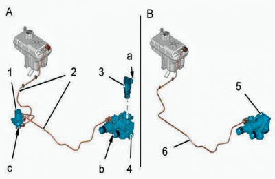

The modification was made with the new Coolant Outlet Housing from models built from 30th January 2005. Yours was built 2nd February 2006, so will have the new one fitted.
For those others who may be reading this and are interested:
(A) Old Assembly <= 30/01/2005
(B) New Assembly => 31/01/2005
The following parts have been discontinued:
  • (1) Venting electrovalve
  • (2) Degas pipes
  • (3) Bypass solenoid valve
  • (4) Coolant outlet housing (piloted thermostat)
The connectors of the following components are disconnected:
  • Bypass solenoid valve (at "a")
  • Coolant outlet housing (piloted thermostat) (at "b")
  • Venting electrovalve (at "c")
Replacement Parts Available:
  • (5) Coolant outlet housing
  • (6) Degassing pipe
  • 3 plastic tie wraps
  • 3 connector protectors
The tie wraps and connection protectors are to protect the electrical harness.
Note: The elimination of the solenoid valves will result in the following 2 fault codes:
  • P1579: Cooling circuit degas solenoid valve
  • P1597: Cooling circuit by-pass electrovalve
If the solenoid valves are missing, then these 2 codes can be ignored.
There are no documented reasons why the modification was made going forward, but there would be little point, I feel, in going into the workings of the older system being that it is no longer relevant.
So if, when you get a diagnostic done, make a note of these 2 codes which can be ignored on vehicles without the solenoids fitted / disconnected.
