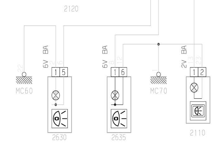

Ok, just so you know, data for the Relay and Boxer vans is slightly better than useless - probably because these are Fiats / Ford combos with nothing Citroen or Peugeot in them. The wiring numbers are non-descript so I cannot provide you with specifics - but you should be able to work out what is what. I will show these individually for each lamp - once you identify the earths, the remaining should be the power.
Brake Lamps:
Rear Sidelights
Reversing Lights
Fog Lamps
Hopefully this is what you need.
Brake Lamps:
2630: rear LH lamp unit on the body 2635: right-hand tail lamp 2110: additional brake lamps So anything 'MC' is an earth point - MC69, MC70 etc. |
2630: Rear LH lamp unit on the body | 2635: right-hand tail lamp |
2630: Rear LH lamp unit on the body 2635: Right-hand tail lamp 2200: Reverse lamp switch |
2630: rear LH lamp unit on the body 2635: right-hand tail lamp |
