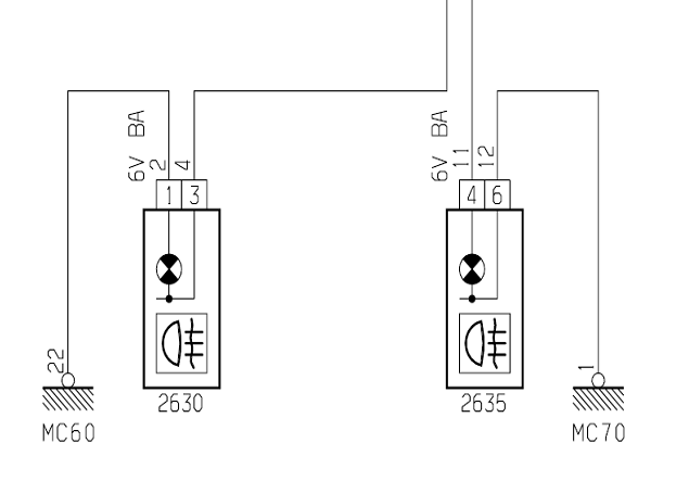

Ok, just so you know, data for the Relay and Boxer vans is slightly better than useless - probably because these are Fiats / Ford combos with nothing Citroen or Peugeot in them. The wiring numbers are non-descript so I cannot provide you with specifics - but you should be able to work out what is what. I will show these individually for each lamp - once you identify the earths, the remaining should be the power.

Fog Lamps
2630: rear LH lamp unit on the body
2635: right-hand tail lamp
Hopefully this is what you need.
