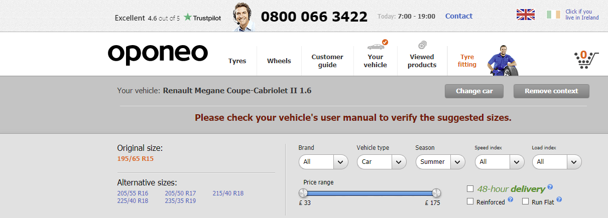

As you can see Steve, from the info you provided - it has listed 195/65 R15 in red as the defaults - but under that has brought up the correct alternatives - and I suspect it's because of the options so specs / upgrades available.
