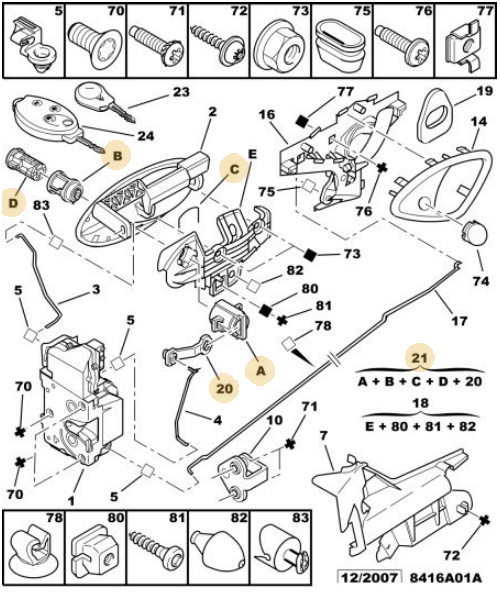

Xantianut
- Posts: 877
- Joined: 07 Aug 2012, 19:50
- x 127
Re: Life on the edge - lock advice needed
Hello, Friends.
The Old Fool would ;Ike to know if Xantia locks would fit. He thinks they look similar and he says he's worked out how to release the cylinder from my door handle.

- x 6946
They're different parts. The C5 locks are available to fit your key on order, or random - which means new key blades.

- x 6946
£66.76 for the lock with combination specified on order (item 21) inc. VAT. 9170Z6 is the part number, but I'll need a VIN to confirm.
or:
£111.89 for the random lock, part 9170Z7, yes all from Citroen.
or:
Onlinemyglaren
- Posts: 28733
- x 5673
That seems rather back to front.
- x 6946
I think the reason being is that if they use your existing confidential key code they don't have to go through the hassle of creating a new unique barrel and create a new key blade pattern designed to fit it Steve.
- Posts: 14313
- x 3296
That makes sense.
