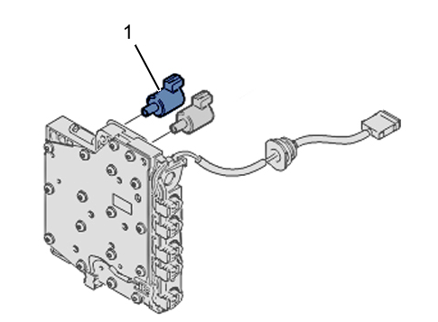

This is an uncharacterised fault Avi, but I do have a technical service bulletin on this issue:
"Illumination of the gearbox diagnostic warning light: This incident causes a sensation of slipping (The gearbox changes to limp home mode) - In the presence of fault codes P1167, P0745, P06"
The TSB points to the replacement of the pressure modulation electrovalve (EVM). Part number: 257416
It refers to firstly checking the gearbox oil level.
- If the oil level is not correct, first search for the source of any oil leak.
- If the oil level is correct, replace the pressure modulation electrovalve.

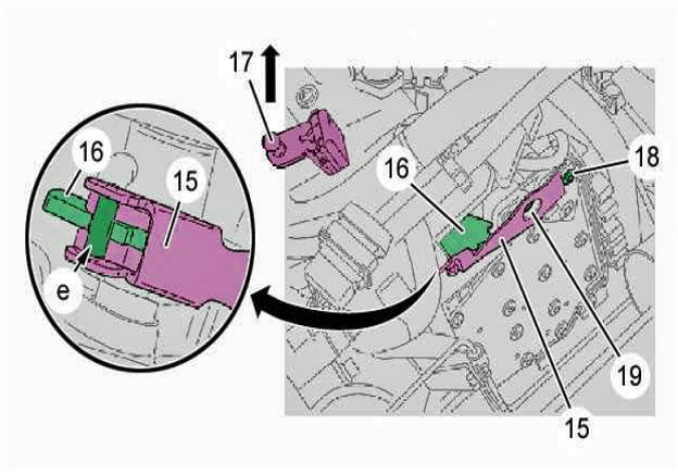

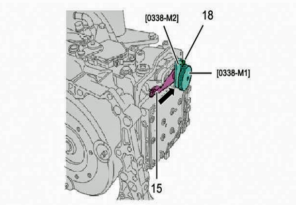

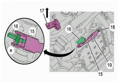

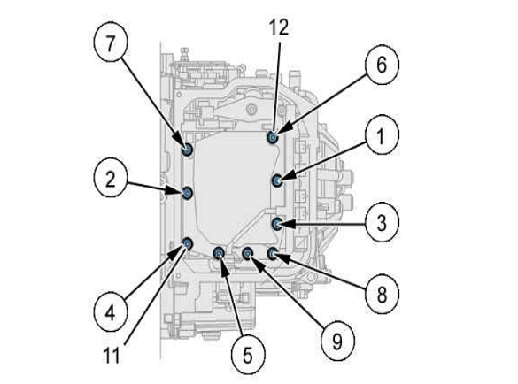

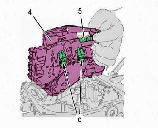

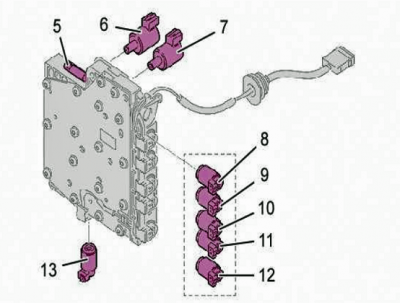

This is the formal procedure for the AL4, which does suggest a lift to make access easier, plus also read through first, as you will need to drain the cooling system and refill, plus there are some tools and procedures you will need to do after. Don't forget you will also need to replace the seals when changing the electrovalves.

Refitting - Electrovalves of the hydraulic valve block
Adhere to the tightening torques
CAUTION: Change the solenoid valve seals each time the solenoid valves are refitted.
CAUTION: Check the operation of the gear selection control in all the positions. The lever must have no overtravel (17) when it is in the mechanical stop position towards the rear (In the direction of the arrow ).
Refit:
Reconnect the ancillaries battery. (Refer to reconnection part of the linked procedure).
Fill the gearbox with oil.
Carry out filling and bleeding of the coolant circuit and top up the level.

CAUTION: This operation requires a great deal of care; take all possible cleanliness precautions.
Raise and support the vehicle on a 2 -post lift.
Disconnect the ancillaries battery. (BSI Reset / Battery Disconnect / Reconnect Procedure)
Remove:
- The air resonator
- The protective panel under the engine (according to equipment)
- The components necessary for removal of the hydraulic block
Drain the cooling system.
Remove:

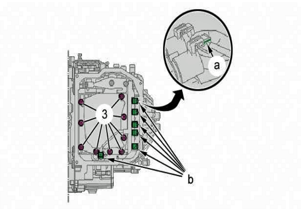

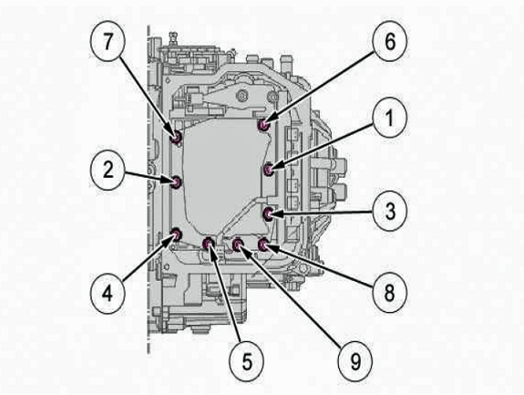

| Remove the 9 bolts (3). Disconnect the connectors of the 6 sequence solenoid valves (at "b") Lever gently using a screwdriver (at "a"). |

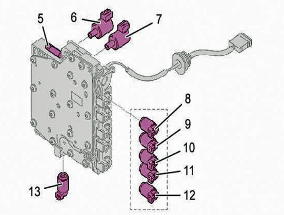

| Move aside the hydraulic block (4). CAUTION: Do not drop the manual valve (5). Disconnect the pressure modulation solenoid valve connectors (at "c"). Remove the hydraulic valve block (4). | (5) Manual valve. (6) Main Pressure Solenoid Valve (pressure EVM). (7) Converter control modulating solenoid valve (lock-up EVM). (8) EVS4 sequential solenoid valve. (9) EVS3 sequential solenoid valve. (10) EVS1 sequential solenoid valve. (11) EVS2 sequential solenoid valve. (12) EVS6 sequential solenoid valve. (13) EVS5 sequential solenoid valve. Note: It is not necessary to remove the hydraulic block (4) in order to remove the sequential solenoid valves (8-13). CAUTION: When the sequence solenoid valve EVS5 (13) is removed, support the hydraulic slide valve controlled by the solenoid valve so that it does not fall. If necessary, remove the hydraulic block (4) solenoid valves |

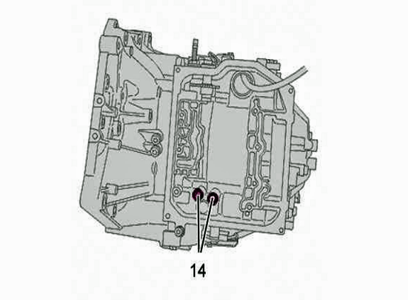

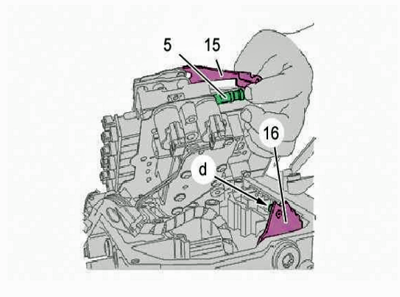

| CAUTION: Fit new seals (14). Position the hydraulic valve block (4). Reconnect the connectors of the pressure modulation solenoid valves (at "c"). | CAUTION: Take care that the manual valve (5) is engaged in the lug "d" of the notched section (16). |

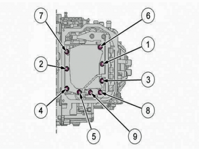

| Refit the 9 bolts (3) of the hydraulic valve block (4). Reconnect the connectors of the 6 sequence solenoid valves (at "b"). | Adjusting the internal selection control CAUTION: Carry out this adjustment at each operation on the hydraulic block (4) or on the internal selection control. N.B. : The adjusting is done with the cover (2) of the hydraulic block (4) removed. CAUTION: Move the lever (17) to the mechanical stop position towards the rear of the vehicle (In the direction of the arrow ) Hold the lever (17) by means of a plastic locking clip during the adjusting procedure. Slacken the bolt (18). Place the roller "e" of the blade (15) in the notch position 2 of the notched section (16). Remove the bolt (19). |

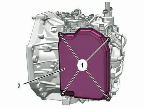

Refit:
- The casing (2) fitted with a new seal
- The bolts (1)

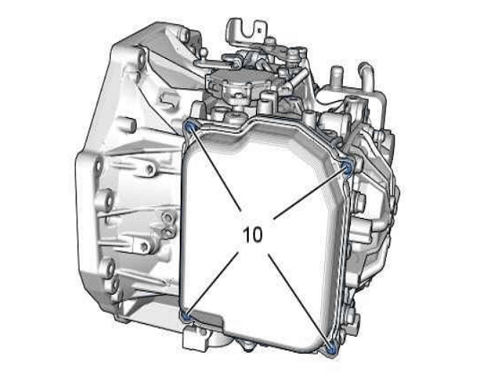

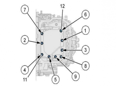

| Ref: (10) Fixing of the hydraulic valve block casing - tighten to 1 daNm | Hydraulic valve block fixing:

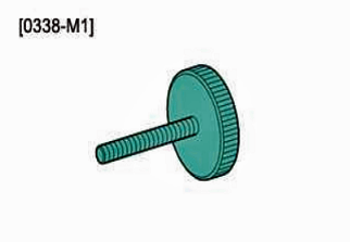

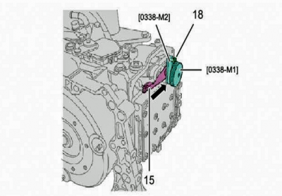

Thanx Marc. as I don't have the 2 tools, I hope that I will be able to manage without them.

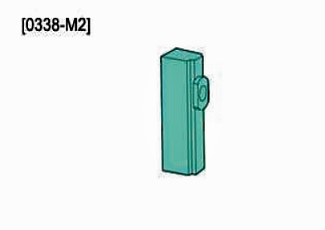

Thanx, I found two, I hope they will help. as per the two tools - the screw (0338-M1) and the shim (0338-M2) - I've searched for any info regarding them, because I would like to fabricate them, but I found nothing. any info - drawing, measurements, etc. will be highly appreciated (let me point out that I have the ability and machinery to do so).
Thanx.
Avi
