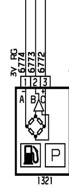

Now I purchased used fuel pressure sensor. But unfortunately I cut the old one from the harness long time ago. This new one have different colours on the cables. How do I connect it right?

Re: Citroen C5 2009 EGR valve
Hi Sufii.
Ok, so the colours are not important as PSA used anything going! What's important are the pin outs.
Wire pin outs:
Pin 1: 6774 (Line Pressure Signal) This goes to pin G3 in the engine ECU
Pin 2: 6773 (Line Pressure - Supply) This goes to pin C4 in the engine ECU
Pin 3: 6772 (Line Pressure + Supply) This goes to pin B4 in the engine ECU
The Engine ECU connection should be a brown 48 pin connector.
Wire pin outs:

Thanks for very good help. But I have to admit that my car is still standing still. Been a few months now. So I replaced the EGR valve and the fuell pressure sensor regarding to the chart diagram you posted. But the car still won't start. What can I do further?
