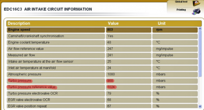

Re: Diagbox turbo pressure measure
There are no tables listed for what the values should be at certain revs, but there are reference values that you can compare with when using standard parameter tests:
In the Air Intake Circuit for example, I have highlighted the readings - see if the reference value changes as the engine increases...

Ok tnx,so correct turbo pressure should be same as reference value?At me reference value is always bigger than pressure?
x 6963
If you are concerned about the turbo pressure - you'll really need to check the turbo pressure sensor and turbo position copy sensor readings from the parameters in Diagbox compared with a physical gauge attached to the circuit.
I can only tell you what the sensor voltages correspond to in mbars.

Unread post by Slobo2712 »
800 rpm
3200 rpm
I have changed new electro vacuum valve
x 6963
Nice one. Sometimes the filters on these get blocked up and the vacuum is very poor.

Tnx for answer so as i understand on second image 3200rpm turbo pressure measured needs to be also 1600?

Were the screen-shots above taken with the engine under load, or just free-revving? I would expect an error code for low boost to be thrown if the conditions in the second table persisted for several seconds with the engine under load.

xantia_v6 wrote: 29 Nov 2019, 06:18 Were the screen-shots above taken with the engine under load, or just free-revving? I would expect an error code for low boost to be thrown if the conditions in the second table persisted for several seconds with the engine under load.
First screen shot is under load,second is car not drive but with load.I have tested these parameters when driving,they are strange..sometimes turbo pressure is same as reference,and sometimes pressure is higher than reference..Is it possible that catalyst is oil dirty or same thing with turbo part which vacum moves,dont know name..?Tnx
