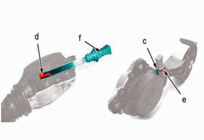

Release the coolant pump inlet friction wheel (7) by pulling the tab "f".
Release the tab "f".
Reposition the tab "f" in its location.
Act on the dynamic tensioner (1) so that the pin "b" returns to its initial position ; Using a 21/23 mm counter-offset spanner.
N.B. : Check that the belt is correctly fitted in the grooves of the different pulleys.
N.B. : Check that the tab "f" is positioned correctly in its location.

| Turn the dynamic tensioner (1) clockwise until the notch "a" is aligned with the pin "b", using a 21/23 mm counter-offset spanner. Press on the pin "b" to the stop, release:
| "c" Position maintaining pin. "d" Friction wheel unlocking position notch (Operating mode). "e" Friction wheel locking position. "f" Tab. |
| Pull on the tab "f" until the pin "c" is aligned with the notch "d". Raise the tab "f" until the notch "d" engages on the pin "c"; Release the tab "f" for immobilisation to keep the coolant pump inlet friction wheel (7) unlocked. Remove the accessories drive belt (3). Caution: Check that the roller of the dynamic tensioner (1) and the coolant pump drive friction wheel (7) rotate freely (Absence of play and points of resistance). |
