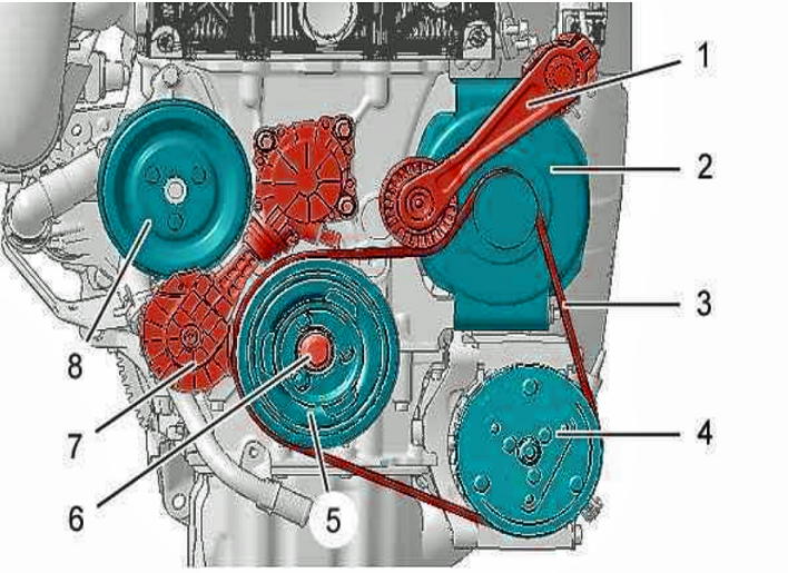

This is the correct procedure for changing the Aux belt and I have included the full guide for removing and refitting for completeness.

| (1) Dynamic tensioner. (2) Alternator. (3) Ancillary drive belt (/). (4) Air conditioning compressor. (5) Ancillary drive pulley on crankshaft. (6) Crankshaft pulley hub fixing bolt. (7) Coolant pump drive friction wheel. (8) Water pump pulley. |

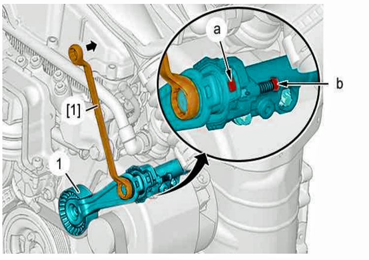

| Turn the dynamic tensioner (1) clockwise until the notch "a" is aligned with the pin "b", using a 21/23 mm counter-offset spanner. Press on the pin "b" to the stop, release:

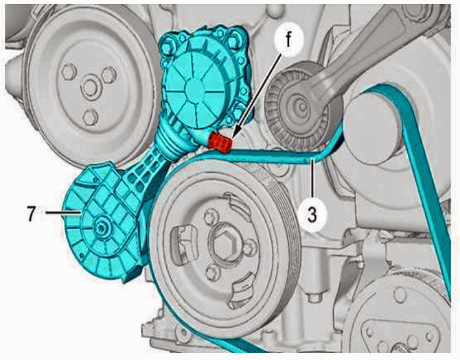

| "c" Position maintaining pin. "d" Friction wheel unlocking position notch (Operating mode). "e" Friction wheel locking position. "f" Tab. |
| Pull on the tab "f" until the pin "c" is aligned with the notch "d". Raise the tab "f" until the notch "d" engages on the pin "c"; Release the tab "f" for immobilisation to keep the coolant pump inlet friction wheel (7) unlocked. Remove the accessories drive belt (3). Caution: Check that the roller of the dynamic tensioner (1) and the coolant pump drive friction wheel (7) rotate freely (Absence of play and points of resistance). |
