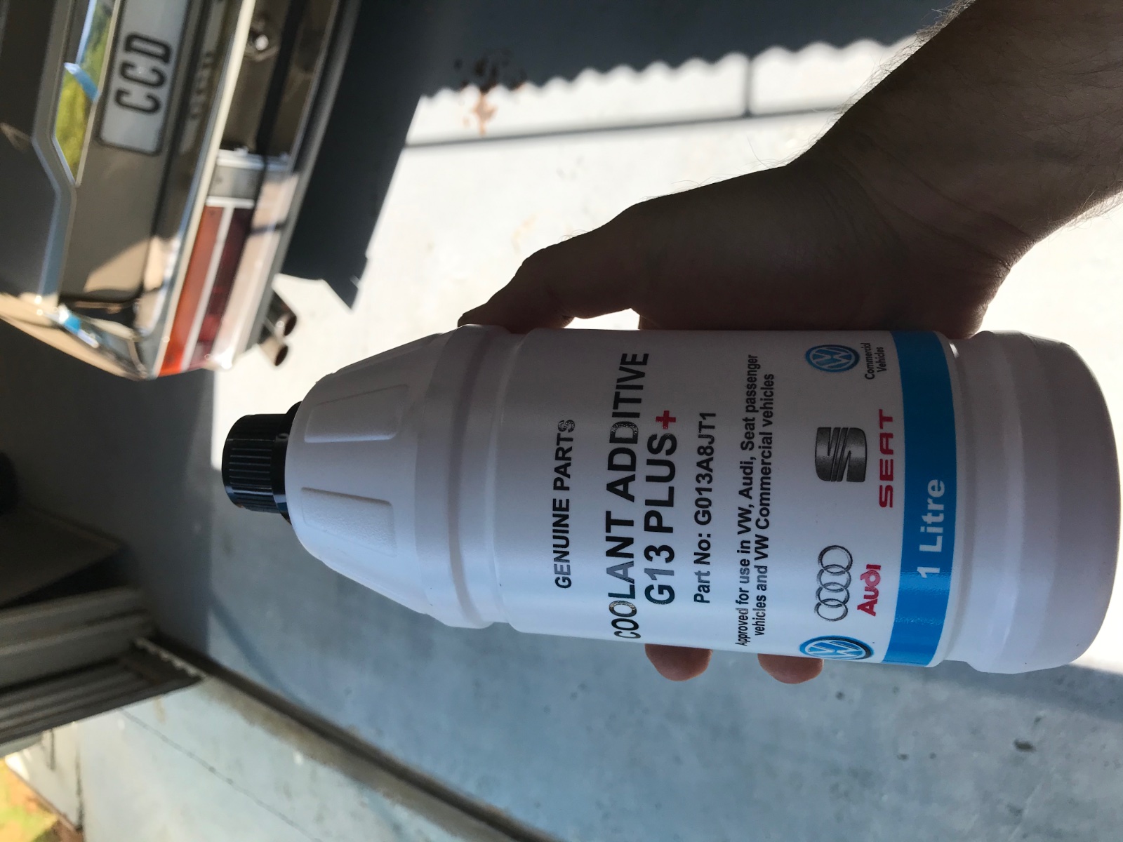

Well.
It seems my luck getting TOTAL OAT technology antifreeze has run out.
I settled for Volkswagen G13 antifreeze which is an OAT longlife coolant. Was a bit cheaper than Citroen IAT antifreeze

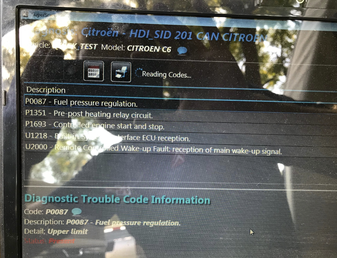

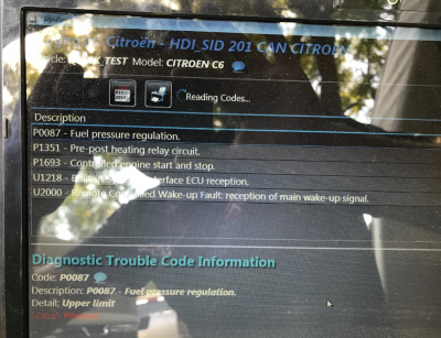

My Eloisa.... sigh. The madness continues.
Intake manifold taken off and cleaned. Cambelt done. Diesel pump belt done. Waterpump and antifreeze too.
Took her for a 240km drive. On my way back pollution message came on the display and engine light. Did a diagnostic. I also temporarily lost power under dull throttle. Was a bit alarming!
This is a picture of the faultcodes on display. The fuel pressure faulcode worries me... what can it be?

I know that you've changed the fuel filter, but its it possible that you've dislodged a load of crud that has blocked the filter whilst you have been busy doing all the other parts? The low pressure earning would indicate a blockage hence the cut off at higher revs and the backup mode engaged.
You could have some crap in the filter, or air in the system. If you have a leak back kit - see if an excessive amount of fuel is returning - if it is then it's likely to be the fuel filter blocked, check the pipes are connected correctly, or air or the fuel pump.

Hi Marc
I will check. Anything is possible being that she stood this long. Why does the computes state upper limit? I thought that the pressure was too high?
Anyway. Thanks for the clarification. Will change the filter again as I did buy one extra from the dealership. I also think I need to run the diesel tank to just about empty. Then again some fresh fuel.
What will the other codes mean? Besides the pre post heating circuit relay?
Thanks for correcting the picture. For some reason my iphone uploads them wrong way up.

P0087 is saying the fuel measured in the fuel rail is less than the setting or lower than the reference. I know on a different engine this code would signify (minus) -200bars for 1 second. So there has to be a blockage, air in the system or a leak - or a failure of the HP pump.

Lets hope it is not the latter... but if it is. Que sera sera. I will replace the dieselfilter in anycase. I do not have a leakdown testkit. I will take her for a drive again tomorrow. I am hoping it is just air somewhere in the system that finally escaped.
Then again. Injectors were disconnected and fuelrails removed. Possibly some leakage it a union?
The adventure continues
