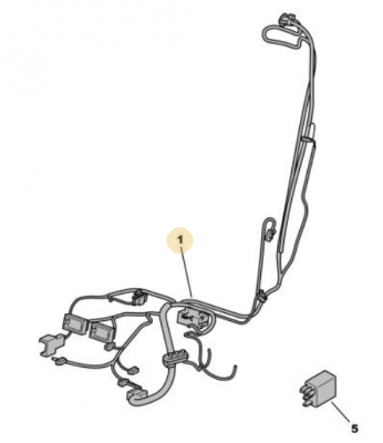

You also have a different Seat and Belt Harness for vehicles without Electric Heated Seats and Memory Control:

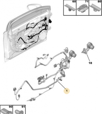

And also the Front Door Harness is different for vehicles without Ambient Lighting and Electrochromed, Memory Controlled, Heated, Folding Indexed Mirrors
You obviously have a Left Hand Drive, so the harnesses are different - but I have looked at these too for you and they are still different for non-controlled, memory heated seats.
I think I mentioned that another member changed the door cards and had to have the control module sent as the wiring int he door was different as I mentioned above.
