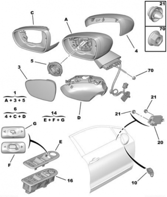

I compared my X7 that is about the same build date and engine as yours (but right hand drive) as I have all the kit on mine from factory - so could check the harness details (comparing with the Left Hand Drive equivalent harness with same functions)
So you don't have the Driver's control unit, for the Electric Seats and ambient lighting, shown as item (20) on the Diagram.
You also have a different Seat and Belt Harness for vehicles without Electric Heated Seats and Memory Control:
And also the Front Door Harness is different for vehicles without Ambient Lighting and Electrochromed, Memory Controlled, Heated, Folding Indexed Mirrors
You obviously have a Left Hand Drive, so the harnesses are different - but I have looked at these too for you and they are still different for non-controlled, memory heated seats.
I think I mentioned that another member changed the door cards and had to have the control module sent as the wiring int he door was different as I mentioned above.
