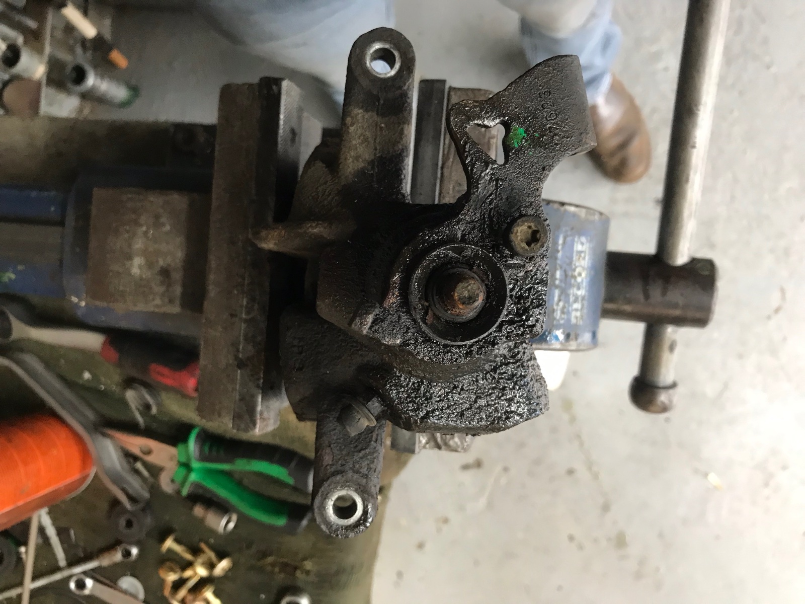

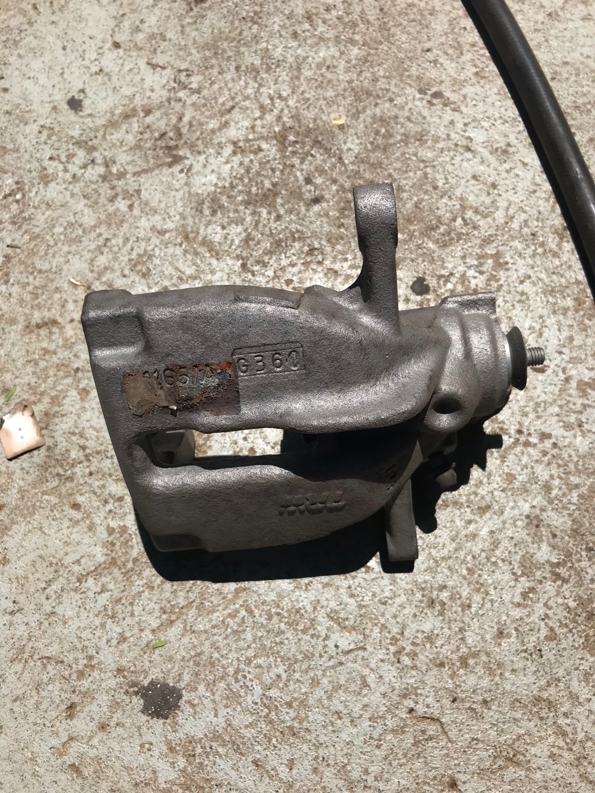

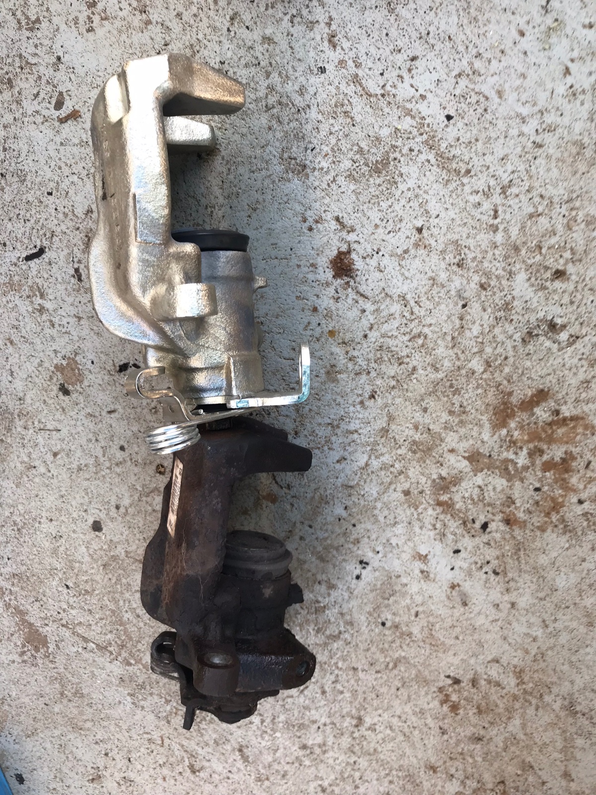

So first thing I thought. Lets find the fault on the handbrake. Whilst someone operated the handbrake in the car I looked at the rear calipers to see if they operated. Immediately saw the right rear caliper was seized. So only one handbrake actually worked. So there begins the process of repairing it. Both rear wheels off and dismantled both rear calipers.
Wow what a surprise. Never understood the rust and salt that you guys suffer from. Until now!
Ended up beadblasting the caliper and the cradle!! To repair the faulty mechanism of the caliper was nothing more than a simple cleaning of the rust. Worked a charm.
Afterwards did zinc-electroplating on the calipers.
The difference was astounding seals were all still perfect so no need to change now. But will order some for the future. I just didn't have new ones on hand. So
This will have to do for now.

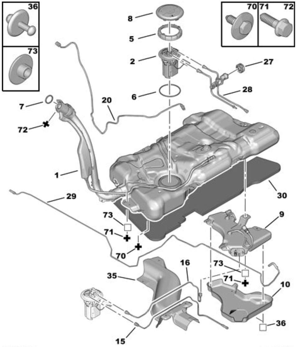

Hi Corne, please tell me you didn’t put any EOLYS DPF additive directly into the fuel tank?
There is a separate additive tank next to the fuel tank for that and should only be topped up when the display tells you it is low. This won’t happen until somewhere at he 75 to 100k miles. It has to be done using a special filling kit and must be the correct additive for your build date, as some additives cannot be mixed.
The engine ECU controls the dosing and metering of the additive pump. The diagnostic tool must then be used to tell the engine ECU that the additive has been added and then reset to zero.
You never put any additive into the fuel tank directly - ever. I hope that explains the system. I’ll let you know the correct additive in the morning, as I’m not as my main rig now.
- x 6945
Re: The first Citroen C6 in South Africa aka ‘Eloise’
The additive tank is item (9) on the diagram Corne:

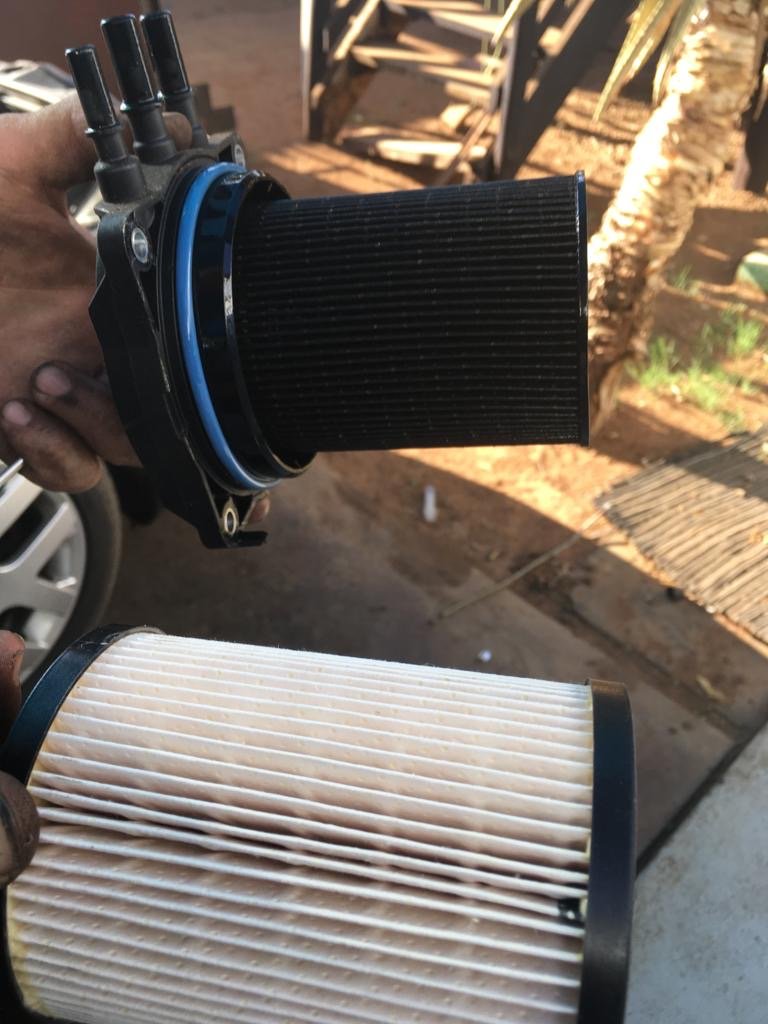

I did change the fuel filter. I must say the filter was pitch-black. I tried blowing through the filter opening and it took serious effort to blow through the filter media. Date stamp on the filter was 2013.... Car was bought from a deceased estate in 2015 and she stood parked in a garage till June this year. The dealer I bought the car from was extremely helpful, got quite a bit of spares from him that he suggested I think of replacing. cambelt and ofcourse the diesel filter. Is there a possibility that the filter may be blocked again after 600km? Guess it is a possibility....
I don't understand the idea of replacing filters at extended intervals suggested at +- 45000km. It is silly! I'd rather replace the filter at my normal intervals of 15000km. I don't care what manufacturers say. filters and oil, all done every 15000km.
@furriegurrie I think I did see that P1156 error code before I wiped the faultcodes to see what came back. possibly that was due to the dirty filter?
- Posts: 28703
- x 5671
That's a very mucky filter Corne. When I change mine the old one looks no worse than the new one, maybe something going on in the tank that bears investigation - there are instances of a biological diesel contamination - microbial or fungal.
Could be due to yours being unused for an extended period so it wouldn't get the regular flushing that most tanks would have.
