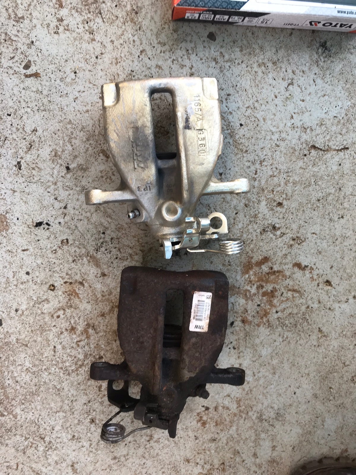

A list of faults was on the display. Handbrake failure, esp/ebd failure.
After connecting the diagnostic system it shows that 3 of the 4 wheel sensors are faulty. Both front and left rear. And a cable fault on the handbrake.
So first thing I thought. Lets find the fault on the handbrake. Whilst someone operated the handbrake in the car I looked at the rear calipers to see if they operated. Immediately saw the right rear caliper was seized. So only one handbrake actually worked. So there begins the process of repairing it. Both rear wheels off and dismantled both rear calipers.
Wow what a surprise. Never understood the rust and salt that you guys suffer from. Until now!
Ended up beadblasting the caliper and the cradle!! To repair the faulty mechanism of the caliper was nothing more than a simple cleaning of the rust. Worked a charm.
Afterwards did zinc-electroplating on the calipers.
The difference was astounding seals were all still perfect so no need to change now. But will order some for the future. I just didn't have new ones on hand. So
This will have to do for now.
