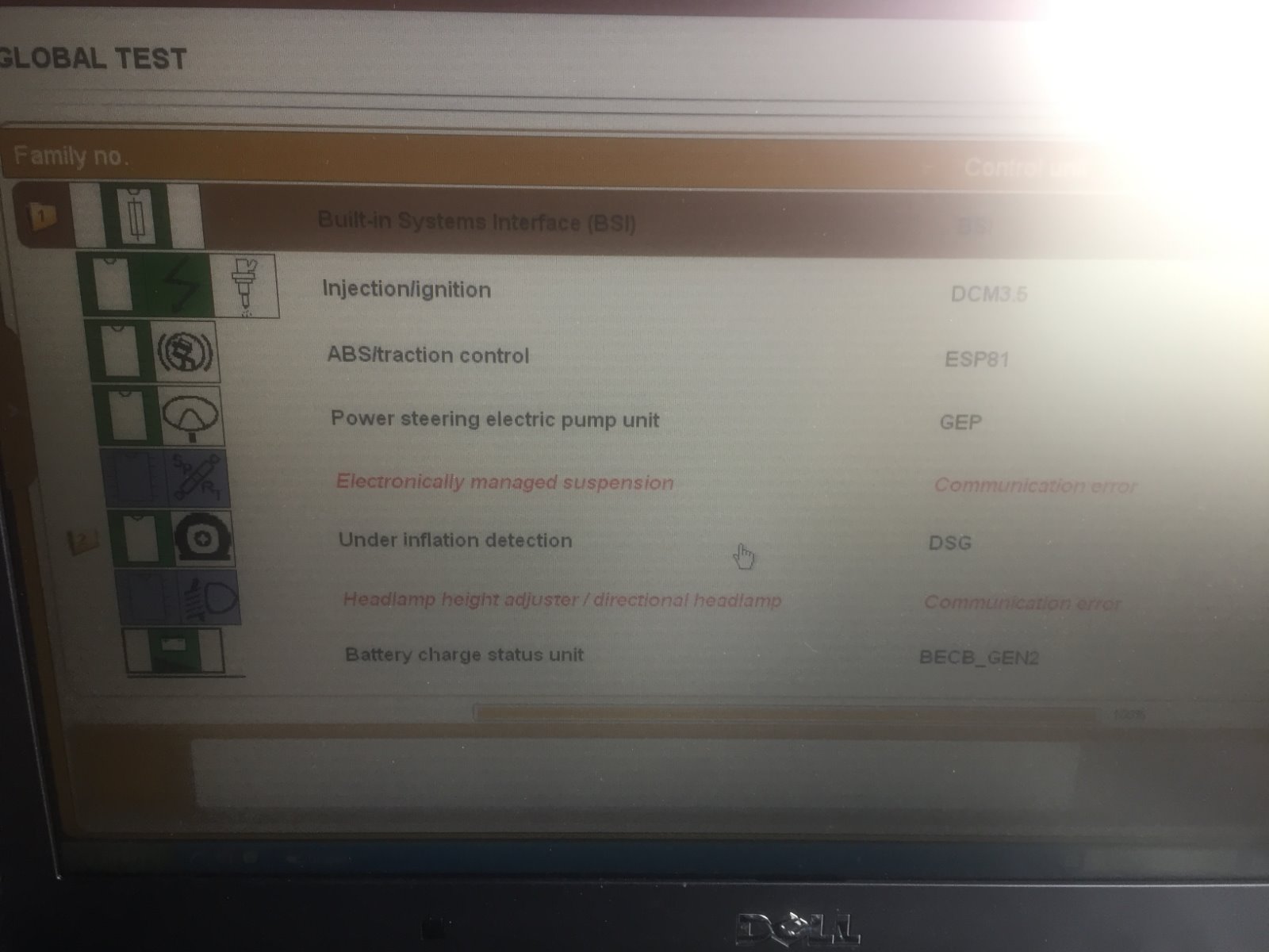

Marc,
Please find attached photo
global test screen shot
C3 1.4 petrol (SWMBO)
x 6953
Re: suspension ecu
That's probably it then. You don't have directional headlamps either and that also shows a comms issue - to be expected.

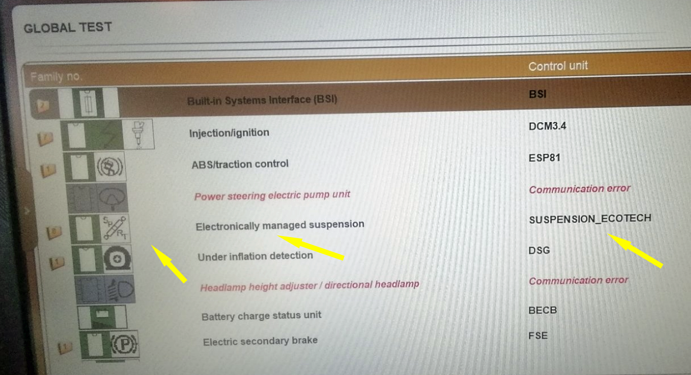

Re: suspension ecu
This is the suspension ECU you should have Kenny, arrowed in yellow:
