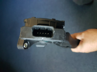

I'm pretty sure I've got a 1601V6 in the garage - I took it off my 307 when I scrapped it as someone was looking for one. I'll get a pic of the connector so that you can compare it with the one on your car.

Here's the numbers on mine, different to that you posted:
And the detail of the connector
By the looks of the ones on e-bay with your original number the connector is the same with 5 pins.

The connector looks very similar, but the overall structure is quite different! I'll probably have to wait until the w/e before I'll have a chance to look under the dash at the one fitted.
