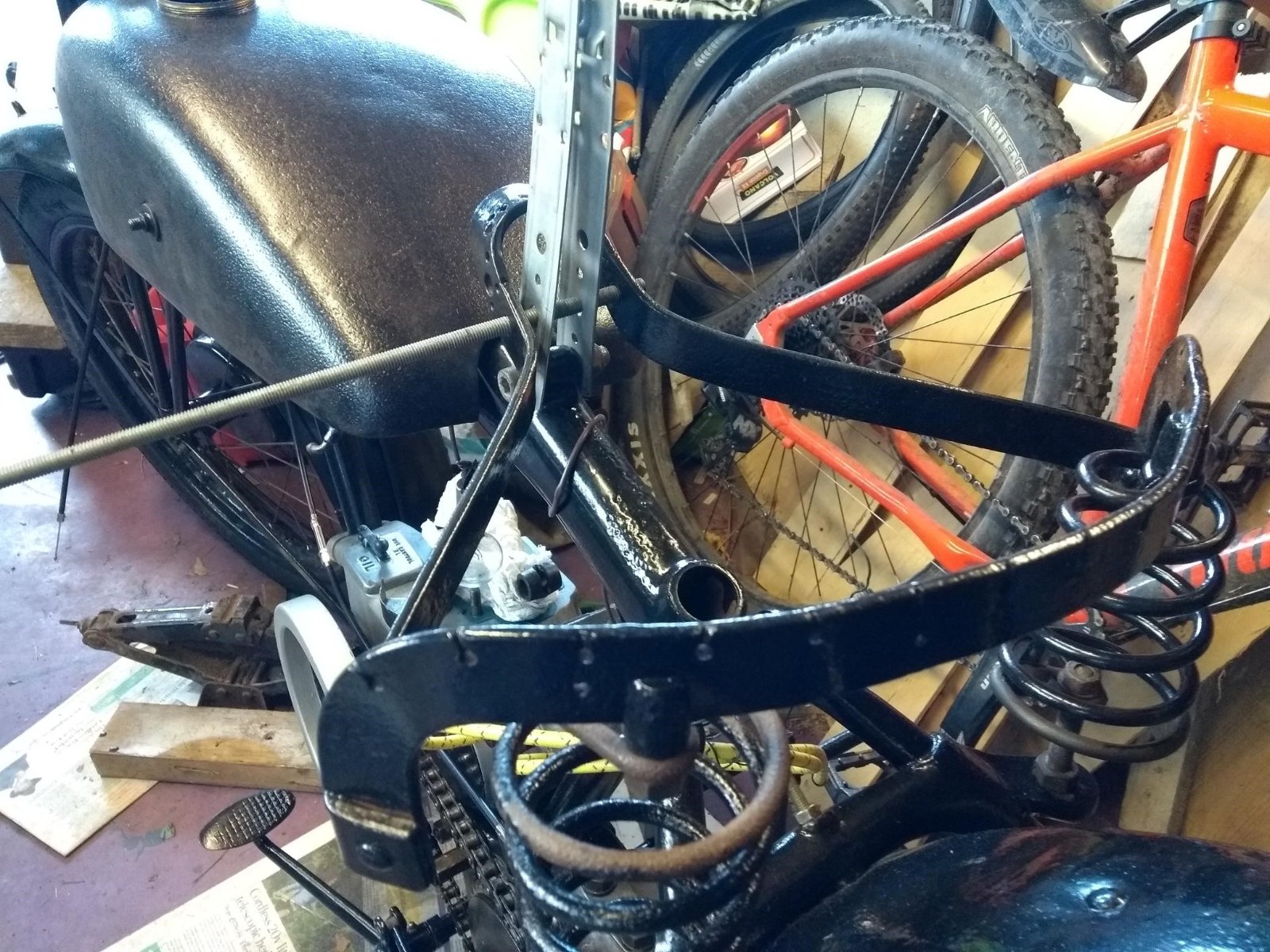

I rigged up the brakes and clutch. Brakes seem OK, clutch cable is too short really, there is no adjustment in it. So I will need to get a new inner and re-make it (I bought it as a complete unit, but I suspect it is for later machines). The throttle cable is too long, so that will need to be shortened. Going to need gorilla fingers to operate the clutch :lol: Then I moved on to the saddle front mount. Dug out a few bits, and lashed this up. I'll cut down the supports, and then the 8mm bar, will need to get some nuts to spread out the supports. Then I need to decide which way up to fit the springs (you will note they are opposite ways up!).

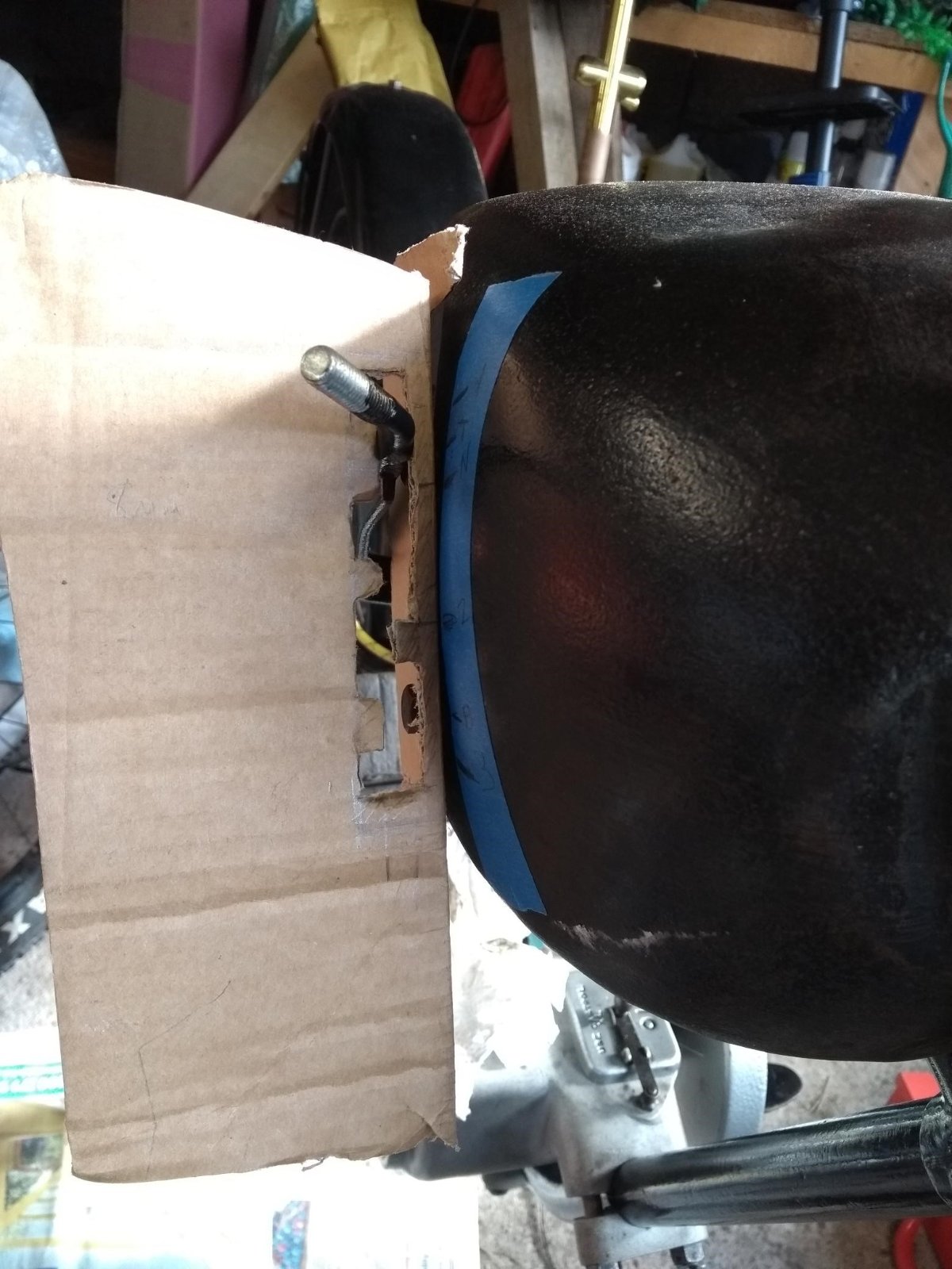

Next moved on to the gear change gate. Found a piece of old shelf bracket which was close to the right size. Mocked it up with some cardboard - pretty easy to feel where the gears are, and then I marked the positions on the blue tape on the tank.

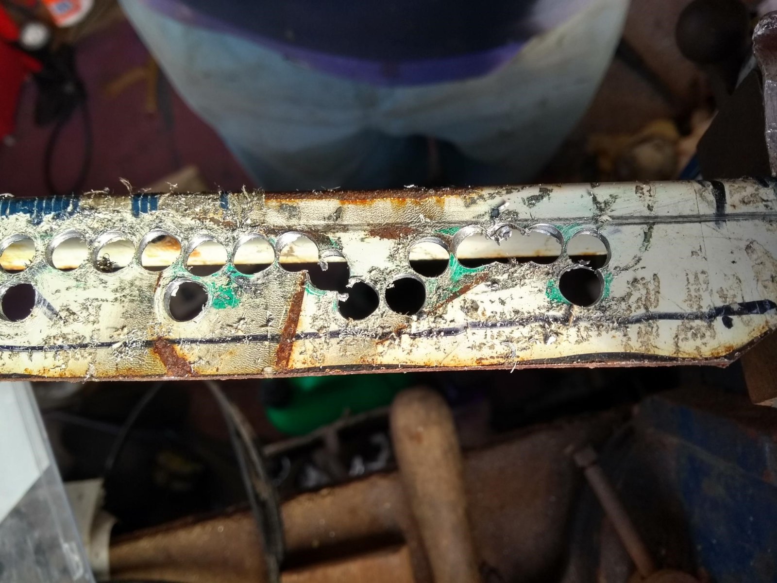

Moved it onto the steel and roughed it out with the pillar drill
Then after some effort with the files...
Wasn't really in the right place first time, and I couldn't get top - then realised I had done it with the adjuster on the gearchange (the bottom of the vertical link is threaded into the clevis pin) right at end. So I slotted the holes on the back for tank mounts, then adjusted the link to the centre, and it seems to be not far off now. I need to sort out the pivot, but I can do this when it comes back.

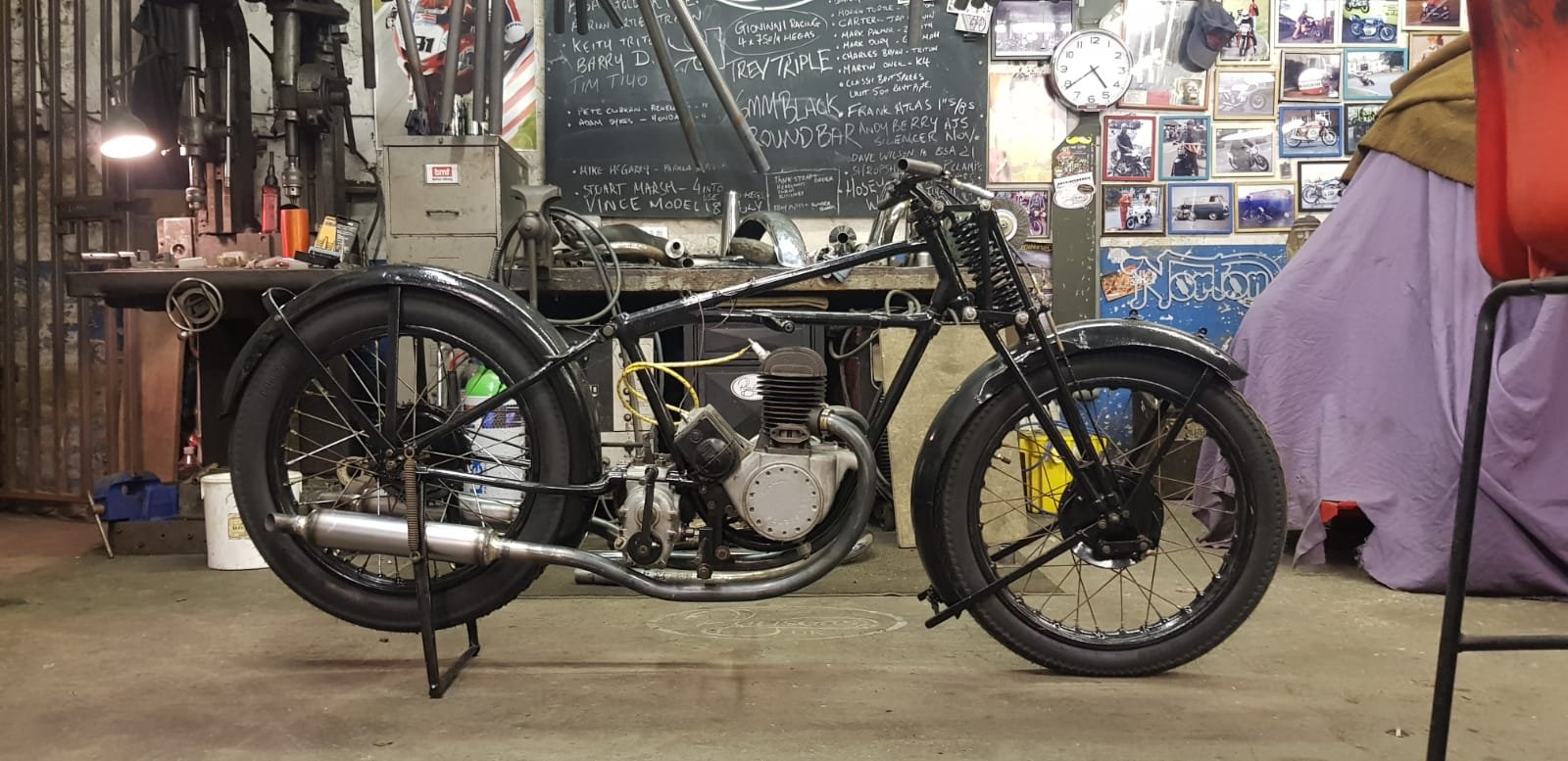

A long day out on Saturday saw the Velocette going on holiday to Whitworth, north of Manchester:
It's away to get the exhausts made. We took some friends with it in the van :lol: , and went for a ride near my parents in Kendal, then dropped into theirs for a curry before heading home. Having left home before 8 to pick the van up 20 miles away, came back and loaded the bikes set off about 10, didn't get back home till 11 having covered 420 miles (+ 10 miles on the bike!). Mercedes Vito - WTF is that foot operated parking brake all about???
I need to get on with painting the tank and other bits so I can assemble it all when I get it back (another 400 mile round trip to pick it up...!)

Progress on the exhausts
:-D

They look really good, how's the engine going? PS Love the Norton plaque, I worked there as a kid in Shenstone
Pete
Forum Treasurer
Posts: 12609
Joined: 07 Aug 2002, 17:12
x 1496
Re: RichardW's Velocette rebuild
Unread post by RichardW »
I've had new longer rings made, but as the bike has been away, not done anything with them. I'm hoping to go and get it this weekend / early next week to allow time for final assembly before we have its Birthday / renovation party on the 23rd. If the rings work, it might be a runner!
