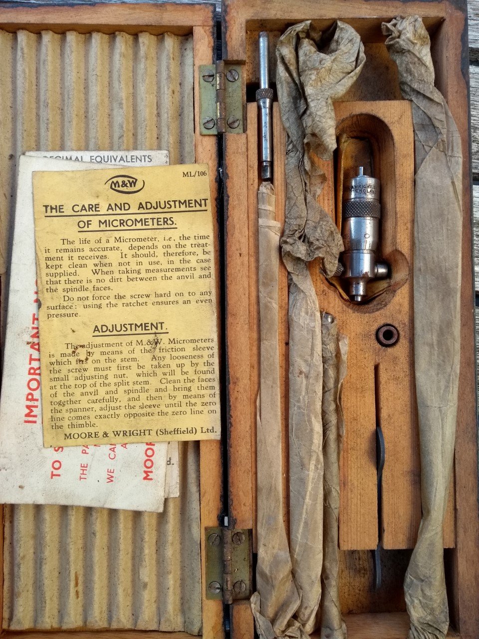

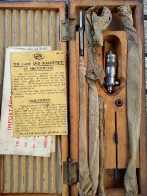

Can you find someone who can measure the taper on the bore (or get yourself a suitable micrometer), so that you can decide if a rebore/sleeving operation is really necessary?
- Posts: 12609
- x 1496
Re: RichardW's Velocette rebuild
What, using something like this...xantia_v6 wrote: 21 Sep 2019, 09:58 Can you find someone who can measure the taper on the bore (or get yourself a suitable micrometer), so that you can decide if a rebore/sleeving operation is really necessary?
Looked through the pile of measuring devices I inherited, and this was among them. I doubt I can get an accurate measure as I won't be able to turn the ring at the bottom, but I could probably get the feelers in down the side to get an idea of the bore change and any ovality.
