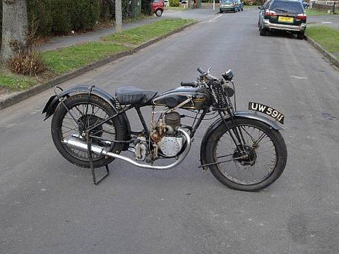

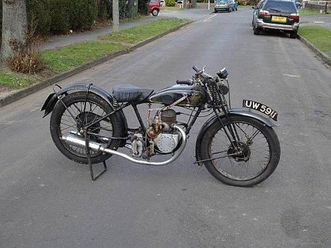

It's a 1929 Velocette Model U. It looks (or at least did when it was in one piece!) like this, although a good bit rustier:
Another one, sold a couple of years ago by Bonhams

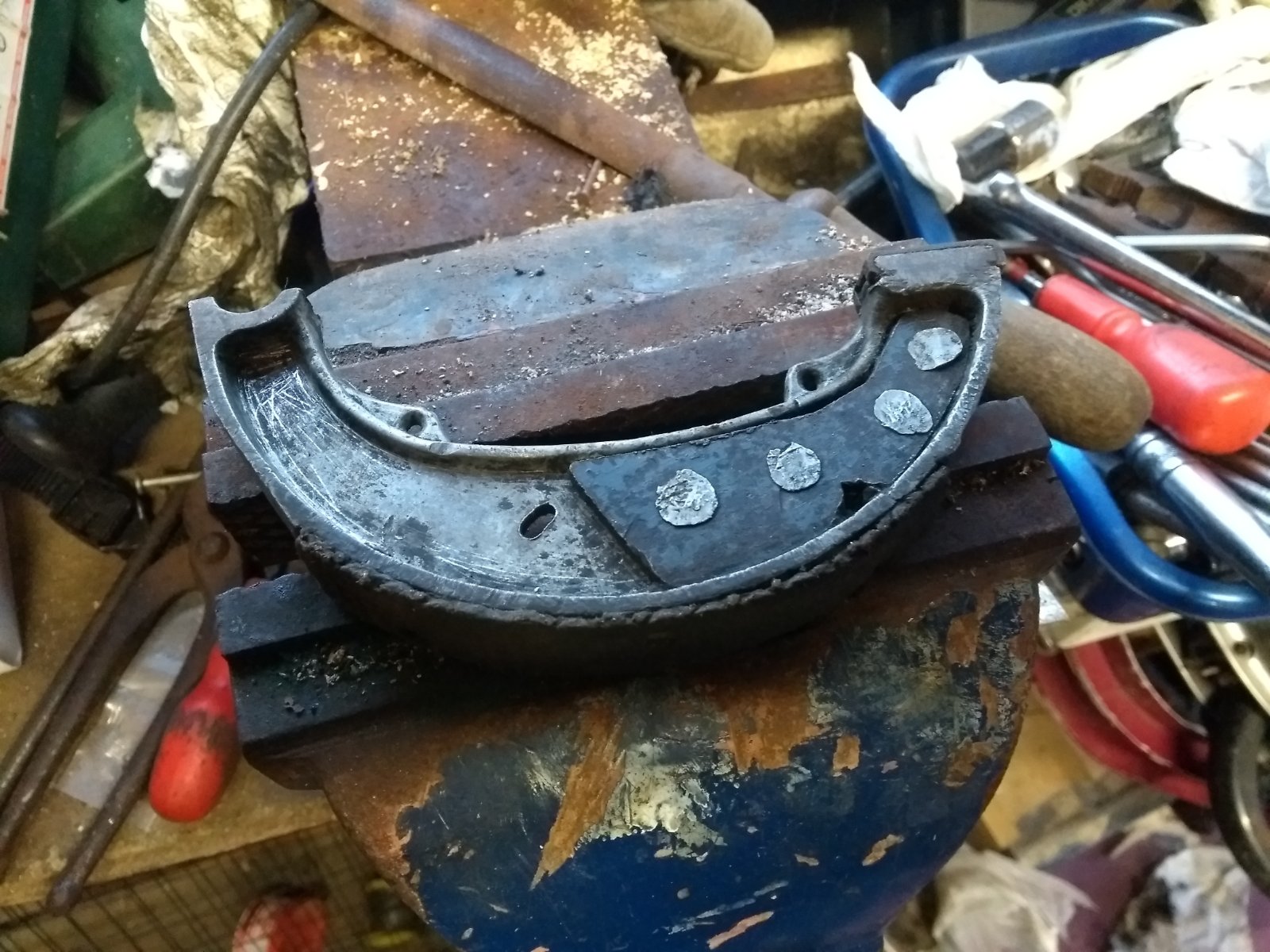

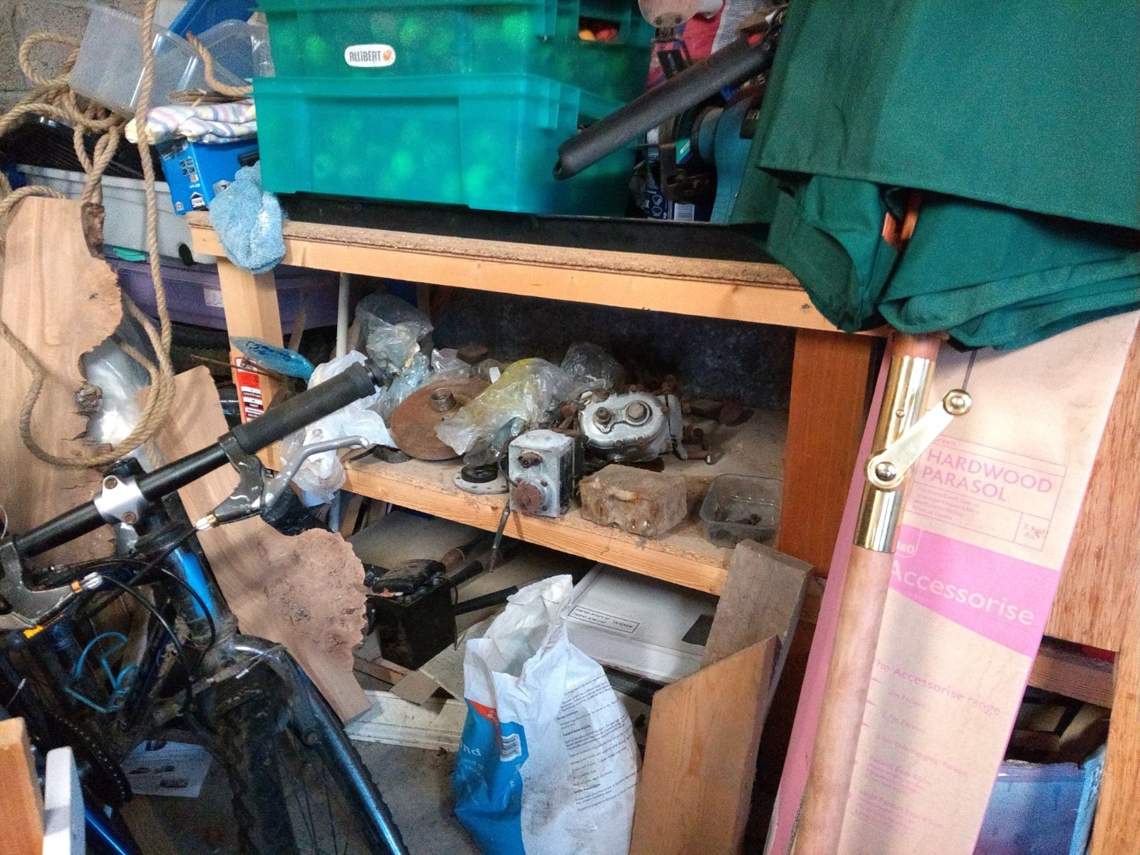

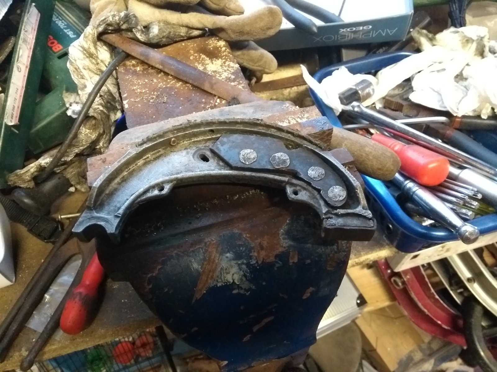

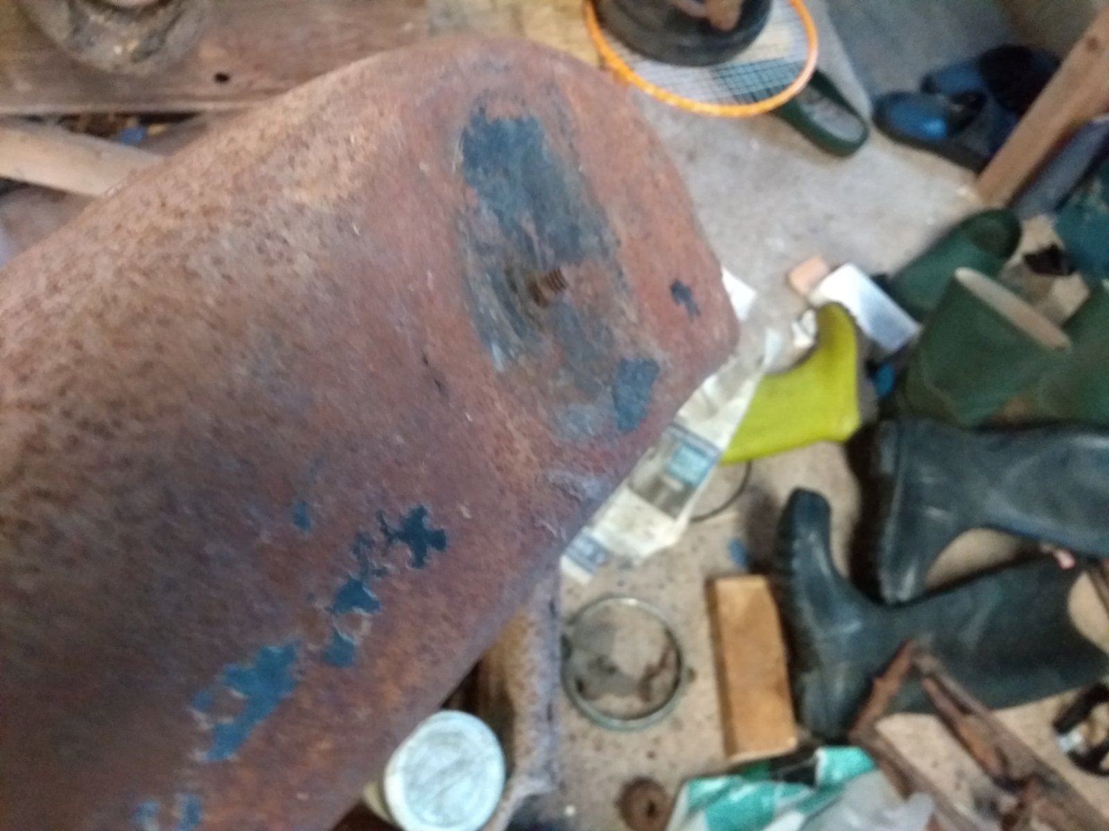

Had a look through the bits today. The forks definitely need an overhaul - there is significant wear on the spindles, and the bottom holes must be 2-3mm oval! It must have been pretty scary riding it in that state :shock: I also found some bits I didn't know I had - control cables and fuel pipes (there is a link pipe between the two sides of the tank) so that is a bonus. The saddle is likely saveable so that will retain some originality. I found the decompressor, and it looks to be complete - there is a tiny brass bolt which is broken, and I've written on the tag on the bag "note broken brass location bolt" - but I can't recall where it came from, and I can't see what it would do.... :(
Here is the bits in storage on a shelf!!
This is the dent in the tank. It's not that bad, so it will be staying I think.
A period home made repair to one of the rear brake shoes!!

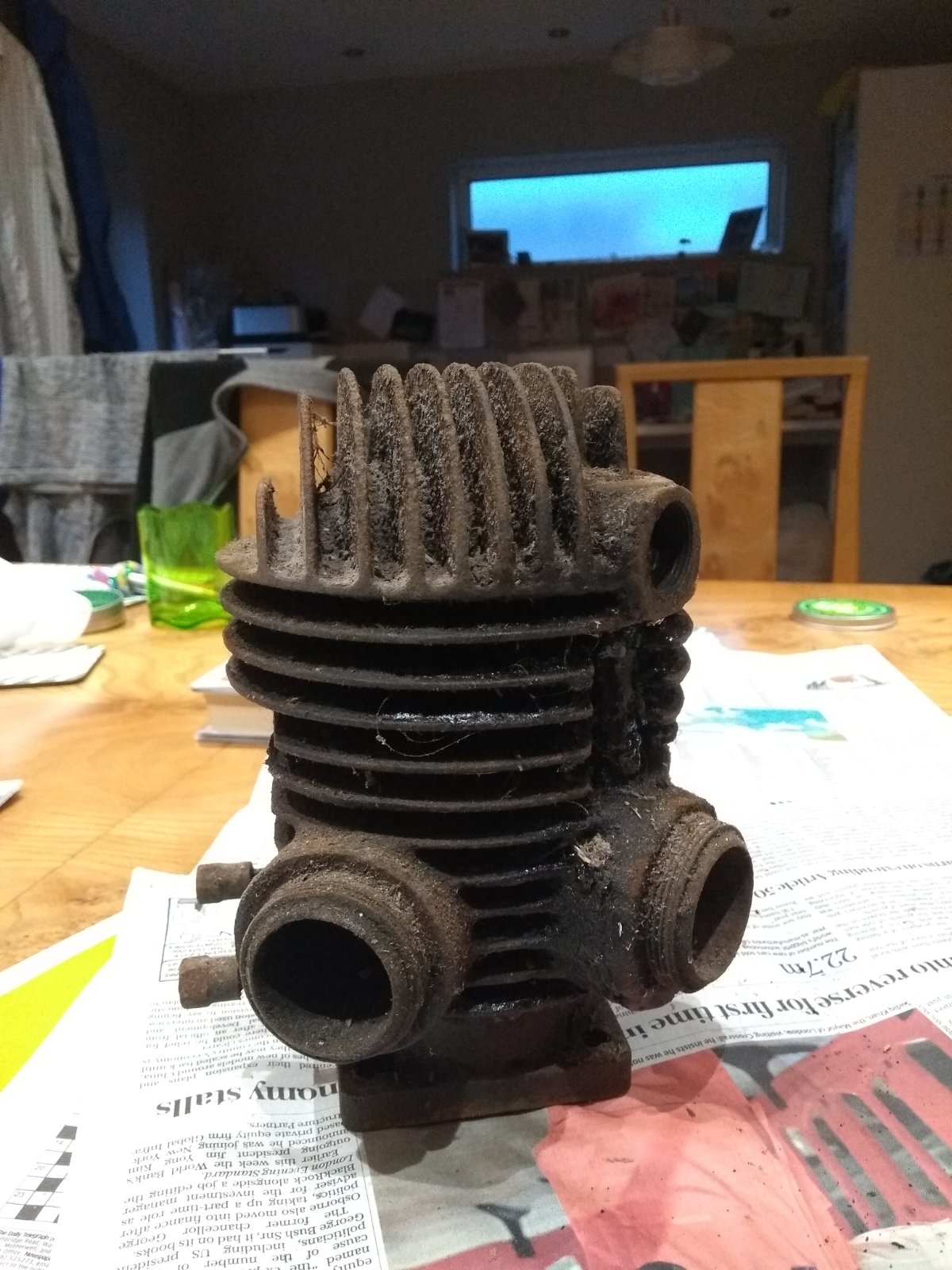

And the engine barrel / head, just because...
The firm that is going to do the engine work also makes piston rings, so sending the piston down there as well to get new rings made. Having looked through the bits, I had forgotten how much I had done, it's mostly just a case of getting all the bits done I couldn't do, painting some bits, and then putting it back together. Easy :rofl2:

What sort of magneto is that on your shelf, it looks to be an earlier design than the one on the Bonham's bike?

xantia_v6 wrote: 13 Jan 2019, 03:00 What sort of magneto is that on your shelf, it looks to be an earlier design than the one on the Bonham's bike?
It's a Maglita, Mike. It's a combined mag and dynamo - which had a pretty poor reputation, but it was a good solution for the time. AFAIK it's the original mag - I have the lights that go with it. Presumably it doesn't work too well, as the bike was fitted with a secondary dynamo when I got it - a home made pulley off the flywheel with a belt drive to an underslung dynamo (home made bracket!). Maglita info here: http://www.themagnetoguys.co.uk/maglitas I'm hoping that those guys will refurb it. There's also a period lead acid battery there, which has never been filled!

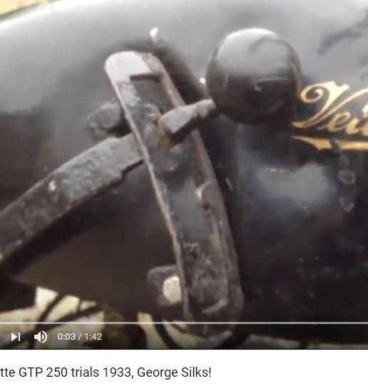

And here's a close up of the gearchange gate from a youtube vid of a slightly later GTP - should be easy enough to fabricate. Interestingly, that U above (which is 1927) does not appear to have a gate, but there are definitely tapped holes in the side of the tank for one on mine.....
