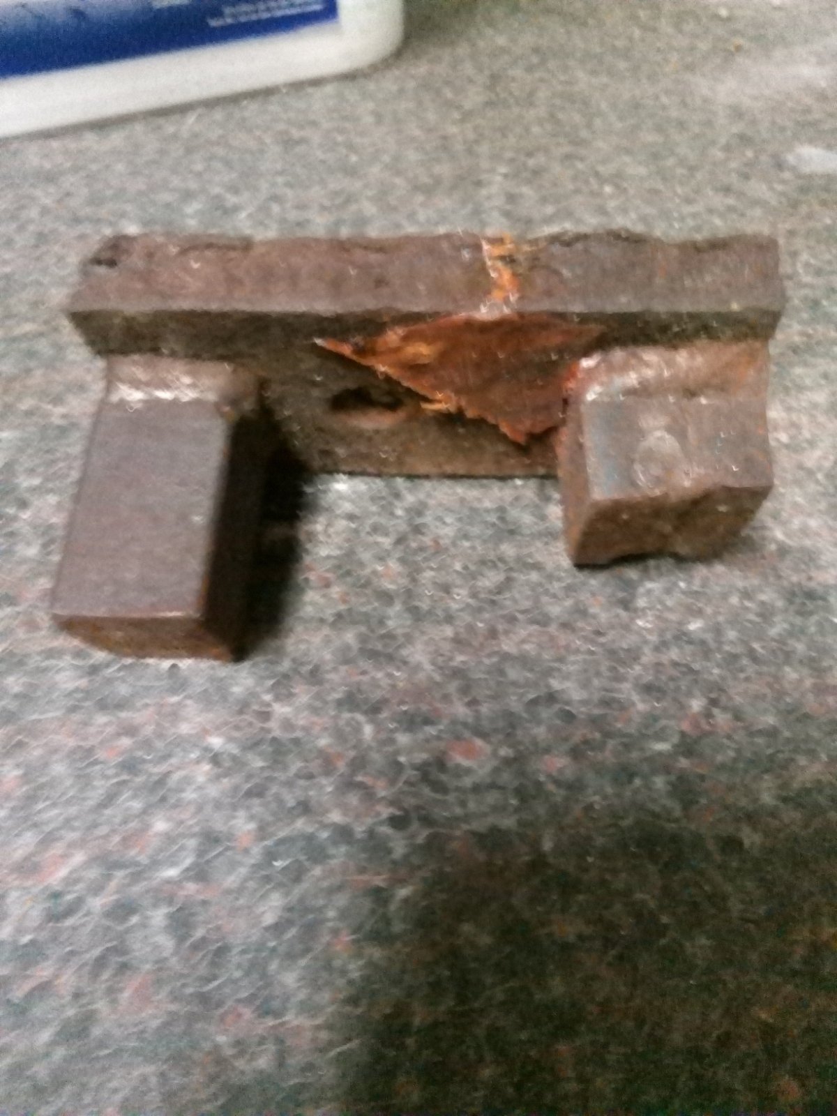

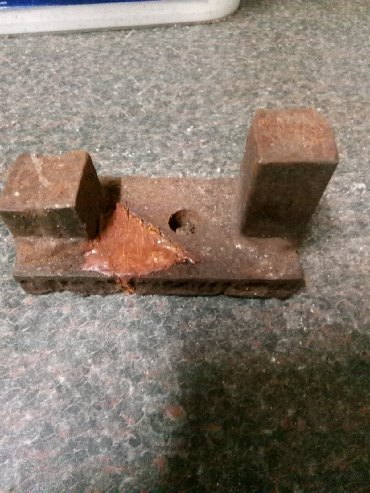

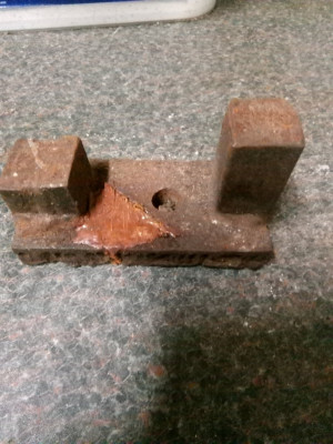

Can anyone work out what this homemade tool is for?

Maybe for lining up capping on the top of a wall?
Place longer leg against wall face with shorter leg level with capping and then position cap against shorter leg?

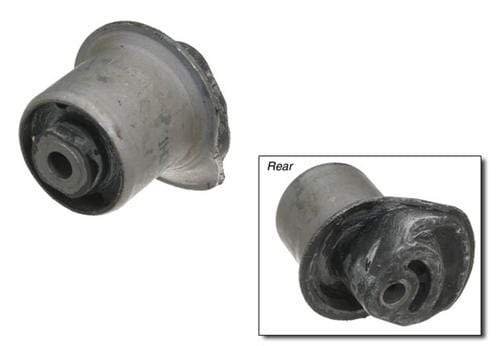

Its for pressing in the back axle bushing on a Mk3 vw golf. Nasty little bugger to get in. Needs must when the devil fits a bush on a Saturday evening without the proper tools

Ingenious suggestion!mickthemaverick wrote: 24 Sep 2019, 21:39 Maybe for lining up capping on the top of a wall?Place longer leg against wall face with shorter leg level with capping and then position cap against shorter leg?

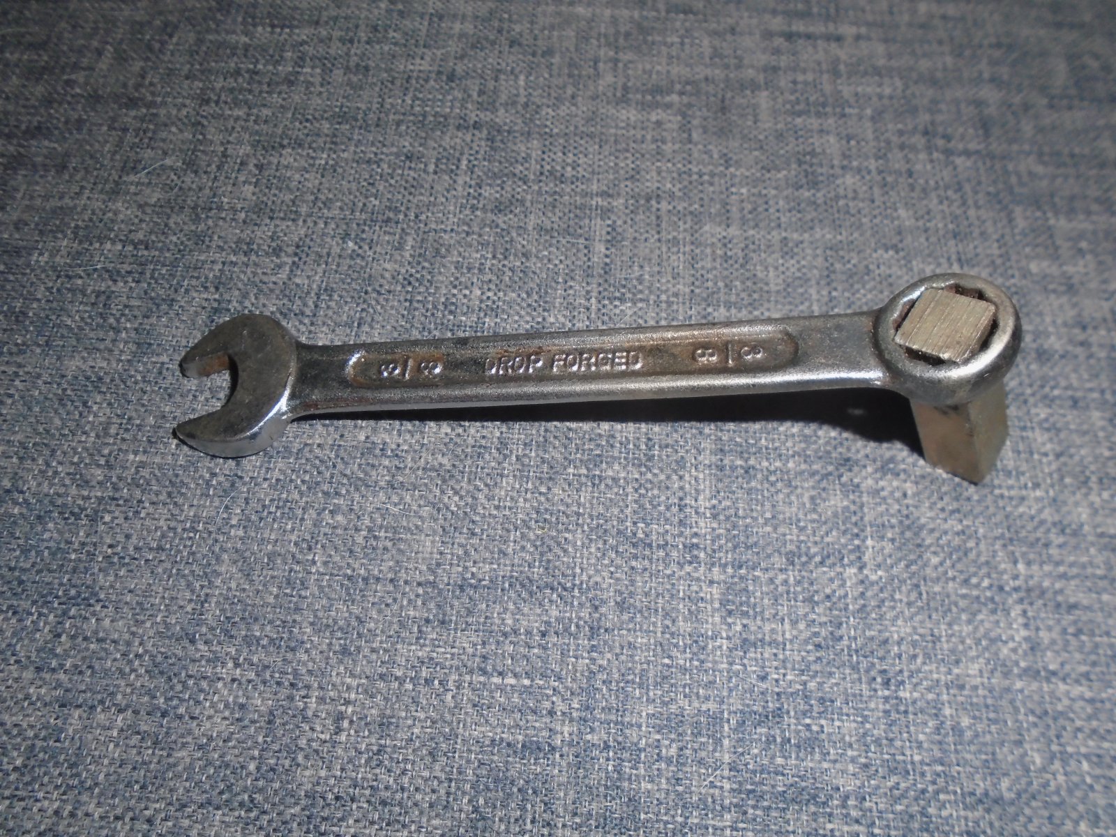

The end product to post number one on this thread.
A timing belt tensioner tool for a 2.0Hdi
