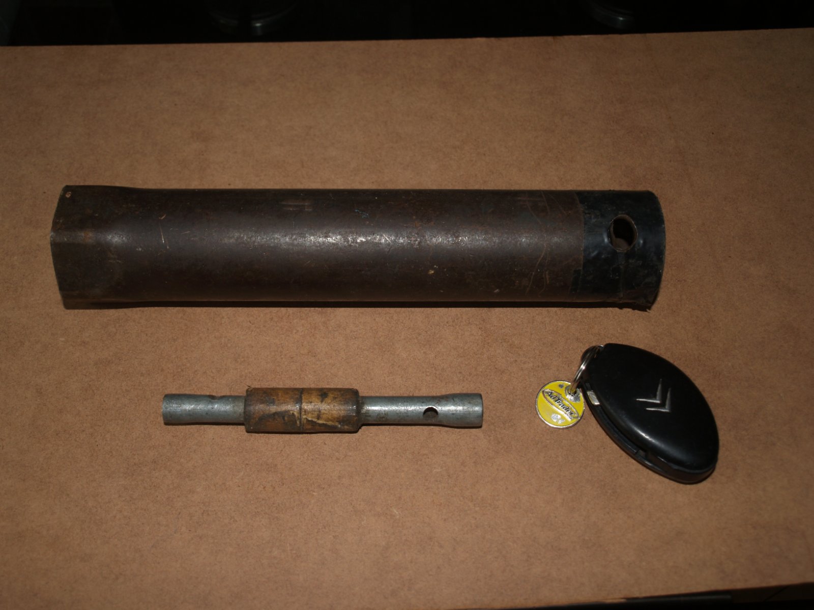

Found the Citroen specific one, used on the GS rear hub nuts.
Was ineffective as the nuts are , it the words of Sir Jim, Biblically Tight.
Discovered the official method was to smash them off with a cold chisel and fit new C-nuts and hex nuts and wind them up as tight as possible with the tube spanner - or a socket that I couldn't afford at the time.
Other one and key fob for scale, although some of my dad's tools would dwarf it.
