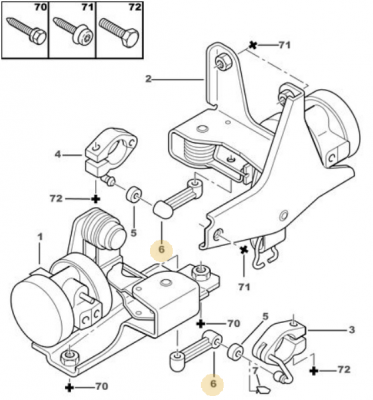

Hello, does anyone have the part number for the front height corrector linkage. The part with the split collar that clamps to the anti-roll bar? Number 3 in the second picture here:

Re: Front Height Corrector Part Needed.
Part No: 529103, priced £4.31 from Citroen inc. VAT - still showing as available.

Thanks a lot. Cheap too.
Edit: it's the part in the accompanying diagram, part # 3, not the part that the seller is selling.
I think it is: 529113 ?
The part I quoted was Item (6) below - if not this, let me know what item yo do need.
Items 3 and 4 are no longer available and the part numbers are different - so if you still need the number, pop your VIN up.
Yes, I've found out part 3 is no longer available. That is the part I need.
I'll repair this one. Part number is definitely 529113 for item 3 same for all Xantias with non-hydractive. Thanks.
They're actually not - there are 2 possibilities for a non ARCS system...
529113 (Diameter 22)
529114 (Diameter 23) - Estates and (XU10J4 engines to 31/05/1995)
If anyone has a 22mm used one they don't need, or even a 23 mm (I'll machine a sleeve) then I would be happy to buy. Thank for your in-depth replies, moderator.
