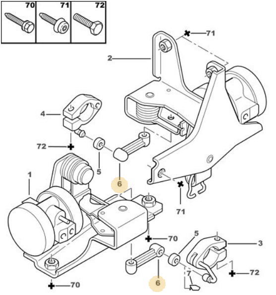

The part I quoted was Item (6) below - if not this, let me know what item yo do need.

Items 3 and 4 are no longer available and the part numbers are different - so if you still need the number, pop your VIN up.

Yes, I've found out part 3 is no longer available. That is the part I need.
I'll repair this one. Part number is definitely 529113 for item 3 same for all Xantias with non-hydractive. Thanks.

They're actually not - there are 2 possibilities for a non ARCS system...
529113 (Diameter 22)
529114 (Diameter 23) - Estates and (XU10J4 engines to 31/05/1995)
