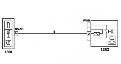

Start with the easy things first like the electrical supply to the EGR valve: P2143 indicates the fault is 'Open Circuit', so look at the last row in the table for the Open Circuit check. 1320 is the Engine ECU, specifically the 48 pin black connector, Pin marked 'A4'. 1253 is the EGR, - Pin 2 shows the wire 'B' to check.
Conditions under which the fault appearsConditions for checkingChecks to be made
Short Circuit to positive:- Engine running: Short circuit to positive on terminal(s) A4 of connector 48V.NRIgnition on, Control unit disconnected, EGR solenoid valve disconnected, Check :- No voltage on terminal A4 of ECU 1320
Short Circuit to earth:- Engine running: Short circuit to earth terminal(s) A4 of connector 48V.NRIgnition off, Control unit disconnected, EGR solenoid valve disconnected, Check :- No earth at terminal(s) A4 on the 48V.NR connector
Open Circuit:- Engine running: Open circuit on terminal(s) A4 (48V.NR)Ignition off, Control unit disconnected, EGR solenoid valve disconnected, Check :- Continuity and insulation of wire B

The wire-B check went okay; no findings.
