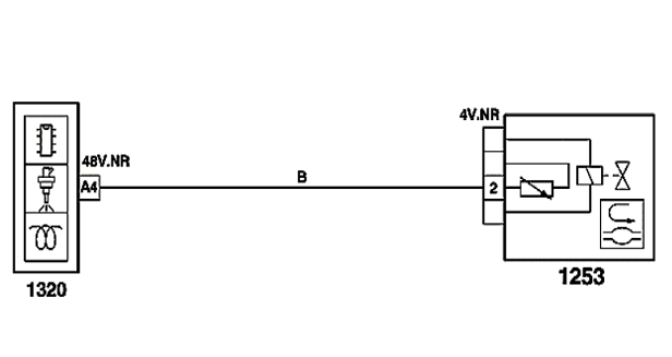

Start with the easy things first like the electrical supply to the EGR valve: P2143 indicates the fault is 'Open Circuit', so look at the last row in the table for the Open Circuit check. 1320 is the Engine ECU, specifically the 48 pin black connector, Pin marked 'A4'. 1253 is the EGR, - Pin 2 shows the wire 'B' to check.
| Conditions under which the fault appears | Conditions for checkingChecks to be made |
| Short Circuit to positive:- Engine running: Short circuit to positive on terminal(s) A4 of connector 48V.NR | Ignition on, Control unit disconnected, EGR solenoid valve disconnected, Check :- No voltage on terminal A4 of ECU 1320 |
| Short Circuit to earth:- Engine running: Short circuit to earth terminal(s) A4 of connector 48V.NR | Ignition off, Control unit disconnected, EGR solenoid valve disconnected, Check :- No earth at terminal(s) A4 on the 48V.NR connector |
| Open Circuit:- Engine running: Open circuit on terminal(s) A4 (48V.NR) | Ignition off, Control unit disconnected, EGR solenoid valve disconnected, Check :- Continuity and insulation of wire B |

Re: EGR-related error codes
The wire-B check went okay; no findings.
Be sure to examine the pins closely - sometimes the pin can settle back in the plug and lose contact.
Sorry it took me a while, but I was on the road.GiveMeABreak wrote: 24 Aug 2019, 20:00 Be sure to examine the pins closely - sometimes the pin can settle back in the plug and lose contact.
As far as the plug is concerned, the pins are firm.
