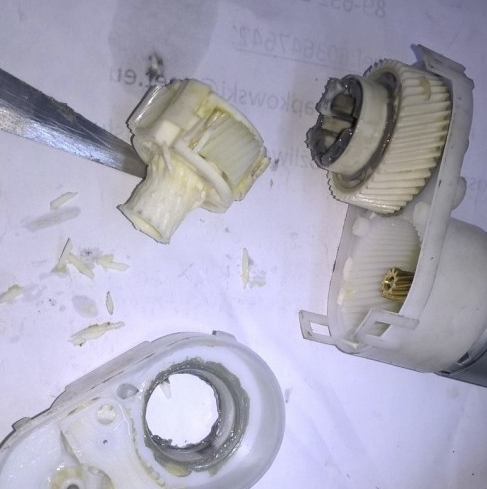

Our Polish friends have undertaken repairs it seems from this link - the pictures show some of the replaved parts:
https://allegro.pl/oferta/linka-hamulec ... 7441098760
From the looks of it, good old reliable plastic gearing again - completely shredded
Unless he's shaven the plastic with the knife in the picture:

If he has a source for replacement plastic gearing then that's quite impressive. OTOH if i's just a cable needed then, if I were in such a position, I'd be doing the rounds of cable manufacturers.

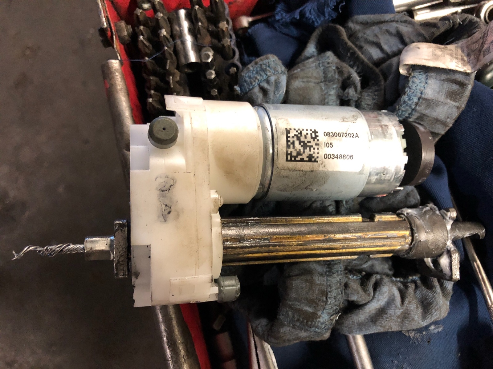

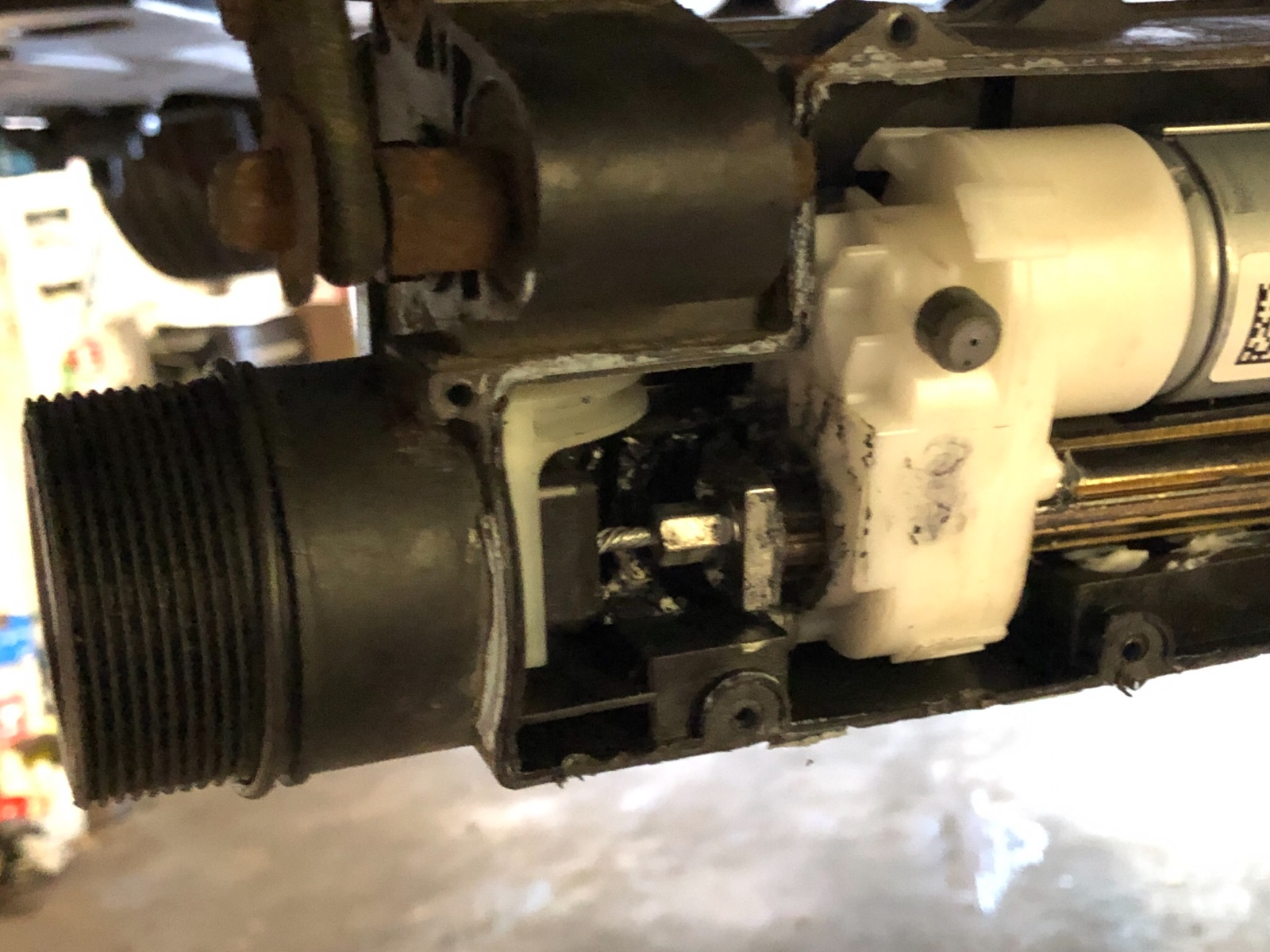

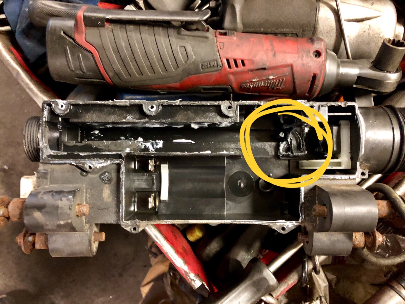

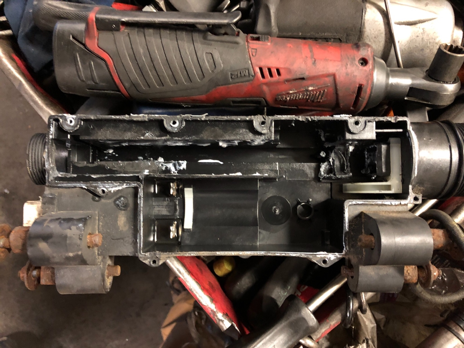

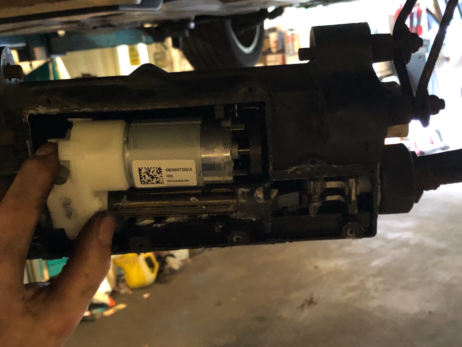

Whilst the car was on the ramp at a Lloyds we managed to remove the cover from the EPB unit. It’s sealed with an adhesive as well as screwed so use of a heat gun was required
Removing the cover allowed the broken cable to be seen and the remaining cables removed so the unit could be taken off the car.
When removed, it could be seen that a retainer supporting the drive screw had broken, potentially allowing misalignment which caused (or helped) the cable to break.
Here’s the drive screw showing the snapped nearside cable. It isn’t a simple matter of unscrewing the hexagon.
Whilst I’m prepared to try our Polish friend I don’t know whether he can repair the housing (I’ve sent photos asking this). The timing is unfortunate as it’s a Bank Holiday so nothing’s going to happen until Tuesday, the MOT expired today and I need the car for holidays on a September 2nd, so I may be forced to buy a Citroen part. C’est la vie as we say in Wales.
On the bright side, I hope the photos and the contact with the Pole will be useful to someone: lincar@op.pl

- x 6957
Re: C5 X7 2.0 hdi auto electronic parking brake problem
Crikey, what a mess Steve!
If you're going for an OEM part - give them a call at the earliest (parts usually open before 12 on Saturday), as sometimes they have to order parts in from France directly - so could be a wait there. Or try one of the others I linked to that was slightly cheaper.
- Posts: 9344
- x 1942
That hexagon looks like a crimp holding the inner cable onto a moving part. It's a bit difficult to make out much more as the Photobucket watermark obscures so much!Y Cymro wrote: 23 Aug 2019, 18:39Here’s the drive screw showing the snapped nearside cable. It isn’t a simple matter of unscrewing the hexagon.

Thanks to Myglaren I’ve posted better photos. Should be a little more legible now without the Photobucket ransom watermarkPaul-R wrote: 23 Aug 2019, 18:54 That hexagon looks like a crimp holding the inner cable onto a moving part. It's a bit difficult to make out much more as the Photobucket watermark obscures so much!

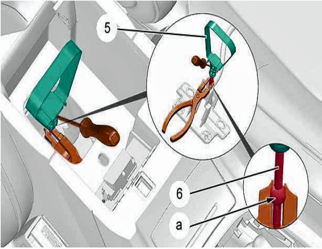

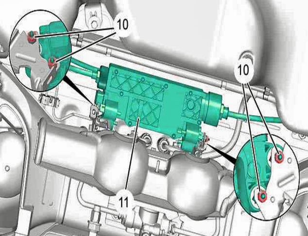

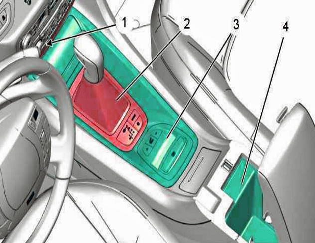

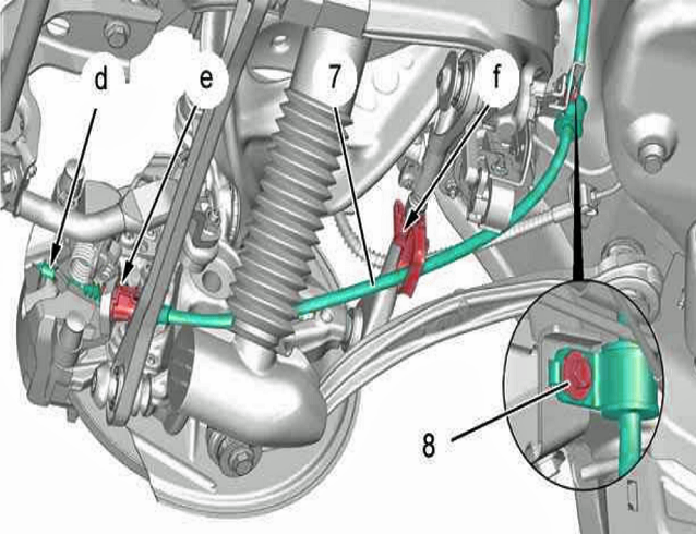

Procedure for removing and refitting the Electronic Parking Brake in the Citroen C5 X7
Note: Diagbox or a suitable diagnostic tool is recommended to place the handbrake in the removal position (for removing procedure) and again after refitting for the Calibration Procedure.
Removing
Refitting
Refit: The electric secondary brake unit (11).
Tighten the nuts (10) to 0,8 ± 0,2 daN.m.
Connect the connector (at "g").
Refit the protector (9).
Caution: Respect the routing of the manual unlock cable (6) and of the parking brake cables (7).
On each side:
Engage the electrically controlled parking brake manual unlock cable (6) in its housing (at "b").
Immobilise the electrically controlled parking brake manual unlock cable (6) (at "a") ; Using universal pliers .
Couple that handle the (5) to the electrically controlled parking brake manual unlock cable (6).
Refit: The underbody protectors (8) and (7).
Return the vehicle to its wheels.
Refit:
Refit: The glove box (1).
Reconnect the battery.
Caution: Before carrying out the handbrake calibration procedure, ensure that the ferrules of the hand brake cables (7) are correctly positioned in the caliper levers (at "d").
Carry out the electric parking brake calibration procedure, using a diagnostic tool.
Activate the electric handbrake control.
Check the immobilisation of the wheels.
Perform the operations to be carried out following reconnection of the battery.
Removing
- Slacken the parking brake.
- Raise and support the vehicle, with the rear wheels hanging free. (Warning: Refer to correct Lifting Procedure where wheels will be hanging freely:
LDS Tank / Lifting Warning - Place the electric parking brake in the removal position, using a diagnostic tool.
- Disconnect the Battery (danger of automatic re-application during removal procedure)
| Remove the glove box (1). Unclip The gear lever gaiter (2). Remove:

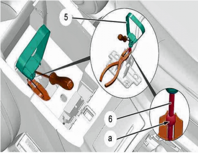

| Pull the handle (5). Immobilise the electrically controlled parking brake manual unlock cable (6) (at "a"), using universal pliers . Uncouple the handle (5) from the electric parking brake manual release cable (6), by means of a screwdriver. |

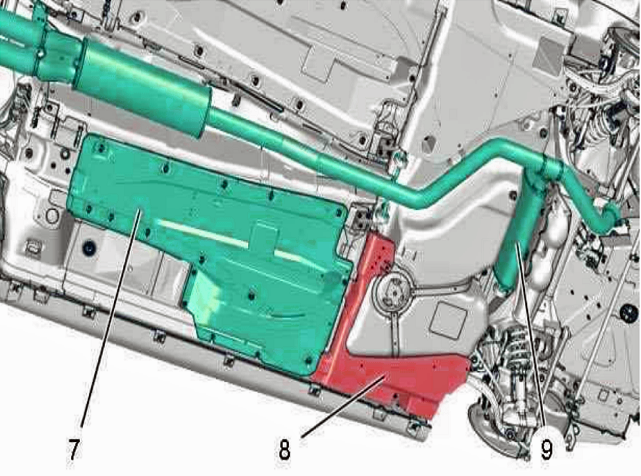

| Remove the under body protections (7), (8). | Extract the electrically controlled parking brake manual unlock cable (6) from its housing (at "b"). Unclip the electrically controlled parking brake manual unlock cable (6) from the fuel tank (at "c"). |
On each side:

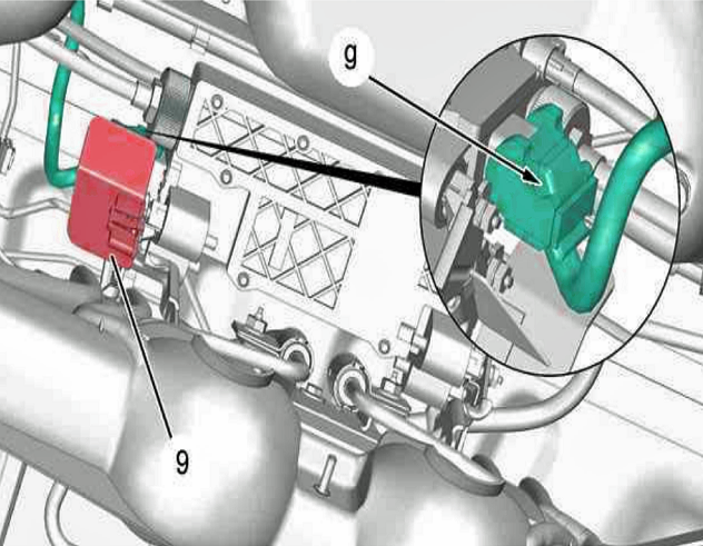

| Remove the protector (9). Disconnect the connector (at "g"). |
| Unscrew the nuts (10). Remove: The electric secondary brake unit (11). |

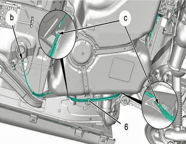

On each side:

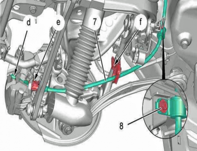

- Position: The handbrake cable (7)
- Clip the guide of the parking brake cable (7) (at "e", "f")
- Couple the parking brake cable (7) (at "d")
- Refit bolt (8) ; Tighten to 0,8 ± 0,2 daN.m
Refit:
- The oddments tray trim (4)
The centre console fascia trim (3)

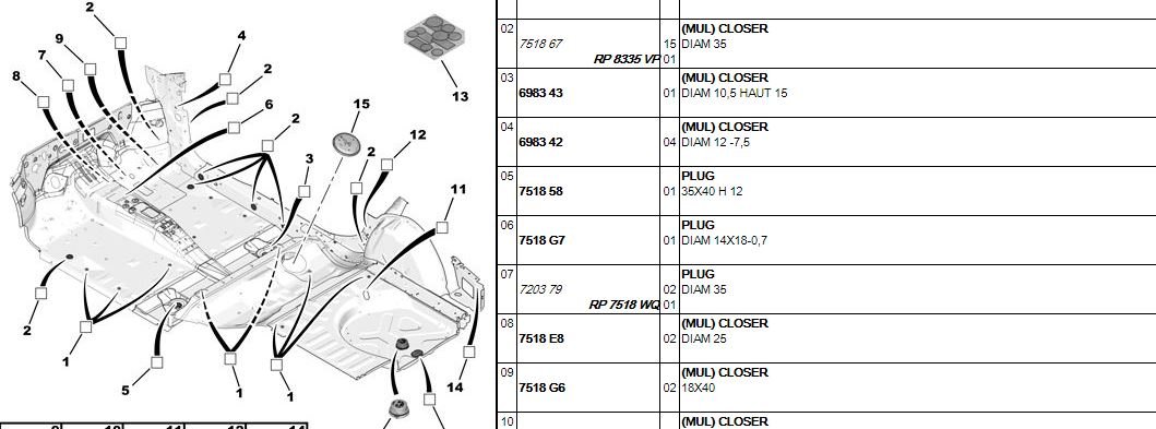

It does look like they have deleted the manual release cable. Here is the latest item on e-bay, showing only the brake cables: EPB Mech
In the parts list it says with the latest unit that you should also take this item: 73
6983 43
01
(MUL) CLOSER
DIAM 10,5 HAUT 15
Which is presumably a plug to put in the hole where the cable no longer is - it's not shown on the parts dia for the handbrake - but I found it on the body blanking dia, item 3:
In the handbook for later cars, there is no mention of the manual release. So it would appear that it is so reliable that it never needs a manual release
And if the battery goes flat, then you're stuffed - unless you chop the cables off and front up another grand to PSA
