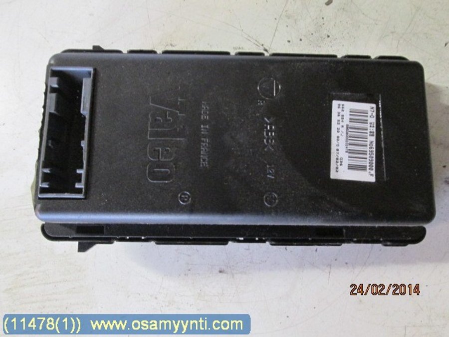

Hello guys,
my motor and the resistor is good, I tried it by a potenciometer but I cant controlled in the cocpit. I measured the voltage levels in the socket the yellow and the orange wire but it didnt changed when I turn the button.
Please help me by a good wire diagram if its possible.
But the most important thing. There is this part somewhere but I dont know where: Can you help me that where is it?
