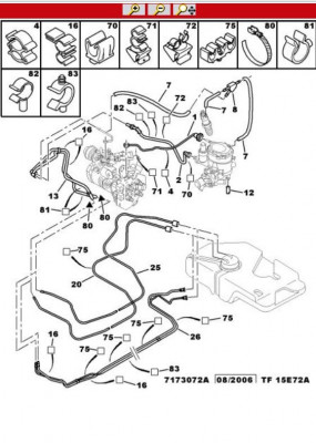

Thank you so much for that. It's the S shaped pipe on the bottom picture with the number 3 connector. Do you have a diagram of the pipes from the fuel filter housing?

Fuel pipes...

Thanks again for the quick reply. The Pipes in my fingers come from the fuel filter housing and the pipe on its own is the vacuum pipe in question

The pipe with the clip appears to be number 12 on the fuel diagram

I now know that the pipe I had connected to the clip is the drainage pipe. I was deceived as it fits very snug on the clip.
