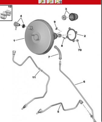

Hopefully this is the right one. Post your VIN and we can confirm (it will hide itself).
Brake vacuum
Emissions control vac
Brake vacuum
nikplume
- Posts: 10
- Joined: 03 Aug 2019, 12:34
Re: Where does the vacuum pipe go??
Thank you so much for that. It's the S shaped pipe on the bottom picture with the number 3 connector. Do you have a diagram of the pipes from the fuel filter housing?

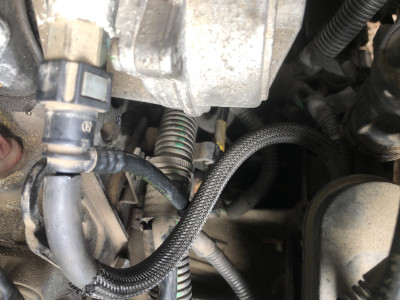

Thanks again for the quick reply. The Pipes in my fingers come from the fuel filter housing and the pipe on its own is the vacuum pipe in question
nikplume
- Posts: 10
The pipe with the clip appears to be number 12 on the fuel diagram
nikplume
- Posts: 10
I now know that the pipe I had connected to the clip is the drainage pipe. I was deceived as it fits very snug on the clip.
