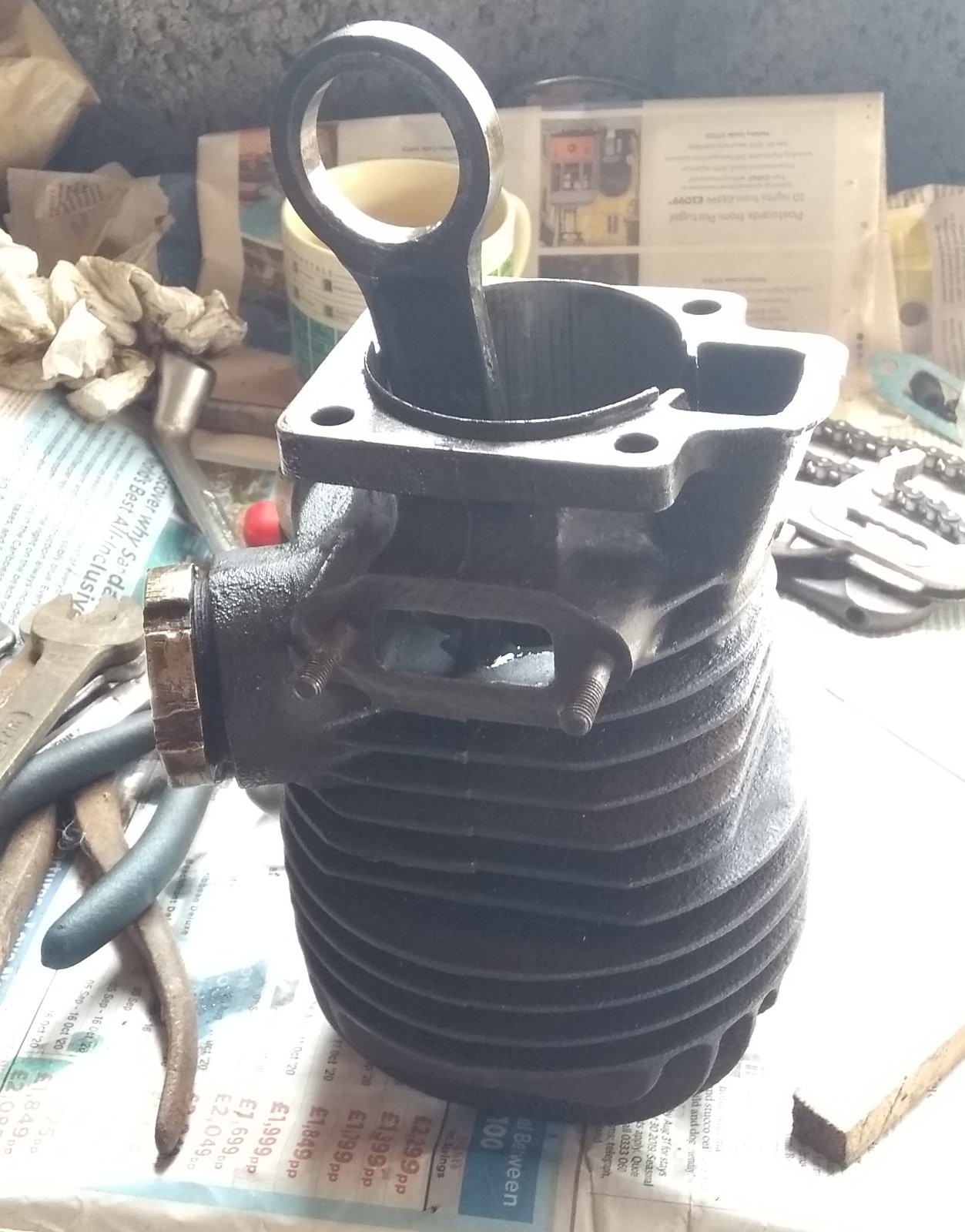

I got the circlips fitted to the gudgeon pin yesterday (just a slight injury to one thumb from slipping screwdriver!) so the piston was reconnected to the conrod. In the evening I made gaskets for the cylinder and carb
So, then I could insert the piston into the cylinder

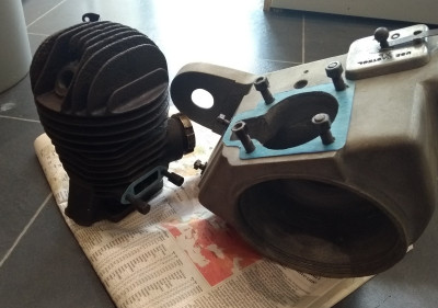

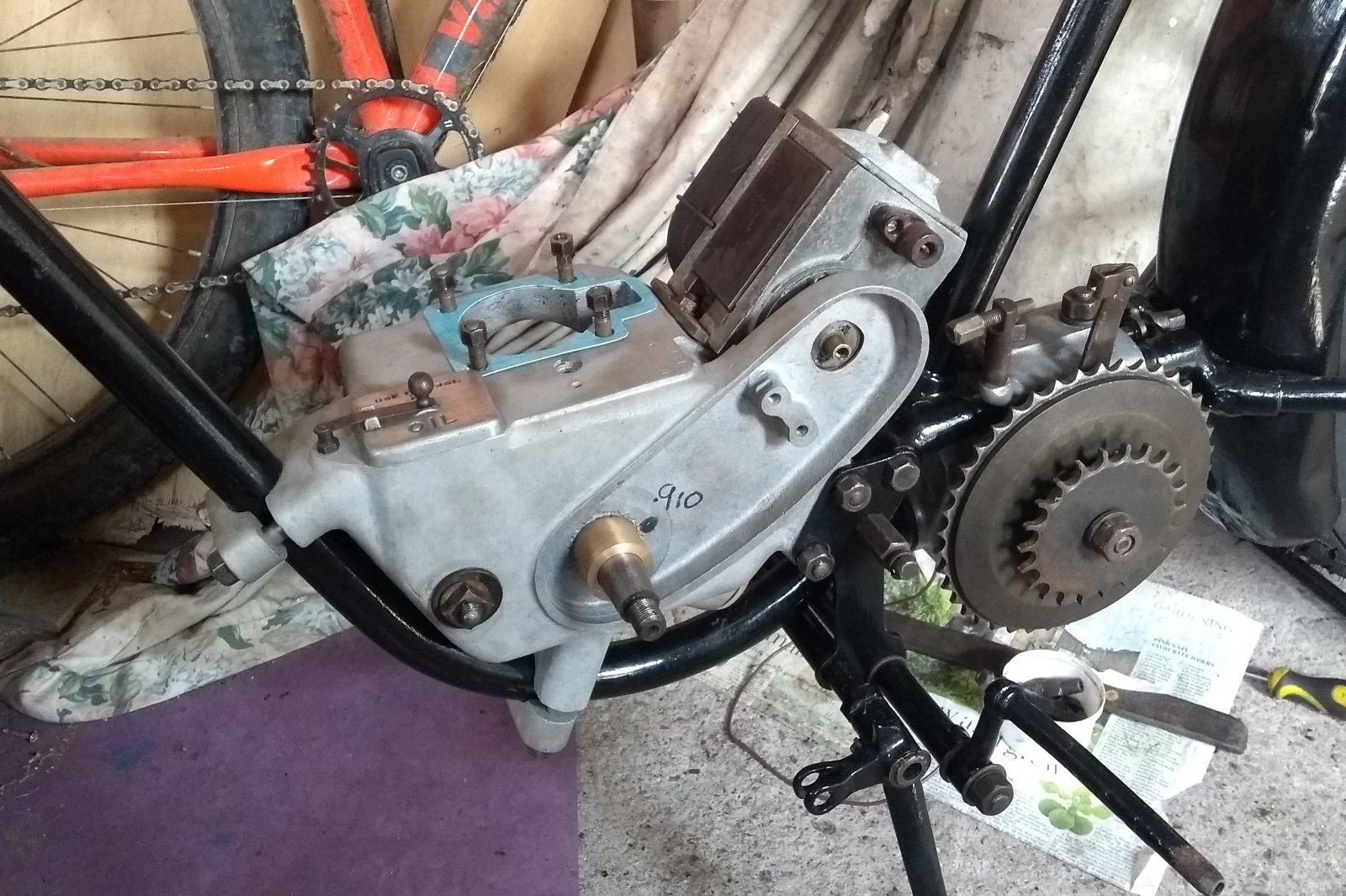

Ready to fit to the crankcase. I had the crankcase back in the frame, but then looking at it I remembered that it was difficult to get the nuts on the mag bolts with the engine in the frame - in fact it's impossible to get on the rear bolt, so crankcase out, mag fitted and back in.

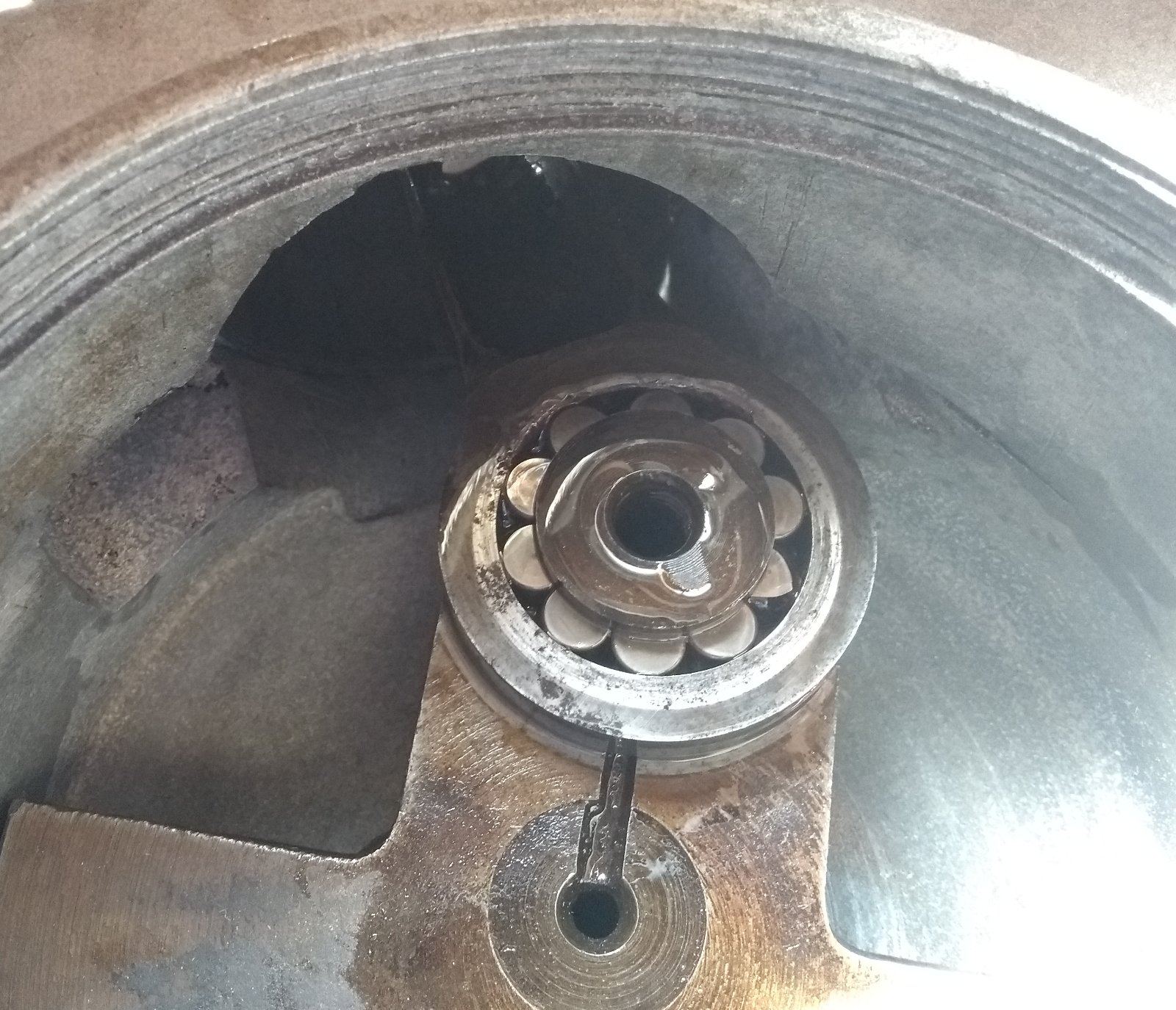

Then I dropped the cylinder on, so I could refit the rollers in the big end

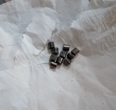

Some of these are in better conditions than others....!
However, soon becomes apparent that all the rollers need to be fitted to the crankshaft before the con rod is dropped over, that's going to be difficult with the crankcase in, so out it came again.... Easy enough to fit the rollers and then the conrod once on its side on the bench

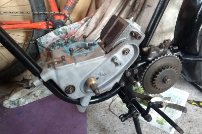

Then back in the frame - unexpectedly it needs to go in from the nearside (the cylinder is off set to the off side) as otherwise it fouls on the mount for the gearchange. On with the flywheel and mag drive chain, then I could set the timing. I eventually found my feeler gauges to set the points gap, but they're metric, so had to work out 10 thou equivalent! I was wondering how I was going to get the very small nuts undone, but whilst looking for the feelers, I found this spanner set

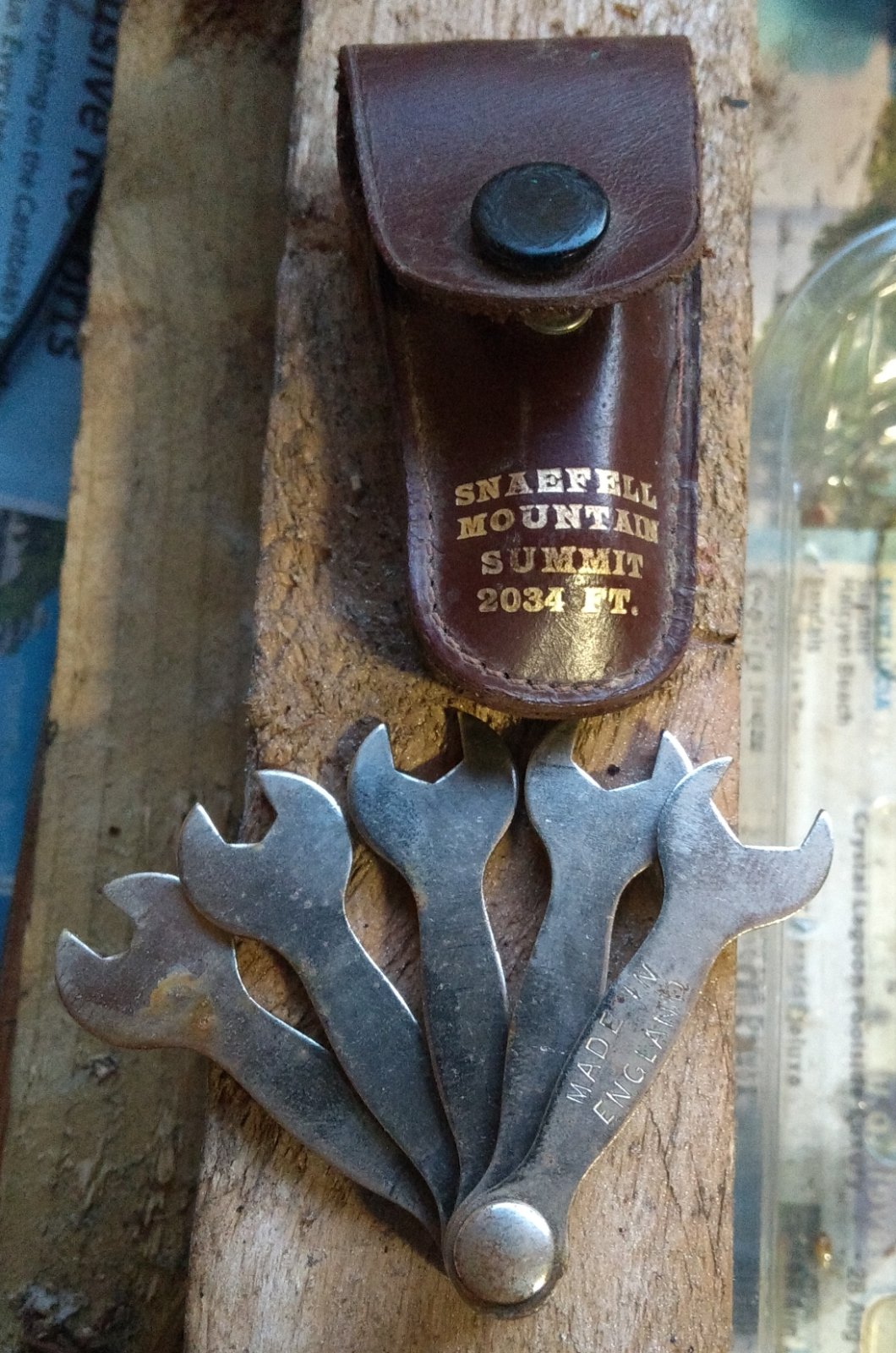

I didn't know where it was, but turns out it's on the Isle of Man, now I have never been there, but I know Grandad went plenty of times to see the racing, so almost certainly they came from his house - fitting!

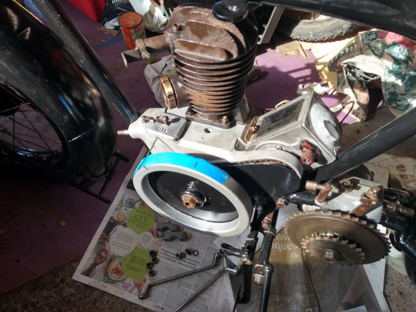

Setting the timing - no computer required here, the essential tools are masking tape, a bit of old wire, and some tissue paper (not having any fag papers!)
Was unsure what advance to set but I found some info on the web that it should be set to 2.7" on the circumference of the flywheel. This seems to be 35 or so degrees, which sounds like a lot, but it's full advance setting, so we'll see how it goes.

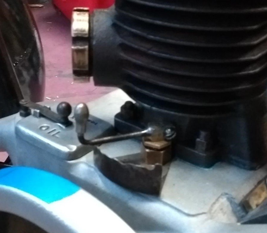

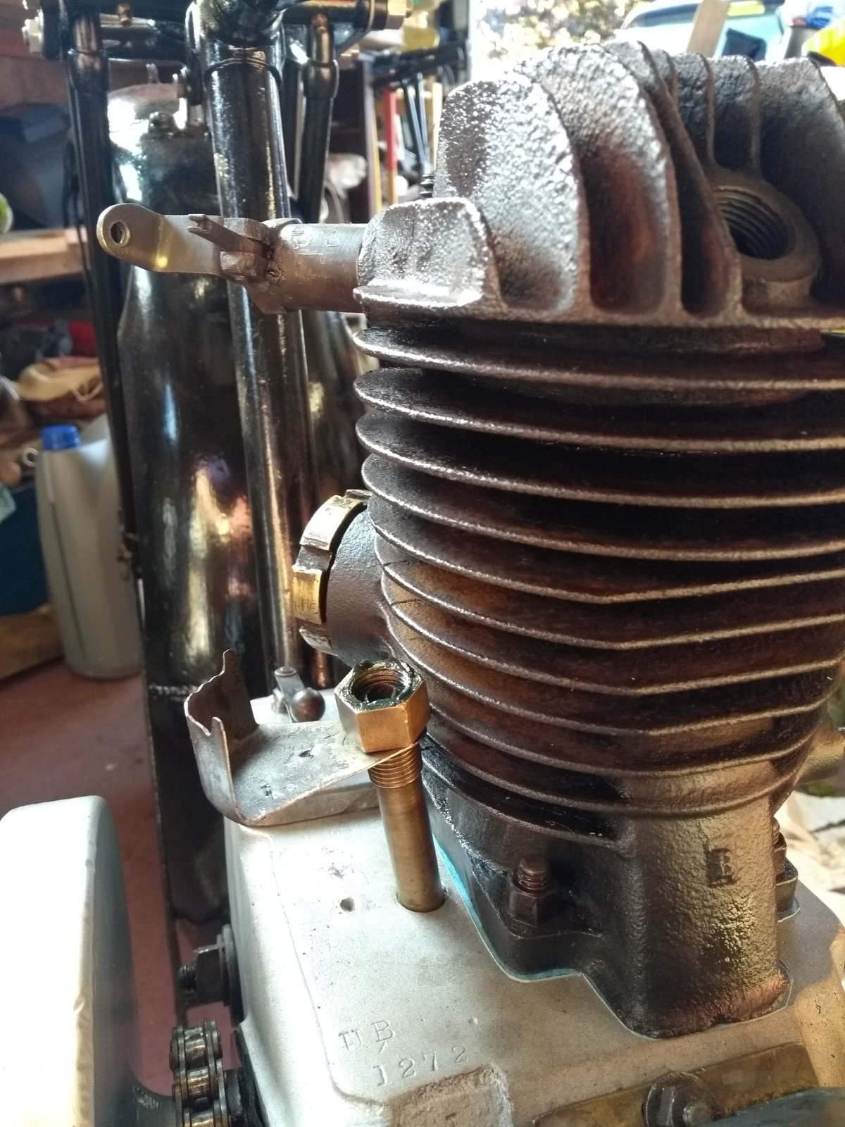

Final job was to fit the oil control
Bugger, said Dougal! Will need to lift the barrel again to get it in, but should be enough room to do it without having to disconnect the big end - which would mean taking the crankcase out again

My old geography teacher would have been appalled, I knew not that Snaefell was IOM. Thought Iceland

I had to look it up....
Just realised that the aforementioned gear change mount may prevent lifting the barrel enough to get the oil control in, so the crankcase may have to come out again - knew there was a reason I didn't bolt it up this time!!

Love the way the engine just bolts onto the chassis using U-clamps.

There's a plate mount at the rear of the engine as well, but yes, NVH suppression was not high on the list!!

Got the oil control fitted
This allows you to vary to amount of oil the engine sucks in (along the crank shaft bush, and out to the big end - all rather clever!). It says on the plate Off / Slow / Fast - which I rather suspect equates to Engine seized / plenty of smoke / Bond-esq smoke screen! I thought at first there wasn't enough room with the cylinder on, but then realised you can tilt the cylinder forward so it clears the gearchange mount, then pull it up to give enough room to drop the control in.

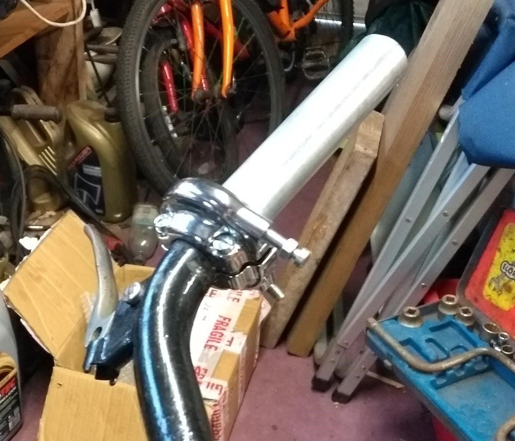

Then I was looking at the throttle, but this is not proving so easy. The brake lever is mounted on the bend on the bars, and is quite a long way from the bar, so unless you've got fingers like a gorilla, the twist grip needs to be right up next to the corner - but if you do this, then it causes the throttle to bind up. Not sure where to go with that, may just have to go back to the original internal scroll one. To get it running I guess I can just move it along the bars to the straight bit, will allow me to control the carb for the initital runs.
