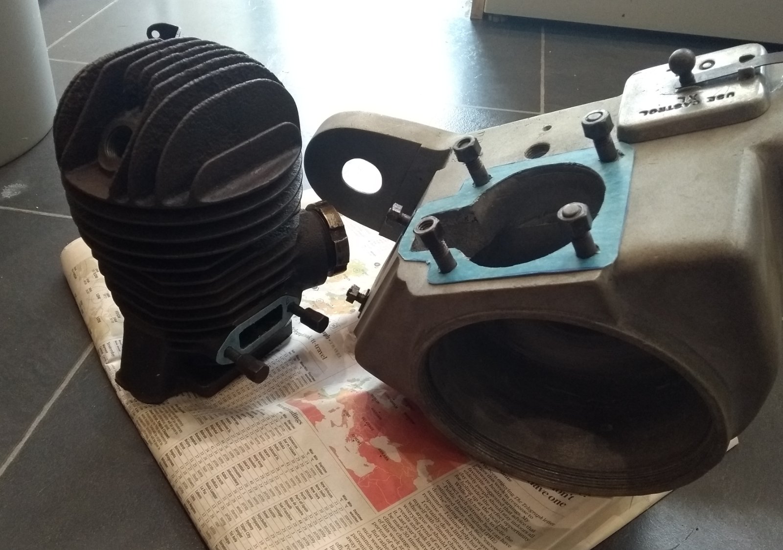

Engine assembly!
I got the circlips fitted to the gudgeon pin yesterday (just a slight injury to one thumb from slipping screwdriver!) so the piston was reconnected to the conrod. In the evening I made gaskets for the cylinder and carb
So, then I could insert the piston into the cylinder
Ready to fit to the crankcase. I had the crankcase back in the frame, but then looking at it I remembered that it was difficult to get the nuts on the mag bolts with the engine in the frame - in fact it's impossible to get on the rear bolt, so crankcase out, mag fitted and back in.
Then I dropped the cylinder on, so I could refit the rollers in the big end
Some of these are in better conditions than others....!
However, soon becomes apparent that all the rollers need to be fitted to the crankshaft before the con rod is dropped over, that's going to be difficult with the crankcase in, so out it came again.... Easy enough to fit the rollers and then the conrod once on its side on the bench
Then back in the frame - unexpectedly it needs to go in from the nearside (the cylinder is off set to the off side) as otherwise it fouls on the mount for the gearchange. On with the flywheel and mag drive chain, then I could set the timing. I eventually found my feeler gauges to set the points gap, but they're metric, so had to work out 10 thou equivalent! I was wondering how I was going to get the very small nuts undone, but whilst looking for the feelers, I found this spanner set
I didn't know where it was, but turns out it's on the Isle of Man, now I have never been there, but I know Grandad went plenty of times to see the racing, so almost certainly they came from his house - fitting!
Setting the timing - no computer required here, the essential tools are masking tape, a bit of old wire, and some tissue paper (not having any fag papers!)
Was unsure what advance to set but I found some info on the web that it should be set to 2.7" on the circumference of the flywheel. This seems to be 35 or so degrees, which sounds like a lot, but it's full advance setting, so we'll see how it goes.
Final job was to fit the oil control
Bugger, said Dougal! Will need to lift the barrel again to get it in, but should be enough room to do it without having to disconnect the big end - which would mean taking the crankcase out again

Gearbox filled, oil tank filled, kick starter fitted, plug lead fitted, pushed outside, carb bowl filled and...
Most anticlimatic video ever...
headless man tries and fails to start vintage motorbike!
It's sparking, the timing looks to be where it is supposed to be, and we've got compression, so it it's something to do with the carb, too much or not enough fuel? Don't know. Will try some easy start.
The bolt in the crankcase is not oil tight, and the carb is leaking all over the shop, although I am not sure where from yet.
